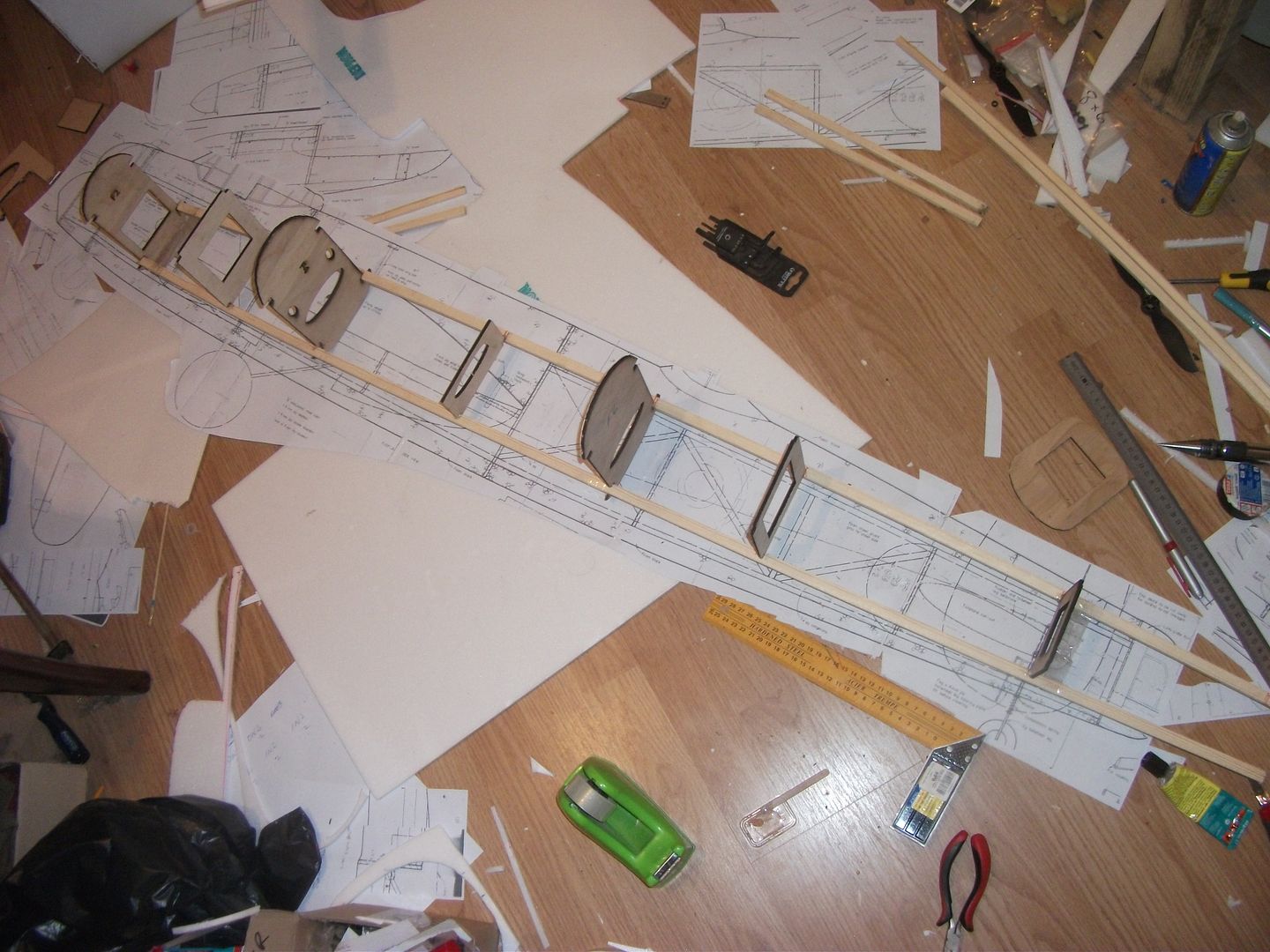

Now started putting her together ....
6 x 10mm pine longerons along bottom ... 4mm ply formers ....
The bottom longeron is full length ... so that provides my first key former construction.
Once glue is set - I shall add the top longerons which then start to pull the fuselage into shape, final is when the depron sides are fitted ... I will need to force the bend in the bottom longerons.

So she's moving along slowly, but I think in terms of sq.ins of model when compare to my usual scratchbuilds .... fast !!
The 6mm basic depron sides joined at two places to create the one piece per side are now slotted inbetween the longerons ...
My concern at moment is the pine longerons are really stiff - I'm not going to have a weak structure especially across that wing section. This means that the planned slight curve UP of the lower fuselage line may not be as much as necessary. This of course will affect the incidence of the tailplane in relation to the main wing. It will only be a small amount - but I will have to build a jig to match the wing and tailplane .... altering tailplane of course to suit.
I think I could have reduced the size of longerons ... she's very stiff now but at least I'll know she's strong !

Data so far :
The Fuselage in 1/2 finished state weighs 516gr at present ... so its working out better than I expected.
I reckon by time its finished ready for radio / batterys etc. - it will be about 800gr.
4 x 3S packs ... 155gr each .. 620gr + wiring of about 10 gr ... so 630gr ...
Radio gear ...
Rx : 10gr
4 ESC's of 50A of 15gr : 60gr
2 rudder servos of 9gr : 18gr
2 elevator servos of 24gr : 48gr
tail wheel assembly about 20gr : 20gr
2 aileron servos of 24gr : 48gr
2 flap servos of 12gr : 24gr
2 retracts and wheels ~ 50gr : 100gr
4 Motor / Props at ~ 70gr : 280gr
So total fuselage RTG without wing ...
800+630+10+60+18+48+20+48+24+100+280 = 2038gr ..... leaving me with approx. 3400gr to play with for the wing .... note above weights already include motors / ESC's / retracts ...
90" wing should come in well under such figure ... in fact I reckon more like half that if I play it right.
So potentially I am looking at a model of about 3.5 to 4.0kgs if I get it right ...
