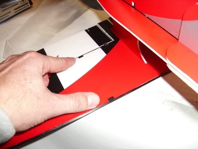

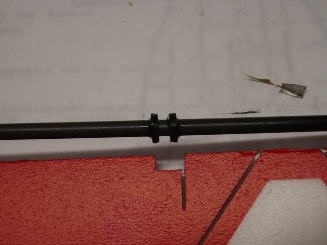

The first thing to to assemble the elevator. These flatout kits are a different breed. I like the tried and true method of tape, but I'll follow the directions. They use carbon rods and hinges that snap onto them
So basically just line everything up and glue. Its the same for all moving surfaces.

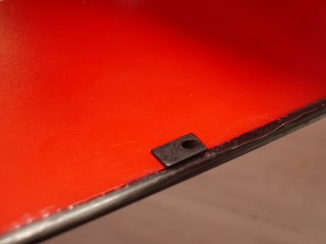

They also have these retainer clips that keep the moving surface from straying side to side

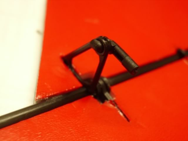

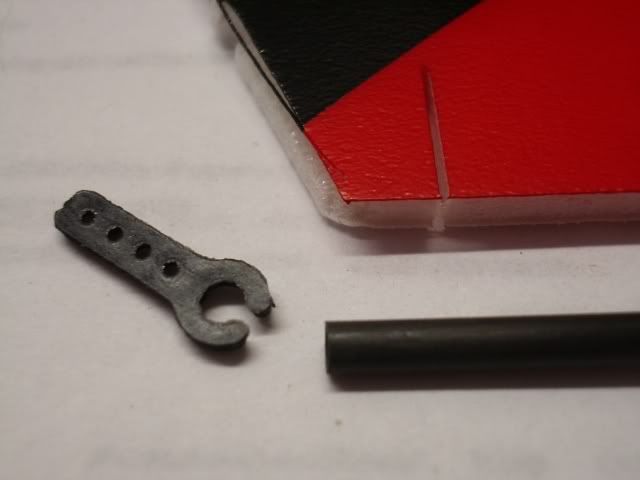

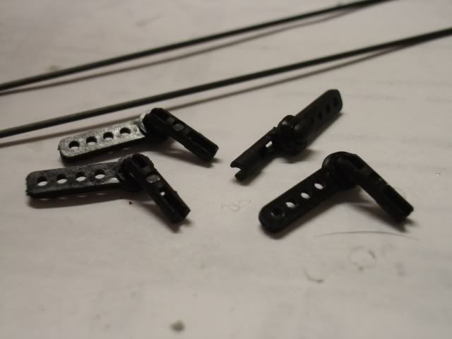

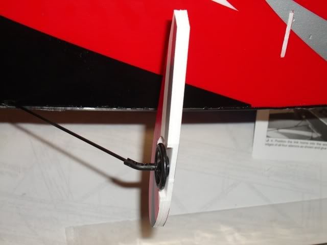

Here is your typical control horn

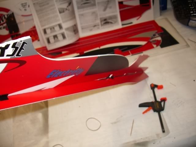

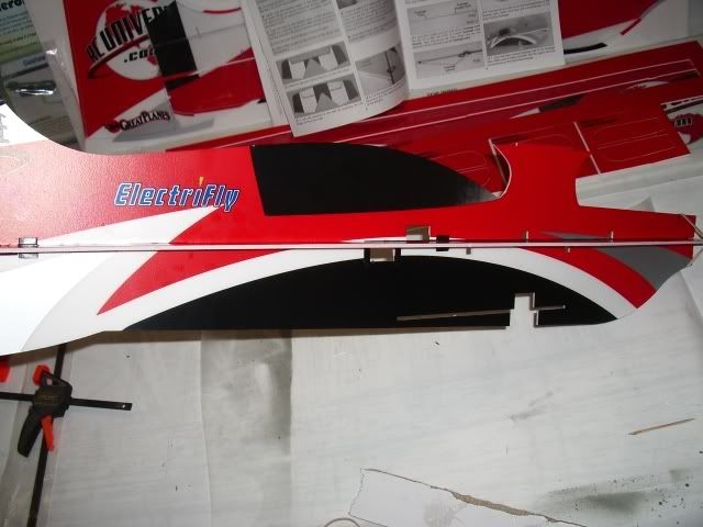

After all that, start on the fuse. They have a carbon rod that runs lengthwise and holds in the servo trays for the rudder and elevator.
Then glue the fuse sides on 90 degrees to the top and level.
Then add the bottom, thats all there is to the fuse (for now)

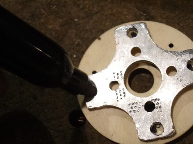

Making the engine work.....
They want you to use a Rimfire motor. I like to use what ever motor I want, thats why I always have to modify everything it seems.
here goes -

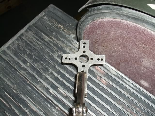

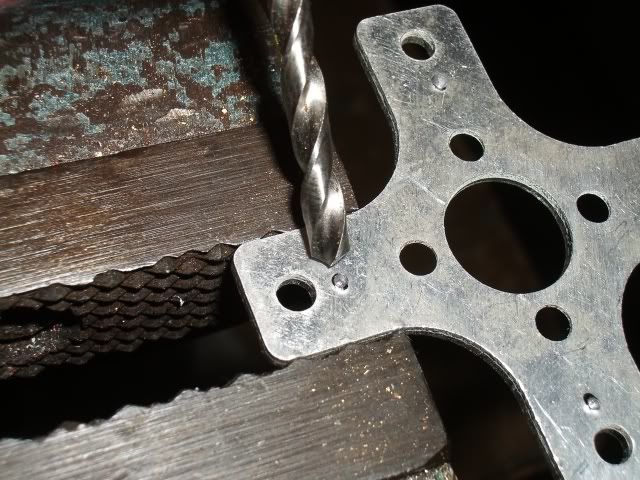

this is my motor just sitting on the radial mount they supply, my mount is too big so I need to make it fit
Gotta start by drilling out some new holes. Center punch them so the drill bit wont drift.
Then just grind off the excess.

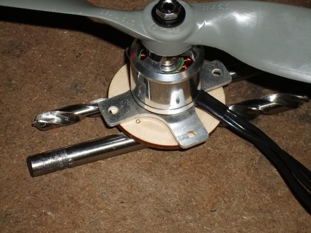

Then mark the new holes on the radial mount
aviatordave is offline

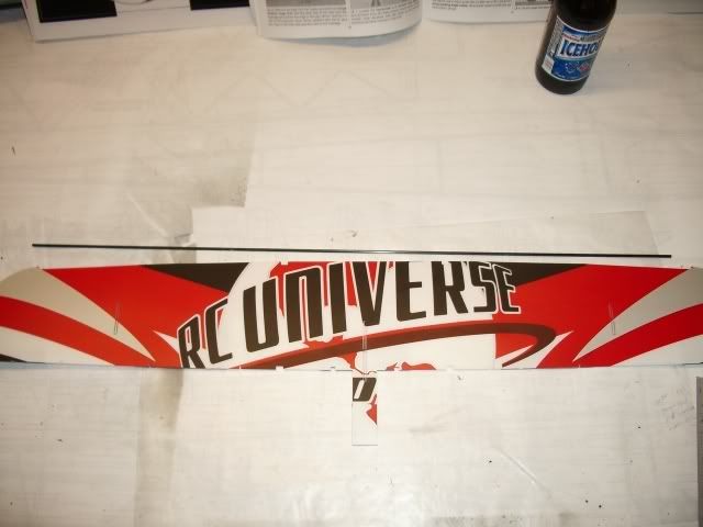

The leading edges get a carbon tube attached for extra strength.
(beer is optional )
Then just slide the wing into the fuse and glue. Add the struts also

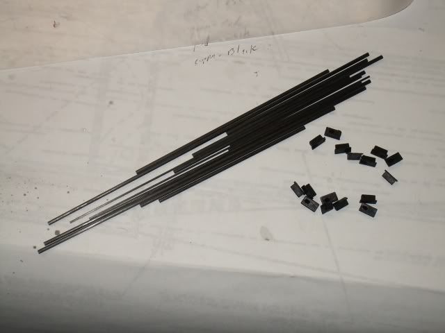

Here is the supply of carbon tubes that comes with the kit...

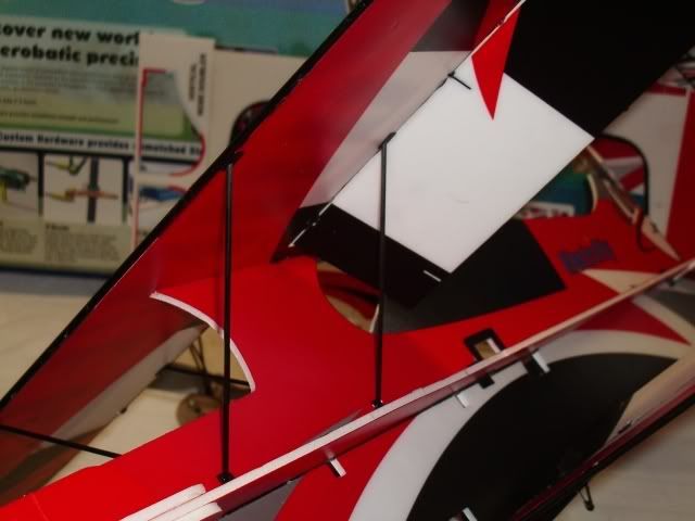

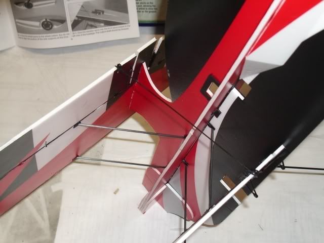

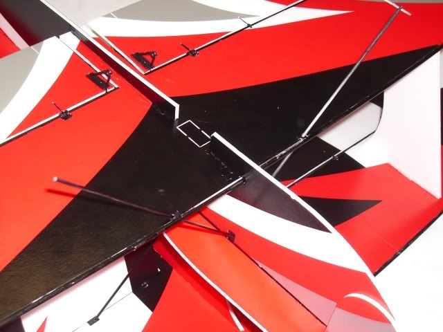

We start adding the carbon struts, lots of pieces...
This is one of the supports that gets mounted into the wing. Each wing has 2 on each side.
Here I point to the locations in the wing that gets the supports
This shows the carbon struts connecting the fuse to the wing.

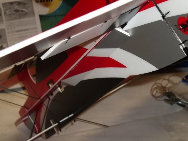

These struts are for the landing gear that come out the bottom wing -
And here are the plastic wheels they give you-
Then add the foam wheelpants to the wheels -
To keep the body from flexing, these foam supports get glued in along the fuse

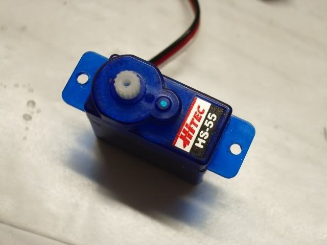

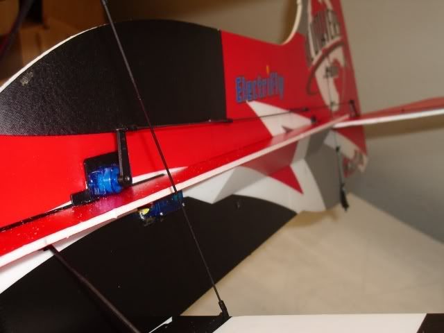

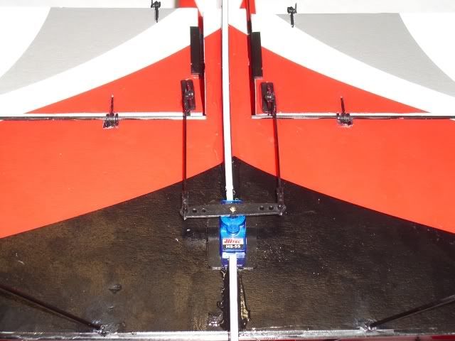

I had to use this servo. I was going to use some Towerpro servos, but the kit provides you with these huge servo arms and they provide a variety to fit most servos. Hitec HS-55 was one of them and I had 3 sitting on the shelf. I'm sure Futaba, JR, Hitec, Airtronics would work, but you can call and find out to be sure
Aileron linkage harware provided, as shown -
And installed. Make sure your ailerons are inline with the wing, after you glue there is no adjustment.
Here is the servo with the big arm they provide you -

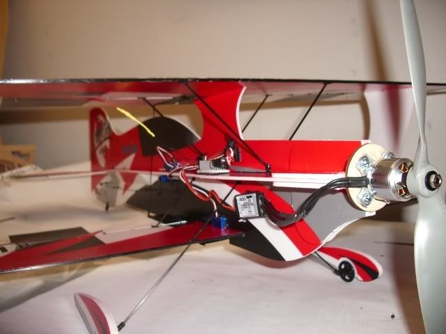

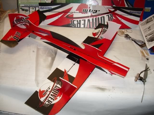

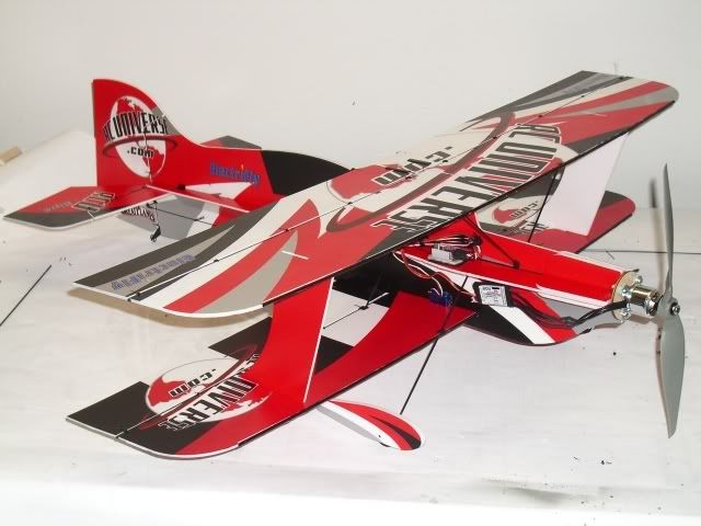

Next come the elevator and rudder servos. They fit snug into the servo tray and require some control rod supports along the fuse to prevent flexing.
A quick look at the guts...all hanging on the side
And here it is all ready for the first flight

I actually flew this last Sunday indoors
First flight proved I had the CG too far back, as soon as the plane lifted off it went into the most beautiful hover with almost no control input from me. Some of the guys said that was pretty gutsy doing that so early in the maiden...but it wasnt my choice. I nursed it back down to the ground and moved the 3 cell 800 mah lipo forward about an inch. It flew better but the controls were awfully touchy, even on low rates. So after dialing in some expo on the elevator and ailerons, flies nice.
The only thing I need to do is make some flying wires to help support the landing gear. It is too flimsy IMHO. I may add some real wheels also since I will fly this outside on nice days.
