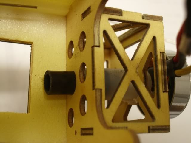

Installing the motor.
Well......first modification. I kind of knew this was going to be needed. The black carbon tube is made especially for the eflite 250 outrunner. That motor was a bit pricey so I got a little stronger motor from Heads up. I'll walk you thru the fit -
Here is a picture of the carbon tube and the rear of the outrunner I will be using, they are the same size. The tube is supposed to fit over the shaft.
Here is the new piece that I made, its just nylon stock I found at work and drilled out to fit the shaft.
Here is an idea of what the black tube does to hold the eflite 250 outrunner in place (if you so determine you need that motor)
Here is a big picture of the pieces:

Hey Dave, do you think the heat disipating from the motor will be a problem for that plastic tube you made? I really have no idea how hot they get.
Glad you are blazing the way, because I am going to have the exact same problem when I am putting mine together next weekend!

Hi That was my thought too, as the motor might spin in the nylon motor mount, and damage the wires, hope not, the build is looking great, take care, Chellie
That is the same basic system that eflite uses for the recommended 250 outrunner. They said to use RTV to secure the shaft to the tube. It feels very strong & a tight fit. The plane only weighs 8 oz and the motor pushes 12 oz of thrust (a bit overpowered, no biggie )
So....all in all its really a small plane with a small motor. RTV can withstand temps that internal combustion engines produce & make a strong bond, so I assume it should hold.
(right?)
