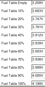

Batteryvoltage is a poor inidicator for battery charge state. The discharge curve is too flat for that. Measuring voltage (batterychecker) will tell you if battery is full or almost empty. Anything between is a wild guess.
Its not usual to have different opinion to you Ron ... but sorry I do not agree with that statement. For very good reason :
1. There is no other practical easy way to measure battery state without doing discharge / charge cycle to measure the mA in / out etc.
2. Millions of RC LiPo users around the world use voltage as a reasonable indicator of battery state.
3. Battery manufacturers and such as Battery University - so often quoted by many use voltage as a quick indicator.
4. Battery charge table accepted and used :
If using voltage was so bad - then why do they bother to program it into .... Wattmeter ... Cell Checker .... all Programmable LiPo Chargers ..... LVC on ESC's ..... Low Voltage Telemetry alarms .... the list just goes on ...
There is no other practical way to check charge state of LiPo quickly and with sufficiently reasonable result. Even to setting Storage levels - which chargers use ...
