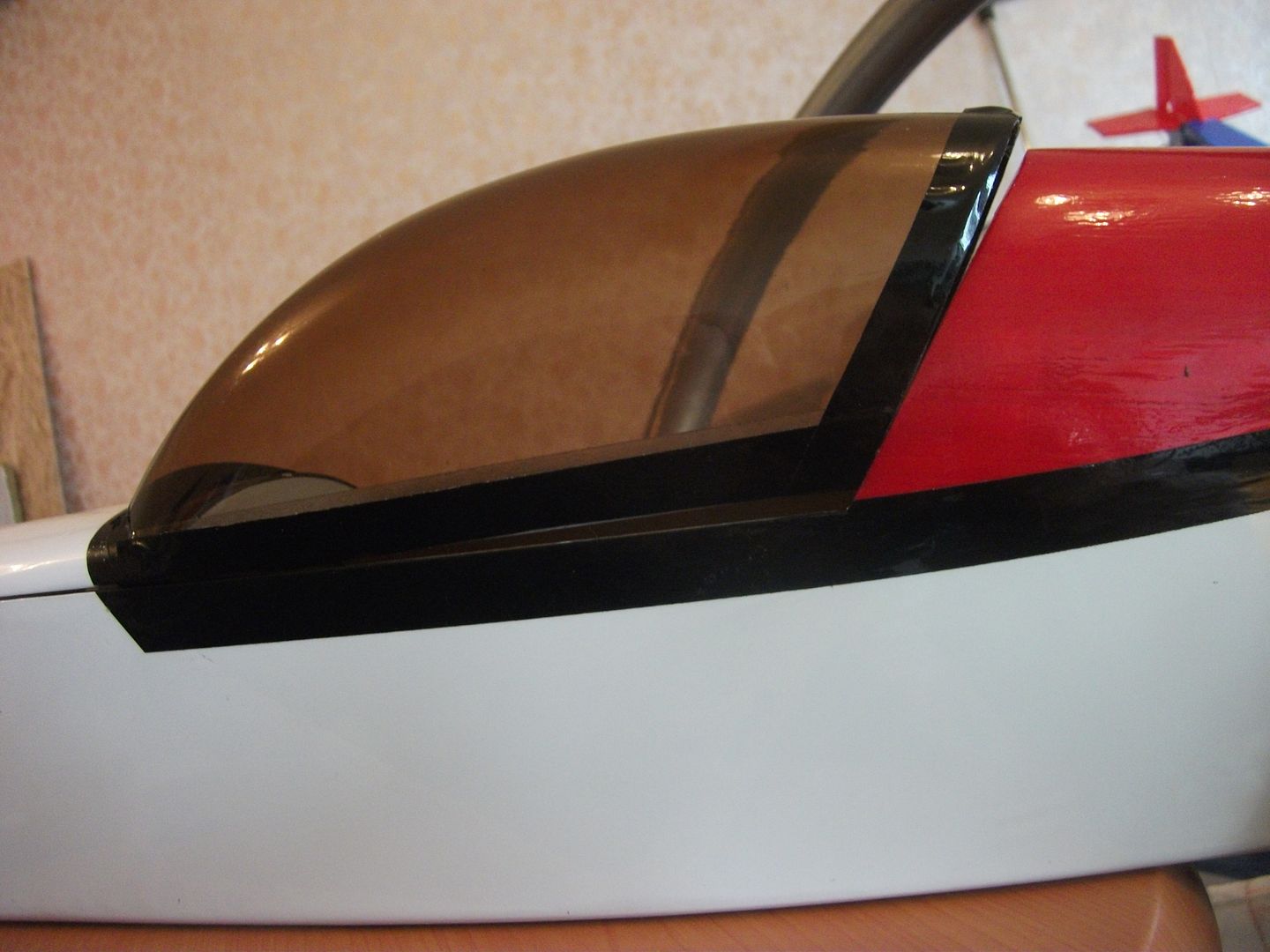

Canopy ... the base unit - OK ... but trying to get the canopy to mate with base AND stay to fit ? And what do they give to fit the canopy to base ? A crap strip of vinyl tape. I used double side thin tape in the end and MY OWN strip tape as theirs was rubbish.
How to hold it down ? Magnets are no good - as it doesn't fit well enough. Canopy catch ? No that fouls the CF strip in fuselage top unless I align it slightly offset.
Now I really do not understand how they can take trouble to create marks and slots for hinges but not above U/C ?

The canopy has no front bulkhead to reference to - that's its problem ... it just sits DOWN onto the curved front decking. The only bulkhead is the rear one.

The canopy issue ... I think I will end up adding a run of depron at the rear to close up the gap.

So I fitted a canopy catch ... couple degrees offset to miss the CF rod in the top. Balsa block hardened with CA as the 'hole' for pin.
