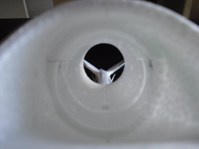

Tapered exhaust outlet:

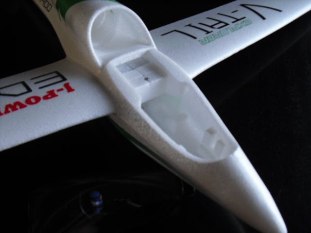

Magnetic electronics hatch:
Large lipo compartment:
Magnetic canopy with pilot figure:
Yes, that's a big lipo for a 50mm fan!
