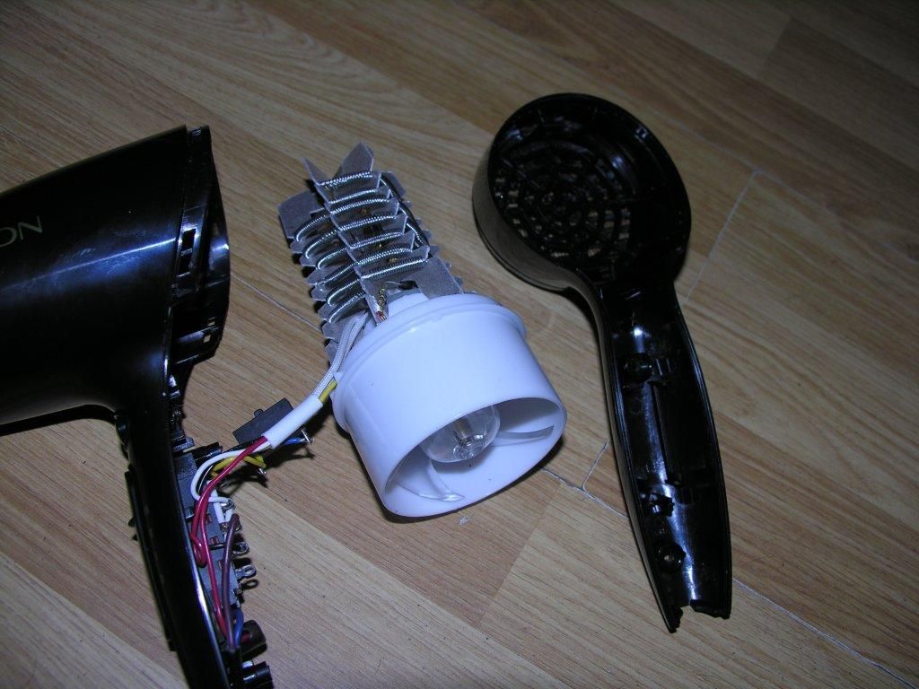

Here is the hairdryer fresh out of it's box and about to get ripped apart:
This is what's inside:

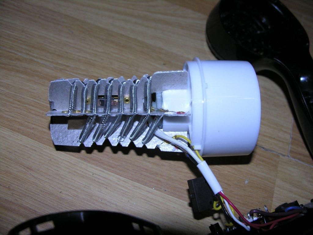

This is the business end of the dryer, the heating element and the fan:
First all the wiring needs to be trimmed away as none of it is needed:
It's critical that the resistance of the unit as about 1 Ohm, this is to make the most of the 40v and 40A rating of the chargers discharge circuit. Too low resistance means the amps will be high but the voltage would stay low. Too high a resistance and the situation is reversed.
To get the correct resistance I took a couple of lengths of 14AWG wire and stripped back the insulation from 6" or so. The bare wire is then braided along the length of the heating element frame, wrapping around each of the resistor wires. Soldering is out of the question as the heat would melt solder.
It's not especially neat but will do the job:
On the opposite side of the frame the opposing wire is braided in the same way, looking end on the wires are in the 12 and 6 o'clock positions. I was in luck and the resistance came out spot on 1 Ohm. Other models of hairdryer would need most likely treating differently to get the correct resistance, the design of this one turns out to be ideal for the job.

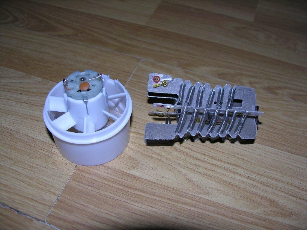

To power the fan the voltage has to be reduced down otherwise with a 40 v input the motor would burn out. To do this i tapped the motor positive wire into the resistor wire element one third was between the positive and negative wires. This seemed to give a fan speed that sounded 'about right'. It's easy to adjust speed by altering the position that the motor wire connects to the coil.

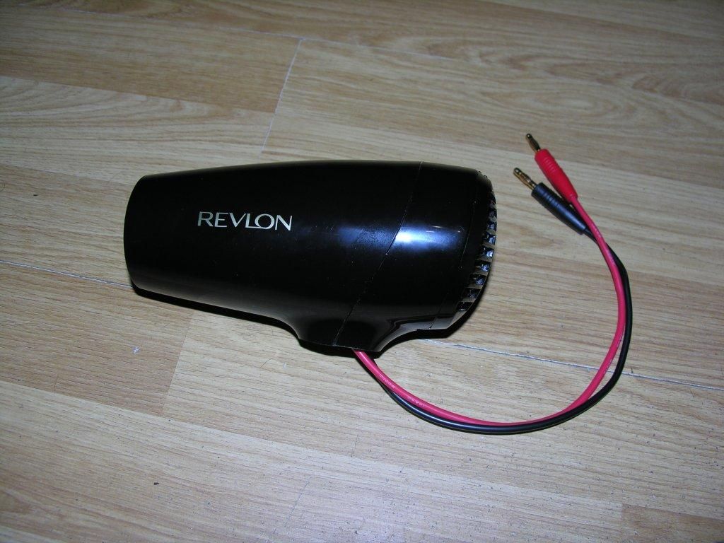

This is what it looks like all back together, handle was cut off as it's no longer needed.
I tested it out on my iCharger and it works great. Discharge power is actually limited not by the hairdryer but by the 40A limit on the battery side. It easily discharged a 6s battery at 40 Amps, this was about 1000W load on the hairdryer, which it coped with no problem at all.
So the experiment is a complete success, i don't think any other discharger design comes anywhere close for sheer brute power. It is quite noisy of course but at least the noise doesn't last long. The only thing that would improve the discharger is some sort of stand rather than just laying it on it's side, but that's just aesthetics.
