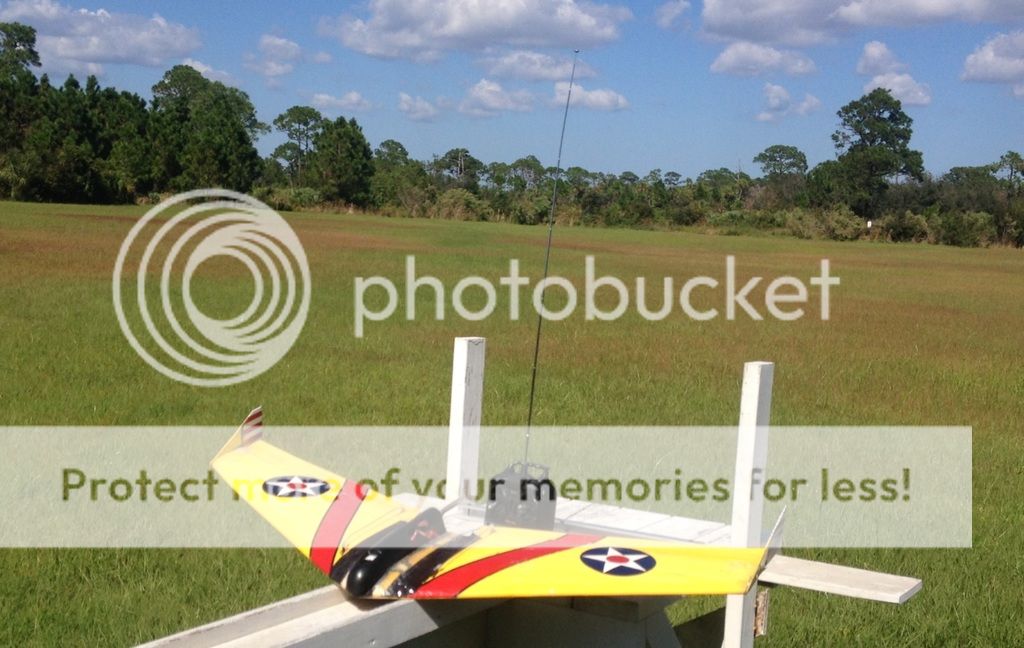

#113
Guys,
After perhaps almost 2 years of not flying it, my beloved ZAGI wing came with me after working on it for about 3 hours early this morning with a couple modifications and improvements.
The Yellow Wing with the NAVY Markings is the ZAGI wing.
The RED one is the heavier COMBAT Wing.
Combat XE-2 that is especially made for Li-POLY use (EPP Foam pre-cut for CG purposes) and the Zagi wing that comes with the plastic Fuse housing and you can slide things a bit. The Combat Wing (XE-2) is powered by a MEGA 16/15/-4-turn swinging the APC "E" 6X4 and at wide open it draws at 21.3 AMPs (when you place a brand "new" Thunder Power Pro-Lite 2100, 3-cell) and measured Propeller RPMs at 17,3000
The Zagi was converted over to Brushless in 2008 and it is both EPP and injected foam and is NOT made for COMBAT so, I placed a more dosile power system, the Himax HC2825-2300 inrunner with the exact same propeller! This power system draws a maximum of 17 AMPs at wide open with 15,800 RPMs at the propeller However, because it is 7oz. lighter than the Combat Wing it is pretty fast as well.
A few pictures!
