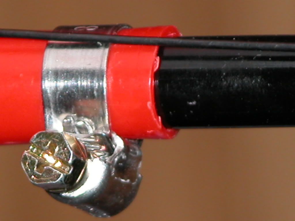

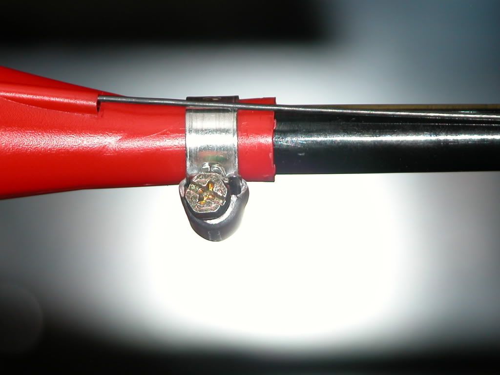

Default Two for One
I have been reading this forum with keen interest as I am learning to fly with one of these planes. I too had the same problem with the control rods being too short. However, after I had an inevitable crash, I hit upon this solution. The two screws securing the boom seemed to me way too flimsy, and after the crash one was toast, so I removed the screws and replaced with a 9.5-12mm clamp from our local harware store. Not only does it hold the boom better, thus avoiding twisting, it also means you can move the boom further in, to fix the control rod length problem. Have tested it and it flys fine.

Originally Posted by Ianh View Post
... I removed the screws and replaced with a 9.5-12mm clamp from our local harware store. Not only does it hold the boom better, thus avoiding twisting, it also means you can move the boom further in, to fix the control rod length problem. Have tested it and it flys fine ...
Very nice solution, Ianh (and superb photos). I applied a much more primitive solution and simply Gorilla Glued the boom in.
John V

Ianh
You must have a half decent camera to take pics like that - very nice!
My only concern is the weight (I am fanatical about it) and the rather crude look but I am sure it does the job very well.
Is your Wing Dragon "standard" or "improved"? How about a pic?
I have just got in from flying mine with the 70% area flapped wing and the latest lightweight "mid set" tailplane.
As it has no control rods I don't mind if the boom moves a bit, in fact I twist it to make sure the tailplane and wing are lined up correctly.
At 16oz all up its performance, both power on and power off, is spectacular.

Default Wing Dragon
Well ok its a standard Wing Dragon 3 but it has a 2.4GHz radio and a BM2408-21 Brushless outrunner. Its the one from Banana Hobby, yes I know I've seen all the threads about them, but tbh I had little to no problem with them, it also came with the floats for landing on water (not tried this yet), the only difference to what was in the ad was they shipped a 7 cell 8.4v 1000mAh NIMH battery and not the stated 7.4V 1300mAh Li-Po. Anyway weight wise the clamp was 10g and the pilot they include is 14g which i dont use, so it sorta wins, and i dont really think it looks crude but hey, it works

[QUOTE=Ianh;702500]I have been reading this forum with keen interest as I am learning to fly with one of these planes. I too had the same problem with the control rods being too short. However, after I had an inevitable crash, I hit upon this solution. The two screws securing the boom seemed to me way too flimsy, and after the crash one was toast, so I removed the screws and replaced with a 9.5-12mm clamp from our local harware store. Not only does it hold the boom better, thus avoiding twisting, it also means you can move the boom further in, to fix the control rod length problem. Have tested it and it flys fine.
Terrific idea.... I also had the same situation with control rod lengths...
