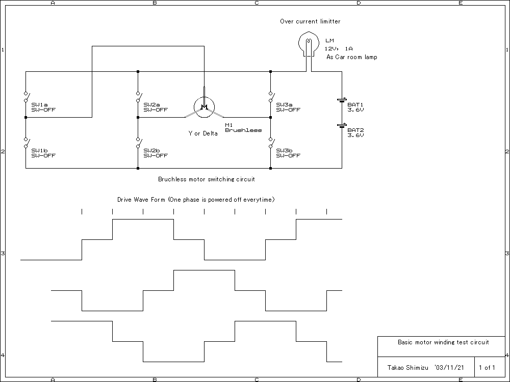

Dave, I still find it amazing that APD controllers can drive 2-magnetpole motors up to 1.0megaRPM.
O.t.o.h. ESC is a simple thing, a very fast commutator. Not mechanical as in a brushed motor, but electronical.
I've always found these drawings useful when explaining the workings of a brushless controller.

Another useful drawing.
H = high side switches/powerFETs, connected to plus-rail.
L = low side switches/powerFETs, of different type, connected to ground-rail.
The motor has its three phases connected in star.
The diodes are snubber diodes, not needed for explanation of operation.

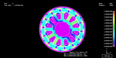

Three magnetic flux simulations.
12magnetpole outrunner.
The magnetic field rotaties 6 times faster than bell&shaft.
14-magnetpole outrunner.
The magnetic field rotates 7 times faster than the bell&shaft.
