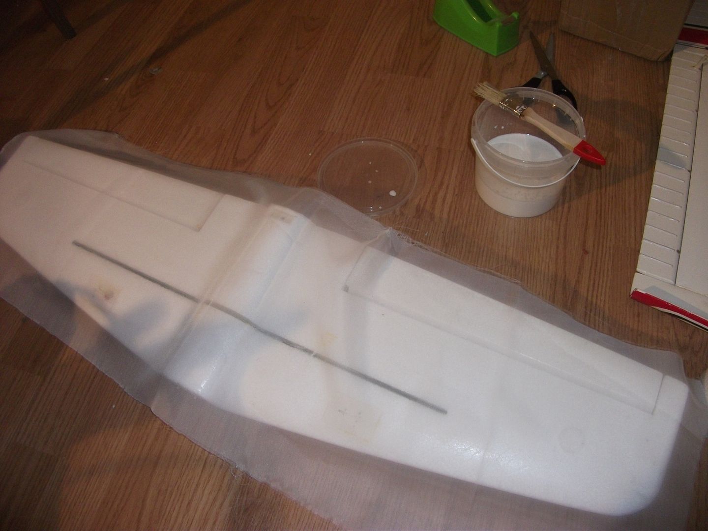

I do have some concerns about the weight of your wing after you added the papier mashe.
I have a couple of reinforced foam RC plane wings that are actually bigger than yours but weigh quite a bit less.
Did you cover the whole wing with the same thickness papier mashe? If so then getting on for half of what you put on has simply added weight yet provides little extra strength or stiffness.
The trick is to add the stronger, heavier material only where is will have the greatest effect. For any plane what you are after is the best strength to weight ratio rather than just the strongest possible structure.
At this stage it is probably not worth taking off what you have done but there is always the next wing.
Keep on going!

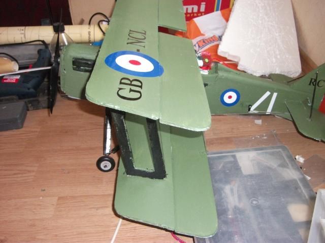

May I suggest you try and find a Builders Shop in Chennai or near ... a better Foam for building is the thinner Floor Insulation sheet ... its stiffer than the packing case foam you have used. You can actually work with it similar to balsa sheet.
The floor foam is based on Depron or Extruded Foam ... giving tiny beads that do not crumble like packing foam.
Bought in packs of 10 sheets and about 1.2m long ... 60cms wide ... 5.5mm thick ... you may be able to find up to 9mm thickness which I would prefer !! The price for a pack which would build quite a few models is about the same as just for a couple sheets of real Depron ...

Reminds me - I must get some more packs of floor insulation ... being stiffer than Depron - it is ideal to stiffen a structure....
My SE5 is built of it ....

Here's is what I am going to do to the wings:-
I am going to rip off the paper mache from the wings except the leading edge and the centre portion and I will glue some spars, see if that works.
I will post pics.

But I also notice that they do not have ailerons servos. My wings weighed 220 grams including two servos(9grams each)and paper mache , and without paper-mache, it weighed 148 grams(with 2 servos) and wingspan is 1270mm.
You are correct about paper-mache, about increasing the weight. So I am going to rip it off from the wings and going to glue spars to it and see if it works. will post pics. Thank you

If you want to 'case' wing ... then forget paper - it carries too much weight in glues etc.
I have an Aerobatics foamie that originally I covered with film ... but I started to hate its look.
So I decided to peel of the film and cover in micro light nylon window net. The stuff that wives hang across windows to stop prying eye's in. I used 50-50 mix of PVA with water to fix. I did not fully fill the weave but enough to fix the net and provide a good paint base.
I used spray cans of lacquer paint to colour it as final. Overall weight was LESS than the film by a few grams. But the strength factor was large. The skin it formed has resisted all my bad flights and still looks as good ..

Originally Posted by aaindthu View Post
For the landing gears, I took bicycle spoke wire and bent it and glued it to a large piece of cardboard with epoxy. After it got cured, I applied some wood glue to the other side of the cardboard and simply pasted it under the fuselage.
Attachment 186939Attachment 186940
I have cut out the lower portion of the motor "cowling" exposing the lower part of the motor to the airflow for cooling purposes as pointed out by Panther.
And I painted it. Now the flying weight/AUW of the plane is 750 grams (1.65 lbs), 80 grams (0.176 lbs) lesser than the previous design. Watt per pound of the plane comes to 90.
And cg is at tip of the leading edge. So, I did not have to add any balast to move the cg. All looks good to me. I am going to try to fly it tomorrow
Attachment 186941
Your CG may wind up being closer to 1.75" from the tip of the leading edge. The "tip" of the leading edge might be a little too far forward. Take it out to some high grass and chunk it out there at about 45 degrees and see how it comes down. chas
