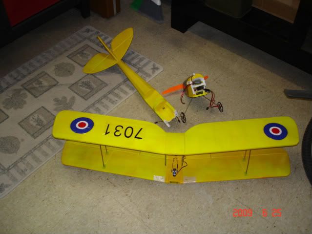

Well, I finally was able to maiden my TM400 today. SWEET!
First, some minor build notes:
Got the slope model, then painted it with testors insignia yellow and an airbrush. Brown on the props and cockpit, and semi gloss black on the cowling. I enlarged the battery bay as large as it will go to ensure room for the larger lipo. Used sumo glue, 5 min epoxy, and foam safe CA for the build.
1. Don't use the measurements on the directions for the control rod guides, as they will be too short. Make sure they extend into the battery bay.
2. Stickers won't.
Use some additional adhesive to ensure that they stick.
3. I think I found the three little plastic squares used to mount the cowling, after I had already made new ones. GWS should make them a little more apparent. I am not the only one that has had this issue.
4. It looks like the parts tree was for another model, as I had tons of extra parts that went nowhere.
5. Build itself was pretty easy and painless.
6. I had to shorten the stick for the stick mount by around 1/2" to make the motor fit into the cowling.
My mods:
1. Brushless motor - 2410-08Y 950KV stick mount outrunner (Headsup RC)
2. 1700 Mah 3S lipo
3. GWS 10x4.7 prop. (I have an APC 10x3.8 and 9x3.8 to test)
4. "Jack" 1/10 scale pilot from Hobby lobby
5. 3/4" and 2" light foam wheels from Hobby Lobby (Much more realistic yet light)
6. cockpit decal
7. small GWS spinner glued onto the prop. A little more realistic detail.
I still have to enhance the landing gear for more realism and durability.
The CG balanced perfectly without any additional weight. No, really, it did!
The maiden:
In the rush to put in the battery I snapped off Jack. Hopefully, not a bad omen, but I hoped I could maiden without a "pilot"
I puddled around the baseball diamond (AKA, my airfield) to check out the steerable tail wheel. VERY nice!.
ROG was in around 20' at 2.3 throttle. THe plane climbed very nicely and only needed a few clicks of down elevator and we were flying straight and level.
It flies faster than I thought it would, but will still slow down very well, at a little less than half throttle.
Loops are very easy, even at 2/3 throttle, but rolls are very slow. I will try and increase the throws of the ailerons if I am able. I am sure this is pretty much as the original plane flies, but be sure and give it some throttle and have some height.
After about 2 minutes of flight, the large numeric decal flew off the plane and was lost. **Note to myself, don't forget about the extra adhesive you were going to add to the decals.
About 5 kids showed up and were watching, so I did some more aerobatics; immelmans, loops, rolls, etc. After one roll, I saw something else fall off the plane. **Second note to self - remember to glue on the wheel keepers next time!
The kids found the wheel in the park's grass, while I continued to fly some more. I knew that landing was going to be an issue with only one wheel. I brought her in early on the grass, not the dirt of the infield. A low and slow landing, with a controlled stall just before touchdown. The only damage was the landing gear mount pulled out of the plane. I will reglue it and see about improvements for the future.
I am also going to try the APC 10x3.8 and 9x3.8 props to see how the flying characteristics are affected. The 9x3.8 would lengthen the flight times significantly, I believe.
All in all, this is a very smooth flying plane. It is very relaxing, and looks beautiful in the air. Would I consider it an aileron trainer? Probably not, and here is why: 1. Aileron rolls are very slow, and need some coordinated elevator input to keep her from dropping too low. 2. I don't think she is as sturdy as many other aileron trainers.
However, the Tiger Moth 400 is a beautiful and easy flying plane, suitable for the intermediate flyer in a smallish park.

She looks a bit ugly without the cowl, but as you'll see from the pics it's much easier loading the flight pack for me this way (I slide it in thru the front cockpit).
A 1mm ply 'tongue' with alloy right-angle at the end stops the pack from ending up in the prop!
I used some yellow acrylic artists paint thinned with water & brushed on to touch up where I sanded the foam.
