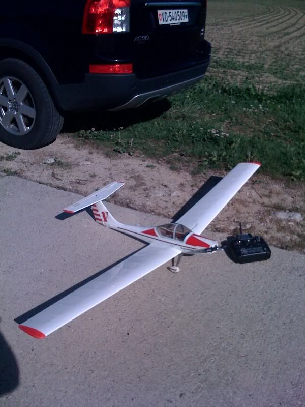

Photo below after the flight
Edit: LiPos charged. Total mAh used was 1050 from each pack. This setup will comfortably fly for an hour without breaking sweat...!

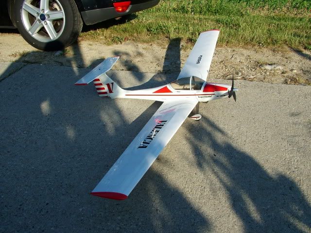

My girlfriend took some photos of my Valencia in flight today, here is a small selection. Hope you like them.

great pictures, great lake view ...

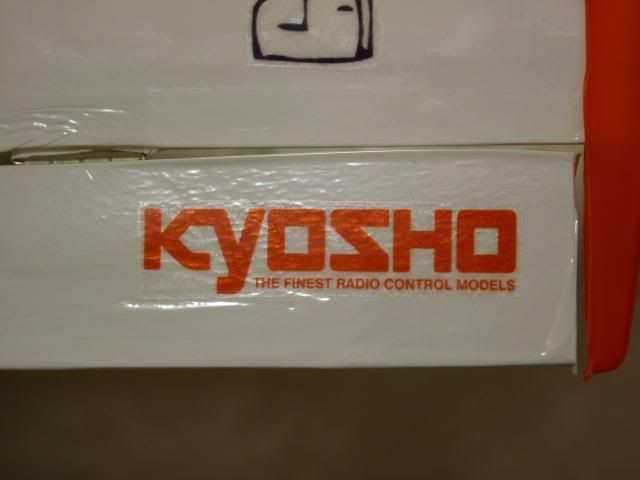

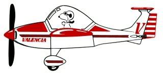

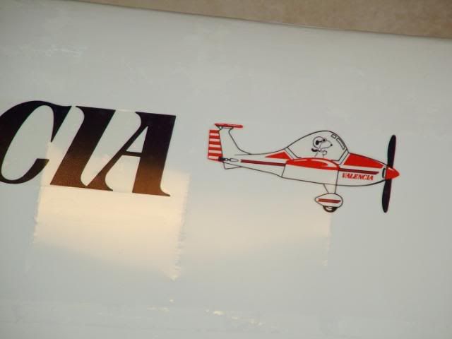

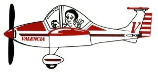

For the decals, I have scanned in a brand new decal sheet from my NIB Valencia and am in the process of completely re-drawing the main decals. I will then get them printed onto transparent vinyl to stick to the plane. I will not do the big red colour strips - instead I will use coloured vinyl to make that.
I have also taken time to make some changes to the original decals so that as well as the normal ones there are some more modern ones. For example, I have recreated the "Electric Powered by Le Mans" decal but there is also a new version that says "Electric Powered by Le Mans Brushless" It takes a long time to re-draw the decals, but the finished quality of the graphics is actually better than the original decals.

For the decals you are welcome to what I have but it is just a selection of a few decals such as the type etc. I did not scan the whole sheet as it's too big and there is no point reproducing large sections of red colour using a printing process as it's much cheaper to simply use red coloured self-adhesive vinyl and cut it to shape. Do note that I have not reworked all these decals yet. It's massively time consuming (a typical decal sheet is 20+ hours work) so the ones below are just cleaned up lo-res samples. I need to fully rework them to get the quality.
I also took the liberty of replacing the stupid guy in the plane with someone more cool

great, i'll try and print the cool guy for a nice addition to my plane.
credits will be given to you of course :d

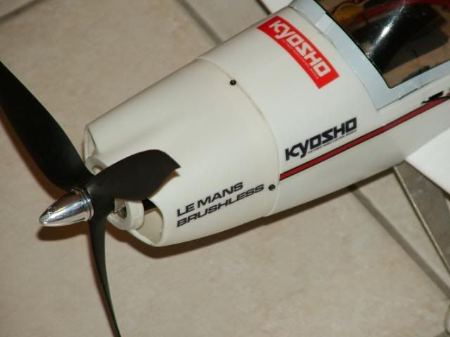

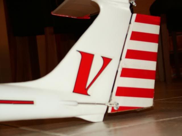

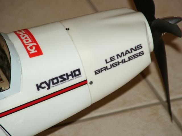

Here's my bird with the three blader:
I just had a quick flight and the 8x6 3-blade is not quite as good as the 9x6 2-blade but it's plenty good enough. It'll still climb vertically
Edited to say, the wires you see sticking out either side of the fuselage are the antennas for the 2.4GHz Rx, just in case you were wondering...
Wireless is offline

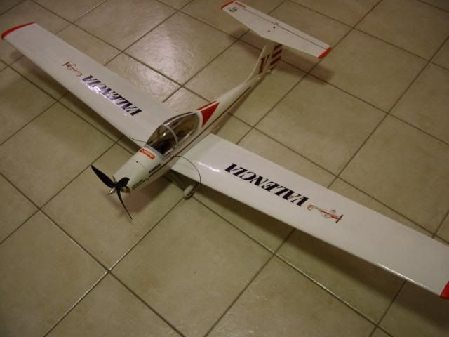

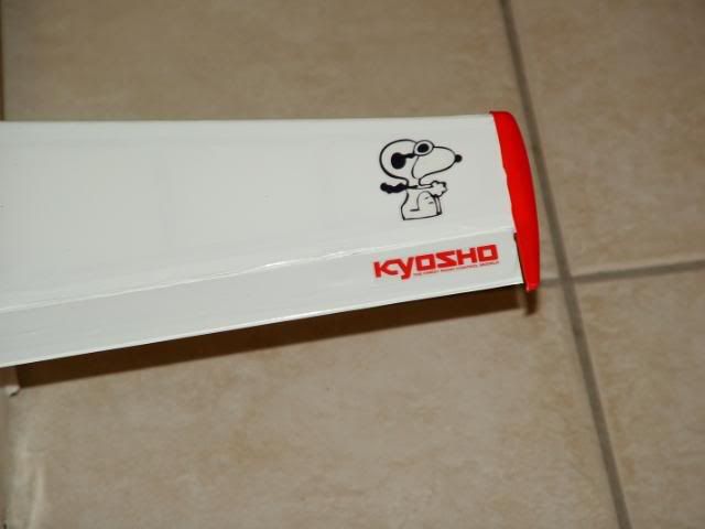

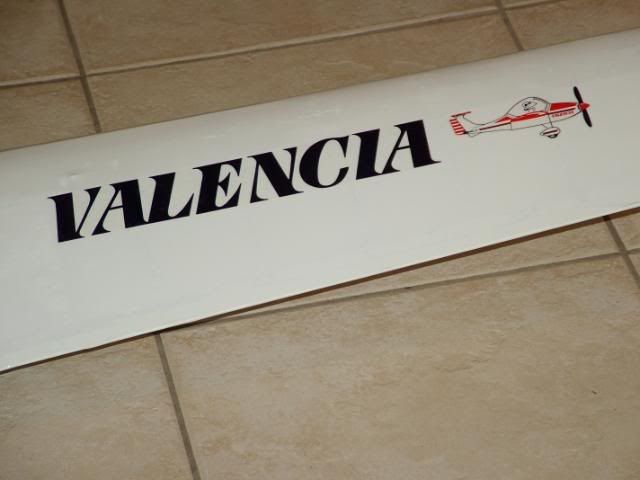

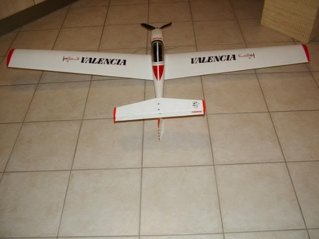

More work now completed on the Valencia. Replaced the 8x6 3-blade prop with a 9x6. Yes, more current draw but even more performance. As over 50% throttle is only ever used for maximum of 5 seconds at a time, I figured it was OK.
I have repaired my crashed wing (see above posts) and have also recovered the tailplane as it's original 1986 film was looking tired. Excitingly, I have finished my first set of custom decals. I have attached some photos so you can see how they came out. I have not replaced the solid red or the stripes. I will do this when I get some coloured vinyl.
I hope you like the results of the decals - All the decals you see bar solid red triangles behind the cockpit and the stripes down the fuselage were completely recreated from scratch. I am really pleased as the quality is superb - better by quite some way than the original Kyosho decals. I think the plane looks really nice now. For some reason the tailplane looks bent in one of the pics below but it's a trick of the camera, it's actually perfectly straight.
With it's totally new power system, new radio, new covering and new decals I think it's fair to say it's genuinely a 21st Century interpretation of a Kyosho classic...!
