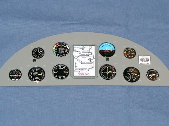

Often I find no cockpit or details with the kits ... if there is - often its some childs idea of what it should be !!
So I go online with the name of the real plane .... get a photo and then search for cockpit dashboards etc.
Here's the one for my Extra I downloaded ...
I measure the width and height of model area it will be set in ... and then adjust the picture ... print and then glue to a Depron sheet backing for fixing in place.
My Nieuport 28 that I entered and got 8th place for scale in UK years ago ... eventually ended up with scale dash, joystick and pilot ... based on a light tray fitted into fuselage.
I searched books and library (forums like this were just not around then !) for anything I could get hold of to show what I needed.
