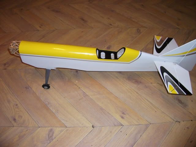

Overall out of box ?
Very well packaged and no damage that I can see so far.
Points I noted :
No hinges are fixed by factory, provided but not fixed. Big PLUS point to me - I like to fix my own ! Second no tape hinges here - these are mylar strip as I prefer.
The covering is so well done - that it's very hard to see any joins, signs of it being a super job.
The woodwork when spied inside is clean and boy is it light ! This reminds me of the 80's when Japanese Kits from Pilot came on market with super fine diecutting, Liteply and super detailing.
Folding prop ............ now this has me confused ! I've only dabbled with these on gliders ... never on aerobatic model. I always considered folders as less efficient ... so anyone explain this one for me ? I have Fixed props in the box I bought - so have both to trial.
This is one LIGHTweight machine that really looks nice.

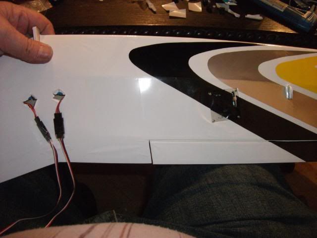

The manual starts with the bottom wing. It has separate servos for each aileron and screwed down plates to hold the servo's.

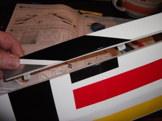

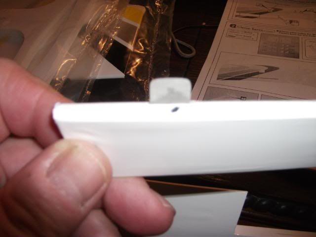

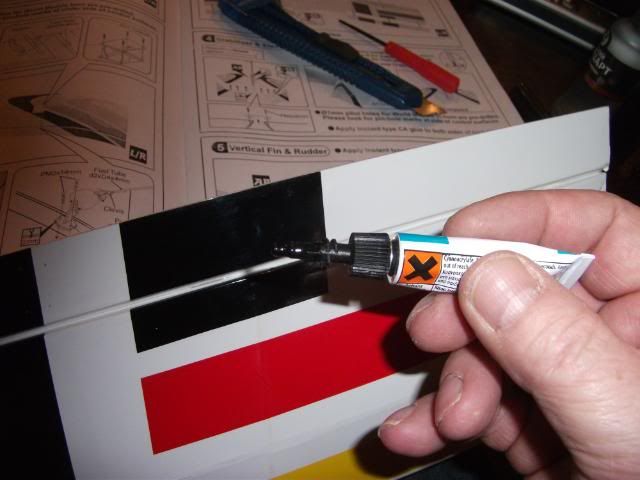

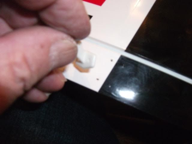

First is to complete the hingeing of the ailerons .... manual shows them in place, moved and CA dropped in to set the hinges in place. Well I tried it that way and nearly lost a couple of hinges inside wing where they weren't trapped enough. So I did it my usual way .. glue into one side and then offer up and glue other ... That way I could have the hinges halved correctly.
TIP : when you glue to one side ... get a marker pen and make a dot in line with the hinge - so you have a marker to tell you where it is when closed up in place !

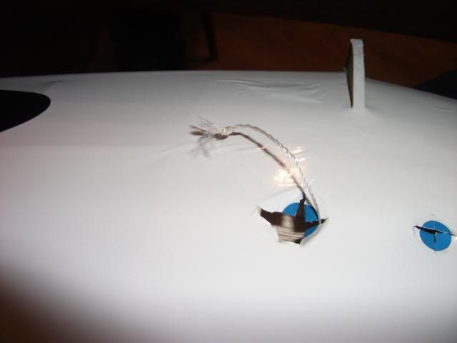

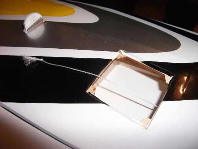

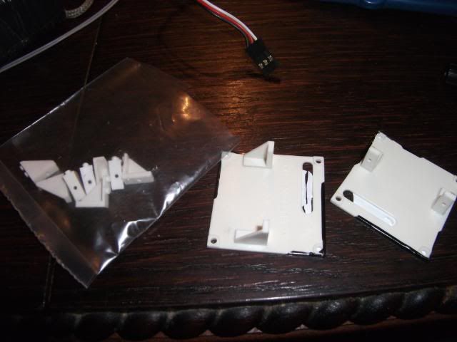

Once they are in place it's move on to the servo mounts ... TAKE CARE removing these .. they are held in place by clear tape on one corner - if you just pull it away - you can split the covering ...
First you have to choose the right size Triangle mounts and then CA these into the holes provided.
TIP : Make sure you allow for the servo grommets or other that you may use .. the slot in the plate for the arm to come through is a bit close to the servo and arm may foul top edge.

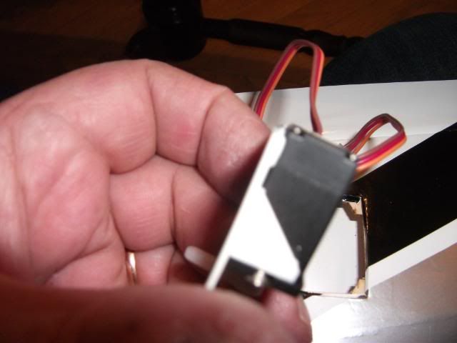

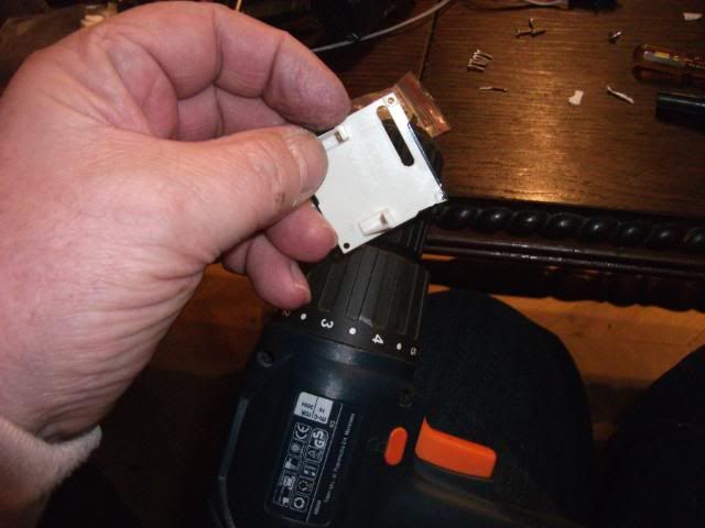

Second : Corona 929 Metal geared that I am fitting are too long and have an overhang at the back end .. this fouls the wing mount and I had to use 2 layers of servo tape to get clearance ...
The triangles to mount the servos are not in my opinion strong enough to put up with hard flying as I intend .. so I double mounted using those + servo tape to be sure.
TIP : take a 1.5mm drill and drill those triangles to take your servo screws .. even then when installing screws - the triangles came of the plate ...
Take real care when fitting the plates and their screws ... I would suggest driiling pilot holes in the small wing lugs that screws bite into ...
To get your servo leads through the wing ribs - they have provided threads that are fixed by small cards under the plates ... and after you cut at the dots in centre panel .. bit of clear tape to connect lead and thread ... carefully pull through..

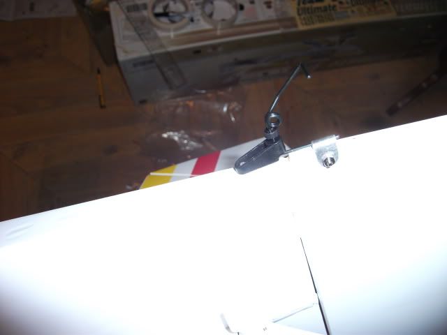

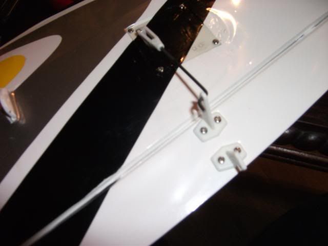

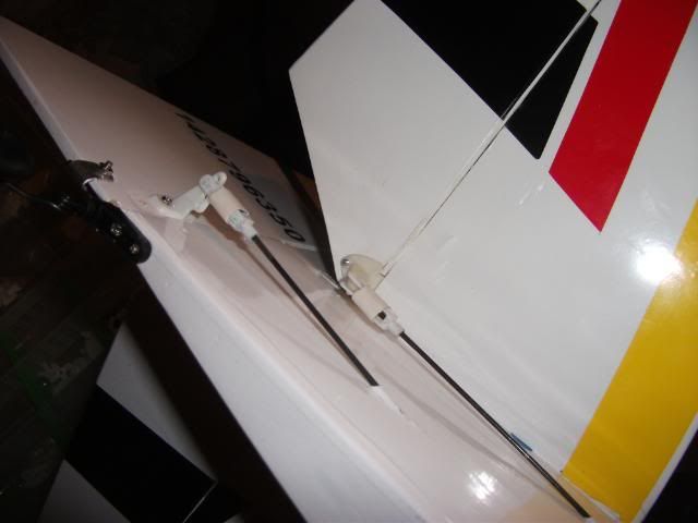

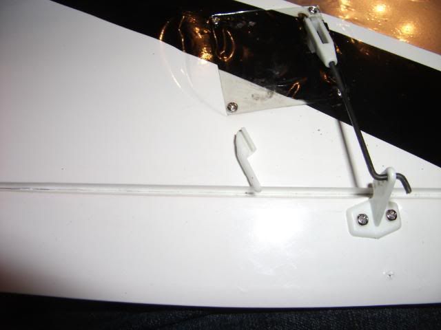

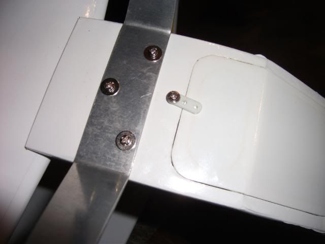

Servos mounted ... onto the horns. On first inspection of the ailerons - you can see the pin-pricks made by factory. At first they appear 90 deg's out ... but later you realise that the interlink horn for top / bottom ailerons are mounted in line with servo ..

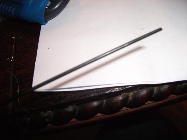

The servo rods are too long as supplied and the keepers are difficult to use. So I solved both problems in one move - I used Z bends in rod ends ... and clevis other end for adjustment.
I like that horns are more traditional with screws through to backing plates - instead of the usual chinese glued on type.
The rods are of sufficient diameter to be stiff and not flex.

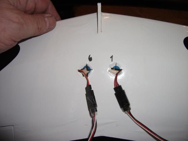

TIP : If you are going to use separate Rx points for the aileron servos as I am ... then with marker pen - note the Rx # next to the lead for future reference ...

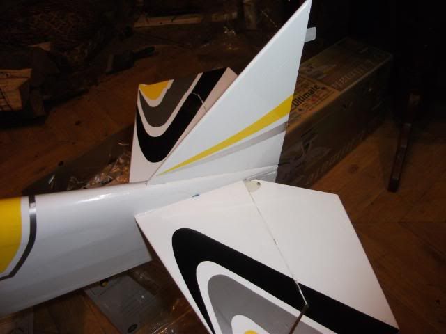

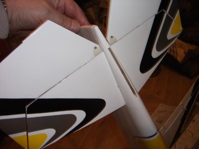

Thew next step is to the tail end - this needs to be sorted before alignment of the two wings ... but needs bottom wing to check setting of tail.
The fuselage is already slotted for the tail feathers and the manual is not too clear abouit making sure of 1 step before another !! I made the mistake of setting elevator hinges BEFORE fitting joiner ... OOOOPS !
THIS must be done before hingeing !! :
Once that's done - you slit the covering of fuselage and slide the horizontal in as fgar as it will go ... a LONG way ! I drew a centre line along the uncovered part of horizontal stab so I could see it via the vertical slot ....
Here you can just make out the balsa insert that goes in behind the horizontal stab ... if you cannot find it - it's in one of the small bags !
When fitting the balsa piece - and rudder ... make sure they are aligned with fuselage parts flush !
To make sure i had tail aligned well - is nice as the bottom wing is flat, without dihedral ... so a good flat floor with bottom wing in place .. lay model on belly and then measure height of tail stab each side from floor, to wing tips etc. When good - run CA via the joint - it wicks in nicely. I also dropped it in via the vertiocal stab slot ....

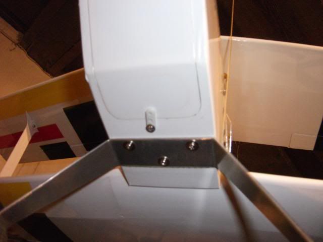

Next I decided to fit the tail wheel ... but the screws supplied were useless as the heads were solid without cross point slots .. rading my servo parts draw yielded suitable self-tappers.
This uses an alloy U bracket to trap the wire to steer ... not a system I like but I decided to go with it.
I prefer a rubber band shock absorbing link saving the rudder from direct shock / damage,.

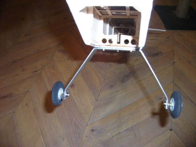

I then removed bottom wing and mounted the main wheels ....
The underside of fuselage follows the pin pricked hole indicators ...
The plywood plate under the covering is drilled ready to take the bolts, with captive nuts already fitted. All you need do is place bolts through U/C bracket ... screw into fuselage to captive nuts ... 5 mins and done ...
Then it's axle bolts ... tube, wheel and the spats ....
(note the wheels have the centre boss INSIDE to separate wheel away from bracket and allow spats in ...
One point that I found ... the slot is supposed to be wide enough to slide around the securing nut ... it's not ! I split one spat fitting it ... finding out.
The fixing holes are marked on the spats - but they do not match the fixing plate. Initially they appear at strange angle - but note the model sits at typical nose up tail-dragger angle ... spats account for that.
Spats are off at moment while I repair the split one and drill out where the axle nut should slot in ...

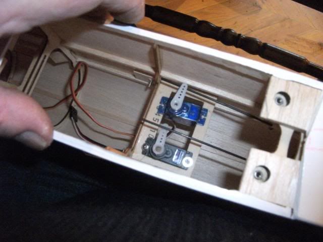

The radio gear is catered for nicely ... a tray is already fitted in fuselage bay and I tried to dislodge by hand - but seems well glued in. It's cut to fit 9gr servos and that's what I did ... a metal gear Corona 929 for elevator and a 9gr plastic for rudder. (I was going to use a Metal gear as well - but I broke the tab on the servo case !! ... so had to use one of the others I have in the spares box ... )
Inside fuselage - I am a great believer in a more permanent and fixed style of servo connection - z bends. Leaving trim adjustment to the external link clevis.

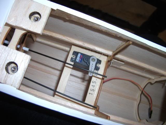

The control rods in this model are well supported by running inside mounted tubes. There's no need to cut covering at rear of fuselage - which I did !! as you run control rods in the tubes and they pierce / exit through the covering ...
The rods lie to a natural offset in the bay and therefore servos should be fixed taking this into account, otherwise you will have binding ...
Trick which works nicely with these rods, they are black coated piano wire ... when positioned - a knife blade scraped across will mark through the black to the silver wire under ... giving you the 'bend' point for the z bend ...
I fitted the rods to 1 hole in from end on servos and surface horns .. knowing that this would be too much against manual advised movements. Idea to then use EPA to bring movement back to recc'd limits. I always then have extra if I want by upping EPA and not having to play with the model links ... using such holes as well kept rods as bind free as possible.

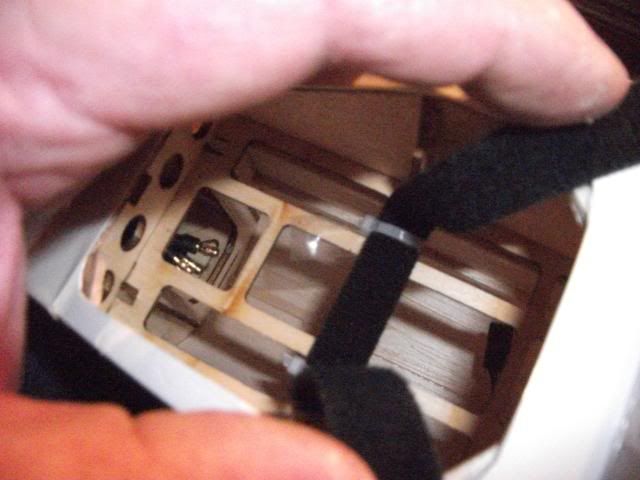

The battery bay is ahead of the U/C and has a nice pre-made door but no fastening for it. It has a front tab and needs a fixing at rear ... more on that later.
In the box you are provided with large foam pad ... plus a velcro battery strap ! Now that's a nice addition. But how to fix ? I decided to tie-wrap it to the frame inside fuselage ...
The battery space is cavernous to say the least and will cater for a larger pack as long as you do not increase length from a standard 2100 3S.

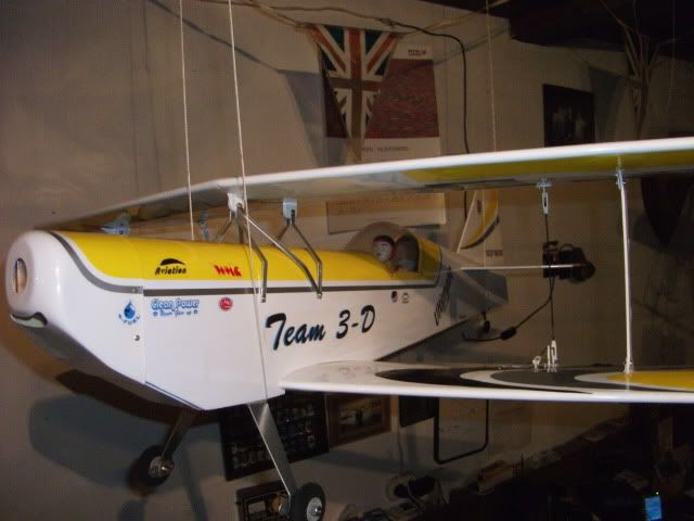

Now she waits motor .... on this I made a mistake .. I ordered a Turnigy 2836 - but missed that it is a rear mount motor. This model has a framed motor mount that needs the motor inserted in behind firewall, shaft to go through a hole and mount screws either side to fix ... a front mount motor. So a new order today for a 2836 1000kV motor with front mount and 300W rated ... on a 3S pack.
Manual advises a 180W 2830 .. but talking to a guy who flew one on stock RTF 2830 as manual states - he reckoned it was a nice cruising sport flyer - but lacked oooomph to get into real aerobatics. i hope that the 300W motor will supply sufficient..... the model as per manual is 770grams AUW to fly ... giving me 177W / lb ...
Some will notice that Spats are still not fitted ..... I still have to repair the one I broke and then drill out the slot ... they will be fitted before maiden !!

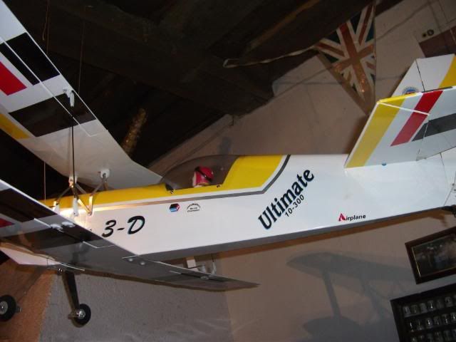

I've got the Precision Aerobatics 40" span version of the Ultimate. This is also superlight construction, mine weighs in at 1089g, inc. a 3s, 2200 Lipo. (924g excluding battery). I'm guessing to come in at 770g this one must be a bit smaller?
Anyway, if it goes anything like the PA one you will have a ball. 177W/lb is roughly what mine is running at which is good for 3D work and unlimited vertical.
