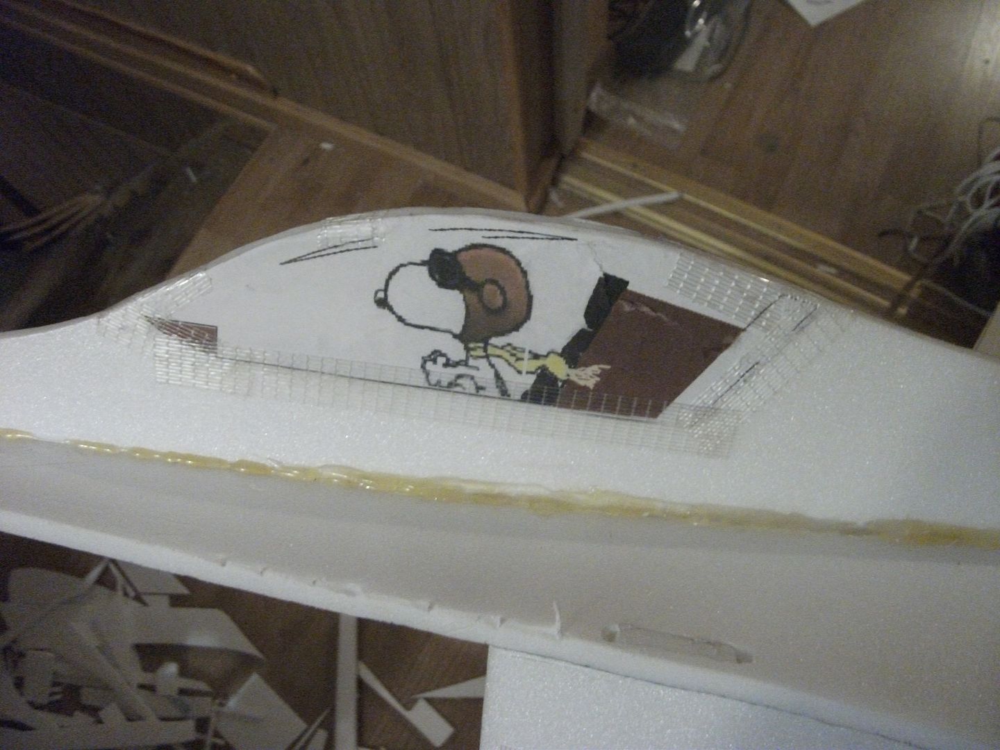

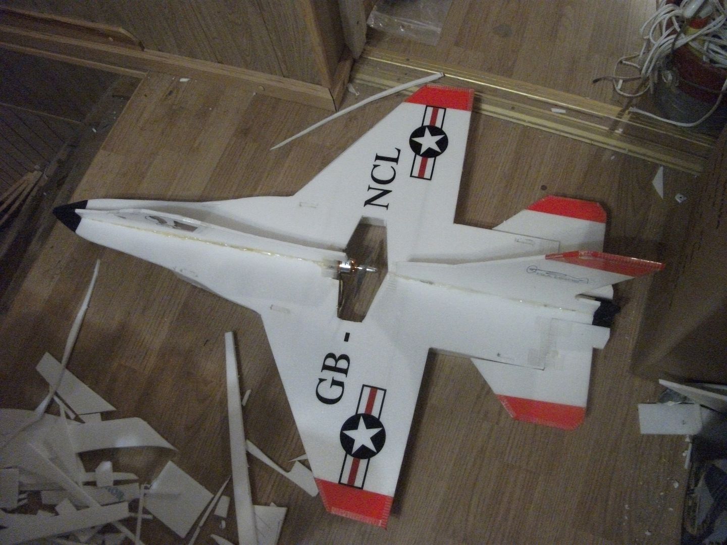

Decided to 'knock-up' a profile F16 ..... Depron of course ...
Just need to sort out the radio gear now .... of course its using the typical Turnigy 2826 2200kv and 6x4 prop !! Expecting to throw a 1500 - 1800 3S in her ... maybe a 4S if I feel adventurous after its maiden.

First flight .... OOP'S ... elevons reversed ..
Grafted new nose section on and tried again today AFTER correcting elevons !! WOW !! What a machine.

My spare 2826's are all similarly shot on windings ... so have ordered a slightly higher kv motor from Banggood ....
While waiting - I dragged out a spare motor ... remember the Rarebear Funfighter from Hobby King (actually it was a re-brand) .... it had a 2825 1940kv motor designed for 4S and 5.5x4.5 prop.
After removing the silly 1mm bullets and fitting decent 3mm ... I installed to the F16. Needed drilling clearance hole for the rear shaft ...
WOW - on 3S with 6x5 prop - F16 tried to rip out of hand ....
Gave her a reasonable run till my ears said enough ... motor was stone cold.
Reckon she could even run my 6x6 racing prop ! If I go 4S ... then its 6x4 ...
