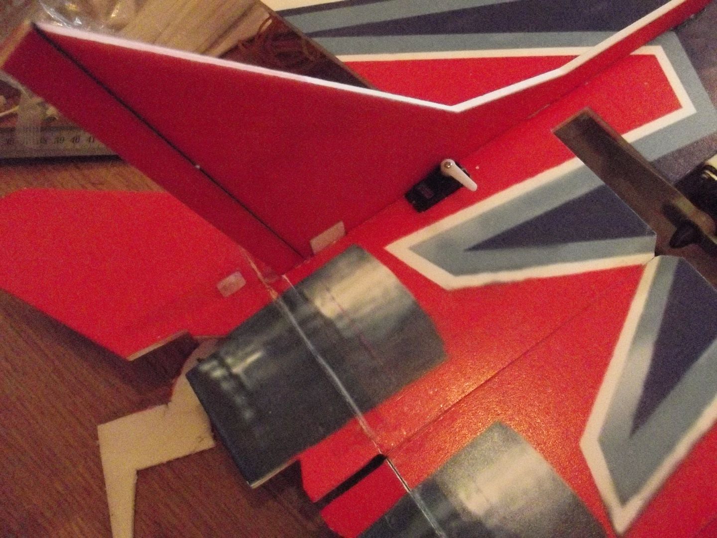

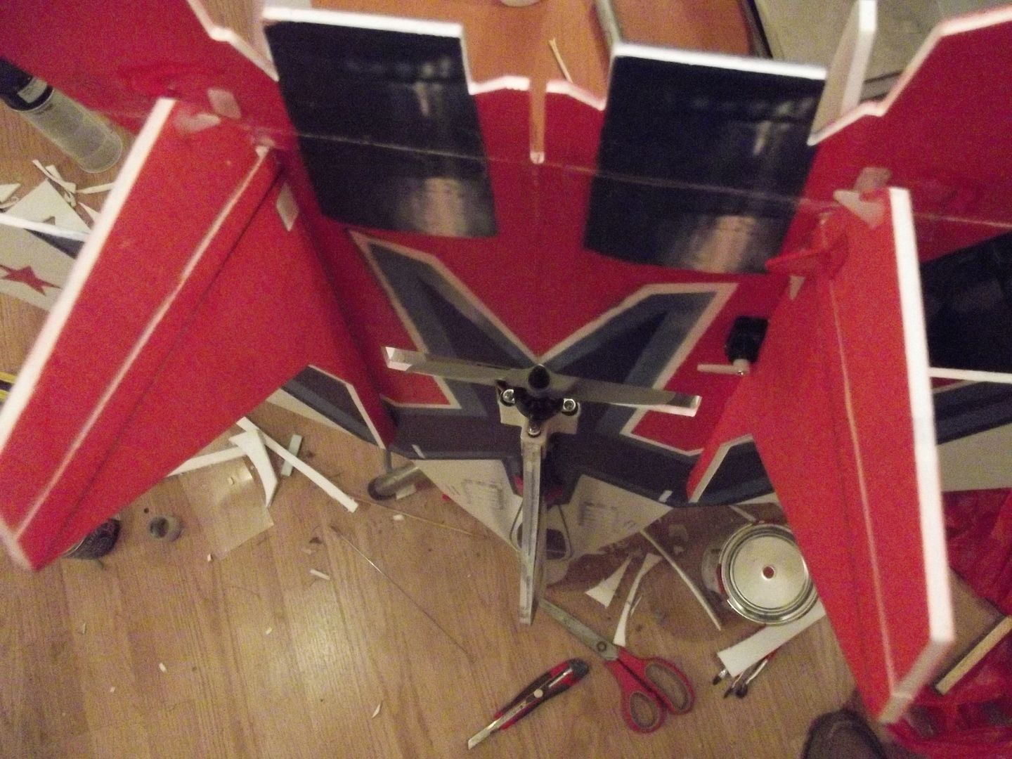

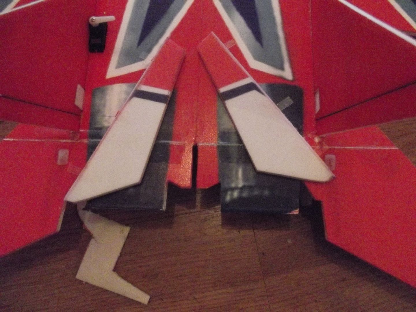

OK ... Rudder conversion ...
A metal geared TGY-9018MG Servo (same size as a 9gr but slightly heavier due to MG ... ) and one connection + rudders linked.

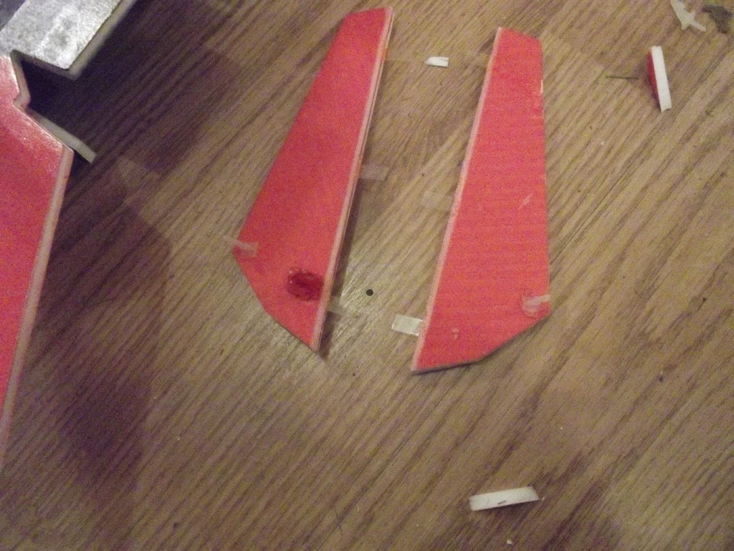

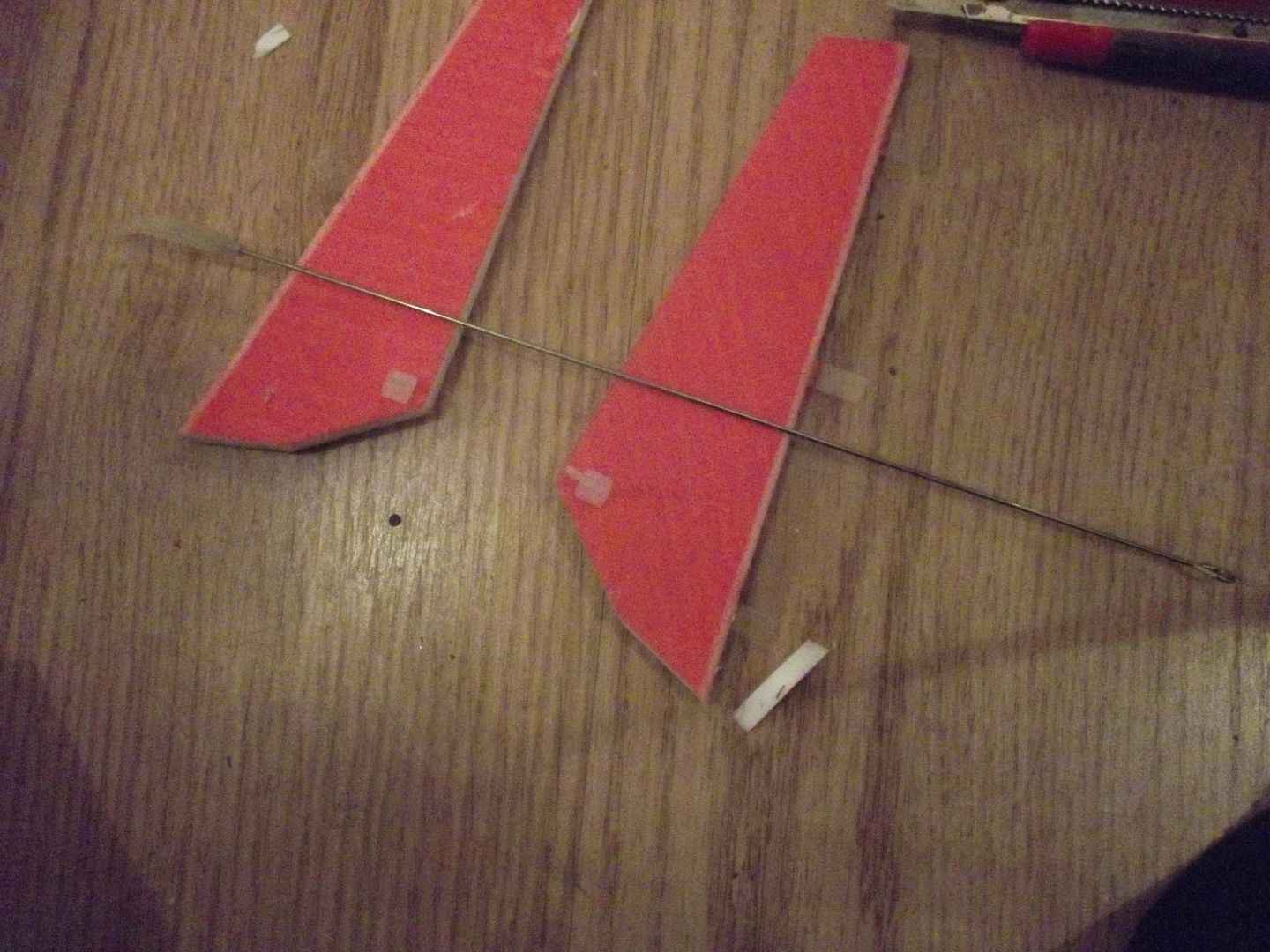

First thing is that the CF stiffener is set at a place where I would prefer the hinge line ... and then you have to step back a bit to leave enough foam to take the hinge ... (I could have used tape but prefer fixed hinges).
Ok ... rudders now have a chamfer to leading edge - doesn't need much actually .. and mylar strip hinges fitted..
Horns added ... decent one for control rod and mini ones for the link rod ... note that link horns are out away from hinge line to get the leverage ...
Note that when you remove the rudders - they will need an angled slice from the bottom to clear the elevon horn plates when elevons are UP ...
OK ... fitting and set up ...
Now I can do the snake dance across the field !!
Next is to interlink ailerons with elevons ....

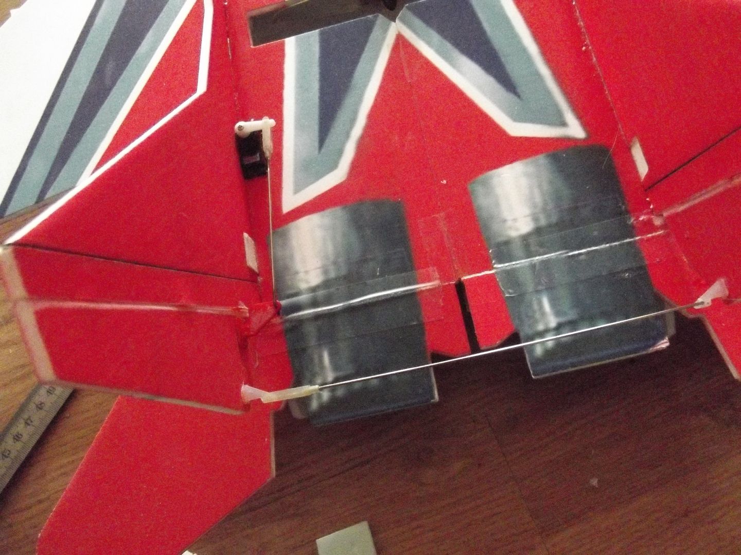

Posts: 12,522
Wind is awful and I kept looking at the 29 ... finally knife out and sliced of the ailerons !! Rods made ... just need to hinge and connect.
They will be connected to elevon servos as my F15 ..... no need for separate servos.
