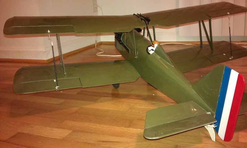

A couple new photos of the SE5 to show how the battery can be fitting in
I know the hold downs on the battery hatch is not scale, but it does the trick
Since I destroyed the cowling in the crash, Ive ordered a new one, but also decided to make my own from some balsa. Cut it last night and now just letting the glue for the magnets dry til this afternoon. It has been sanded to shape and I am installing cooling fins to look more like the original. Im using the metal covers from old 3 1/2 floppy disks. Should really look good once I get it finished tonight

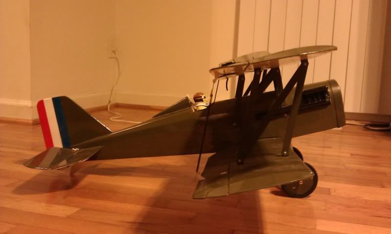

Some pics of my new cowling
What do you think? The fins need a little adjustment, but thats tomorrow

Love the louvers! Its such a fun plane to mod, just begs for it.

Think Im done modding it for a little while. Well. might lengthen the Lewis MG rail to look right. The cowl is all balsa, have to see how it does. Replacement plastic one on order. The louvers are made from the alum covers from old 3 1/2 floppy discs. Can be cut with a pair of scissors. Now to just adjust them to make them all look right. Inside the cowling opening is a piece of screen to look like the radiator. All flying wires are attached with strechable thread, had to got rid of the braided SS wire. It was not maintaining the tension I wanted and was pulling the wings out of alignment when they were tightened.

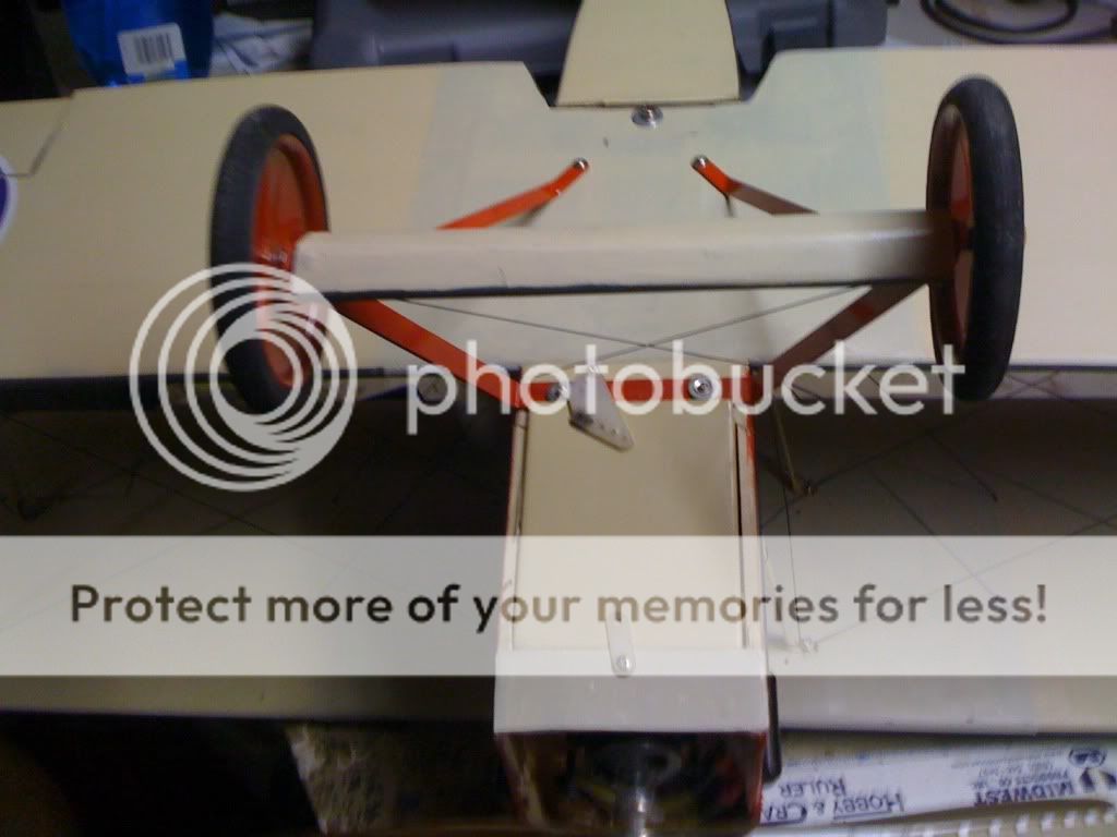

I can't wait to get mine finished. All electronics are in, need to reassemble wings, install my modded sport wheels that I am covering to look scale.
Also install the motor and prop.
I am told this its a Lanier kit, I got ti 3rd hand and in need of repair.

I think the Lanier is a bit larger than the Electrifly version. Post pics!

The bottom wing is 38 in. the ailerons are 8.75 in. on lower wing.
