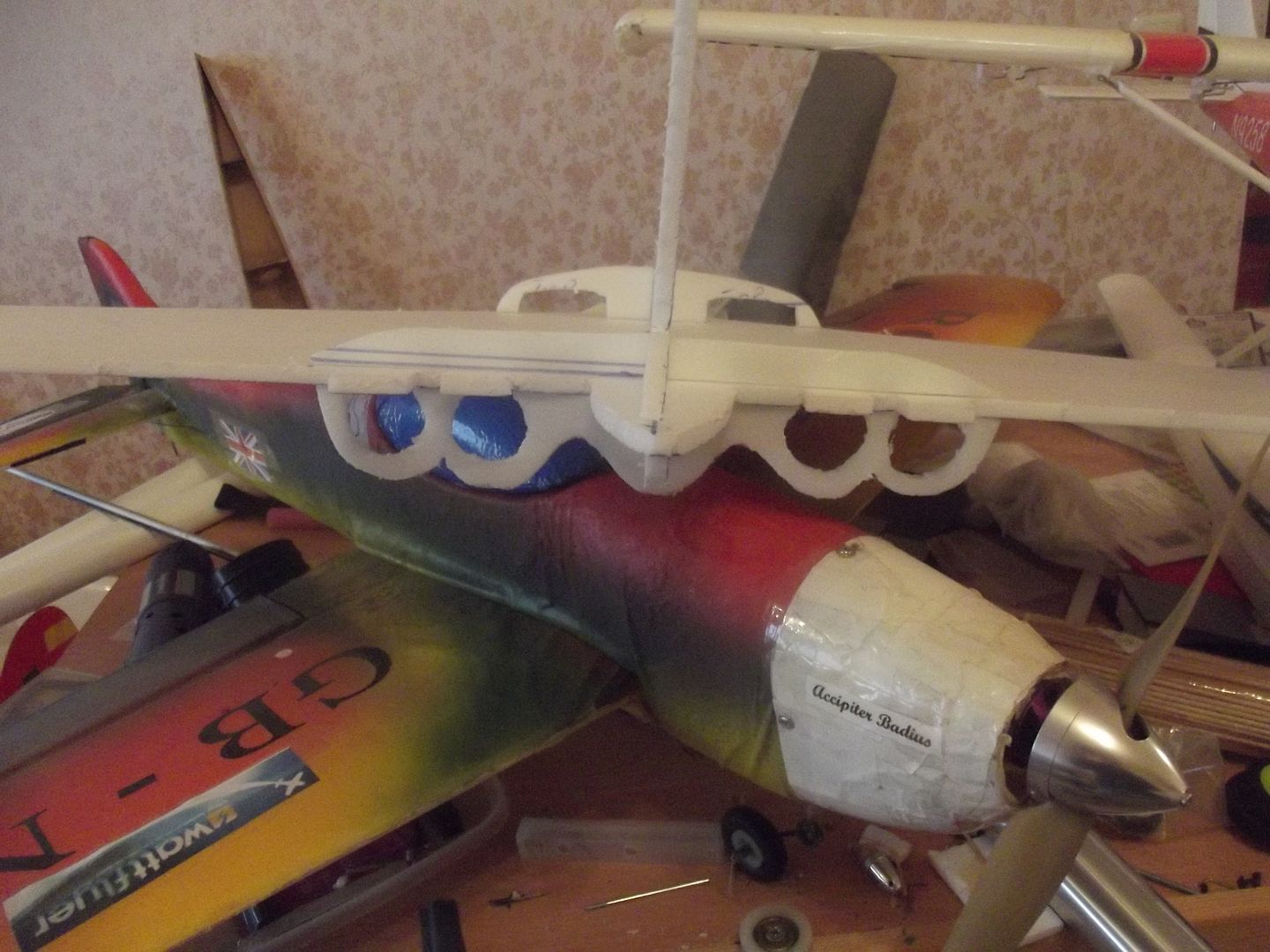

As many here already know - I tend to be a 'wing and a prayer' cut as I go builder. Having sketched the initial plan - its been a brain-job to figure out how to contour that wing to fuselage while keeping those intakes and exhausts shapes.
Bit of artistic licence called for and as Quorneng said - who could ever argue with THE master anyway !- the wing with spars / structure becomes remarkably strong. I will need no CF at all.
I left last post with the X form wing and fuselage spine. I finally came up with an idea and started with the engine intakes ...
Idea to remove the piece of wing crossing the intakes later after skinning.

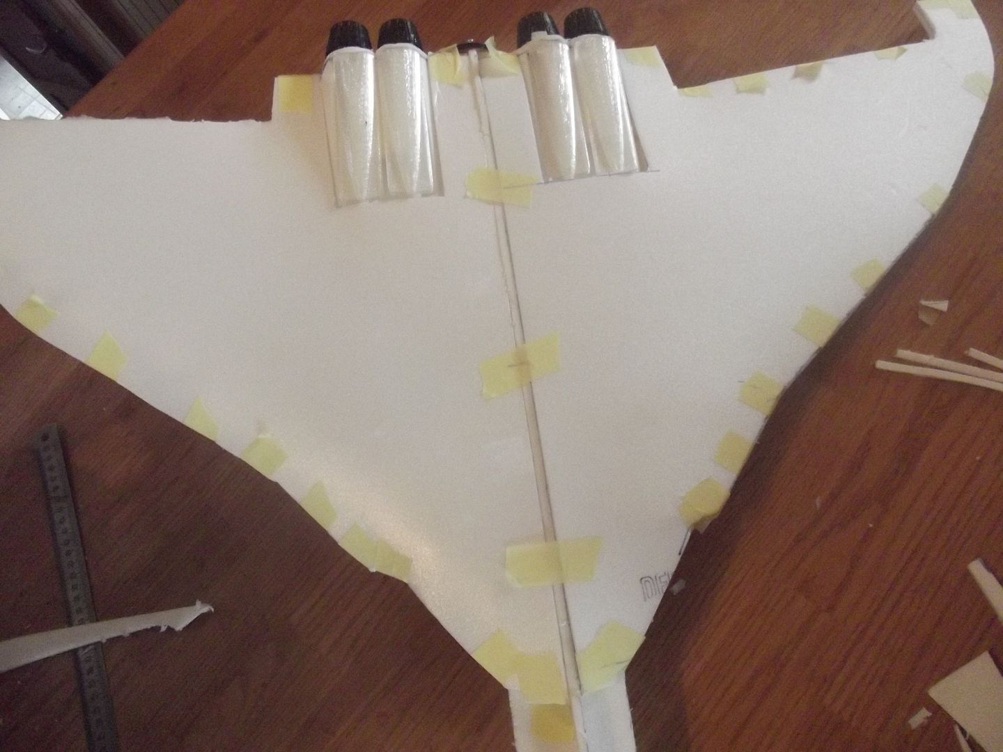

Next was to see about those iconic exhausts ...
Again remove wing bits later ... and I hope to 3D print tubes to glue on for exhausts ...

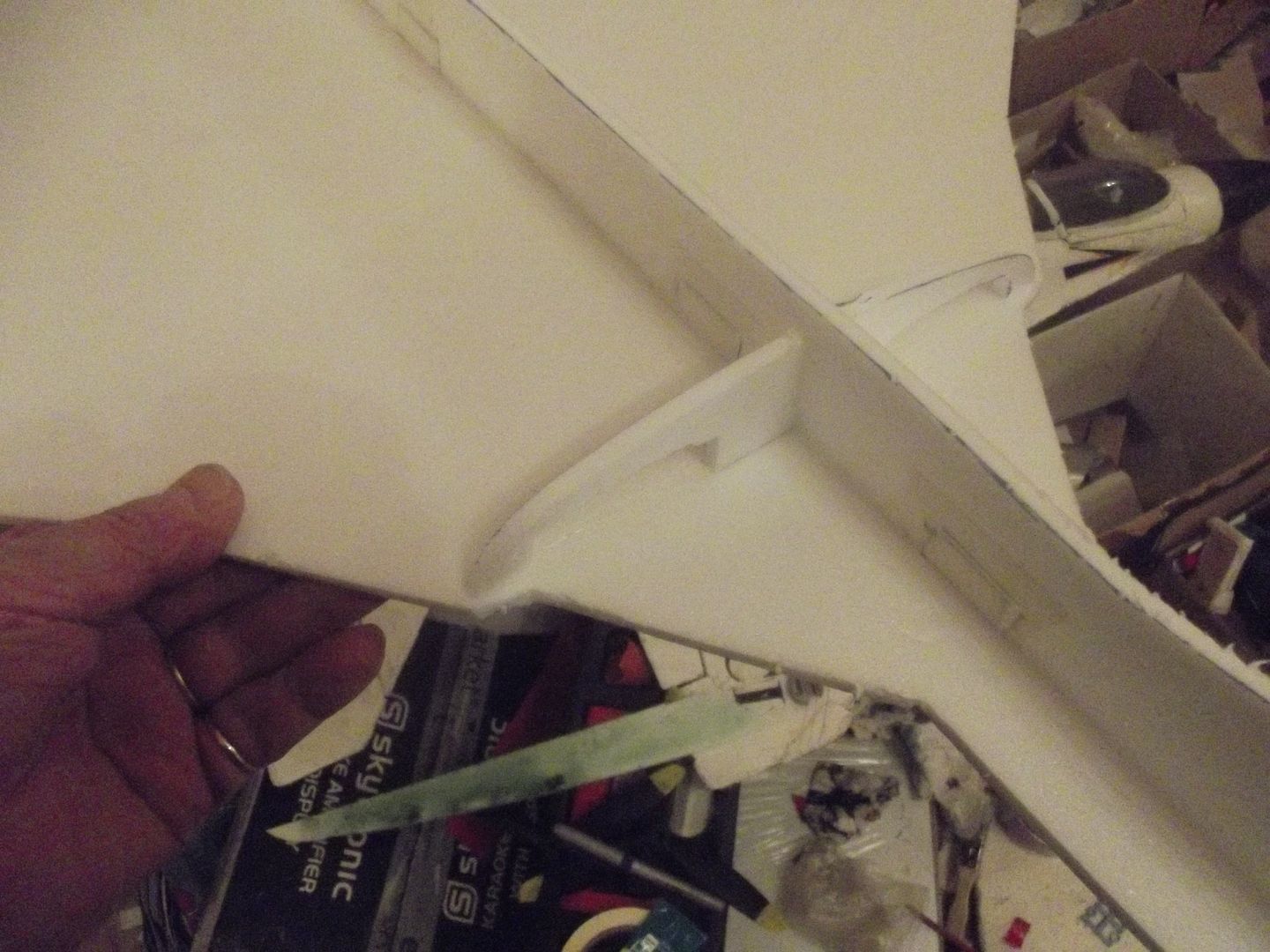

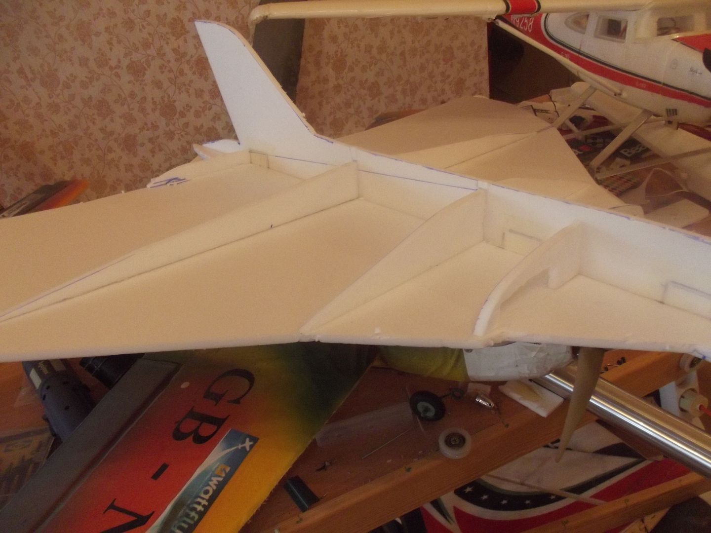

Then had to think how to grade that wing sheeting with spars and formers. Here's the spars in and similar underneath of course ...
The wing already now is stiff and I reckon once the top and bottom 3mm sheeting is added - will be more than strong.
Process now in my mind is to actually near complete the build so I get the overall shape - THEN make the cut-outs for gear. Of course any wiring needed for servos / motor will be pre-installed over length before closing up. Possibly not sheeting top of model till sorted. Its all 'suck and see' at this stage.
But it looks like a Vulcan already !!

Found some ideal thrust tube exits that scaled down are perfect ...
Now to match in with the blisters running along underside of wing / fuselage sheeting once sheeted.

Engine blisters in place and sheeting in progress.
Top sheeting will wait until I have sorted out internal gear.
