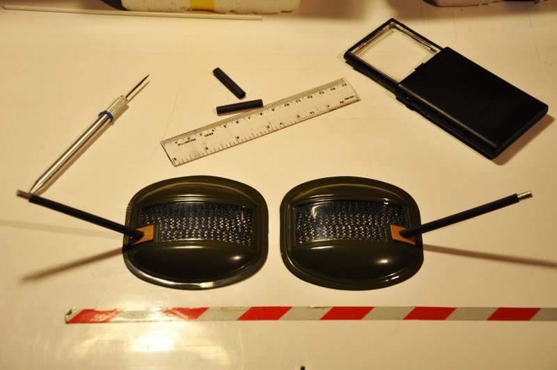

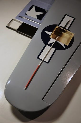

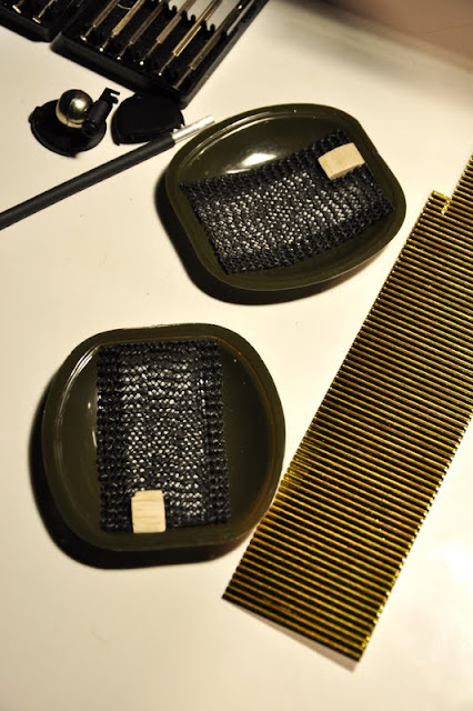

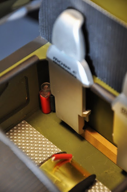

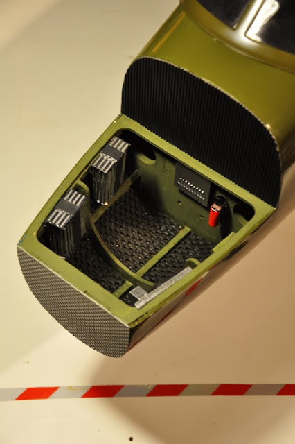

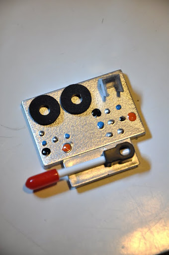

Good day Gentelmen & Ladies ...
Here is my MITCHELL B-25J in a long scale making ...
Each time I will work on her I will post here to update the work in process ...
She is still in the making ,,, and in no rush with many modification to come alive.
Enjoy the view !

Your controllers are near the motors, where are the batteries positioned?
Keep controller(s) close to battery if possible, and extend motor wires.
Keep the battery wires short, or else install extra capacitors, all on/near ESC.
