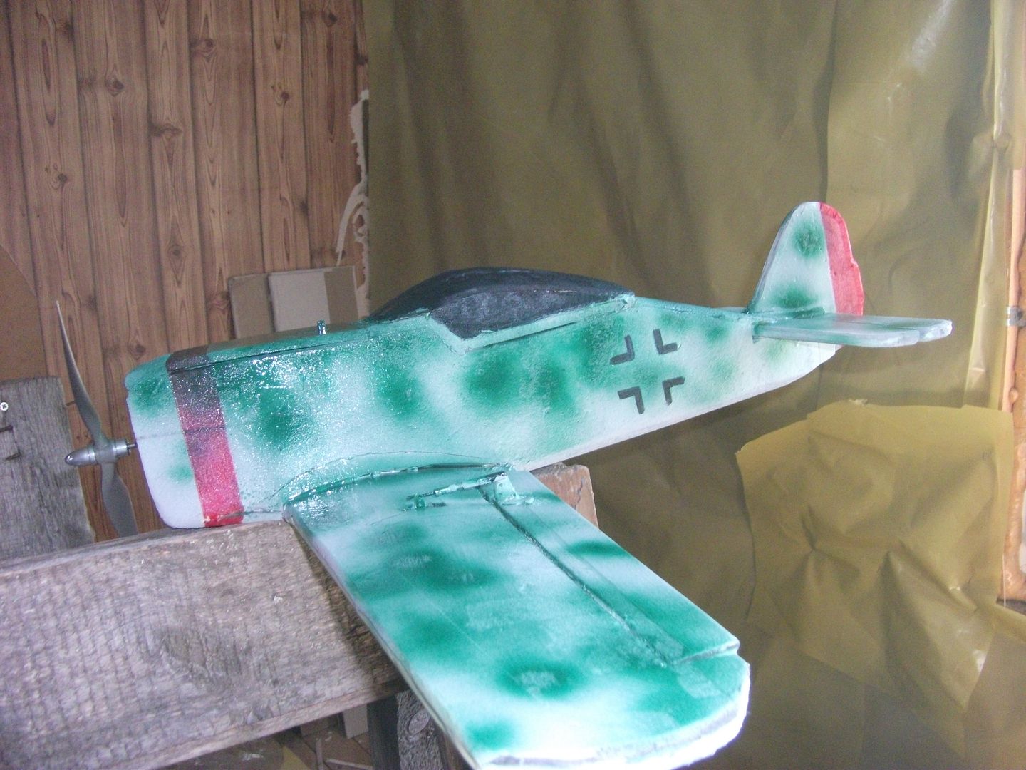

I think you may have misunderstood.
A good flyer has reasonable distance between the main wing and tail 'feathers'. If you look at any trainer ... you will see a nice long fuselage after the wing before tail. This reduces the pitching moment to give good calm control ... but when its short - it can be violent pitch moment and even for experienced rc flyers can prove death to a model.
I designed and built a cartoon FW190 ... and that short fuselage killed it.
It survived a couple of flights but it really was a real dog to control !! I've been at this hobby for over 55 years and I shelved her ...
