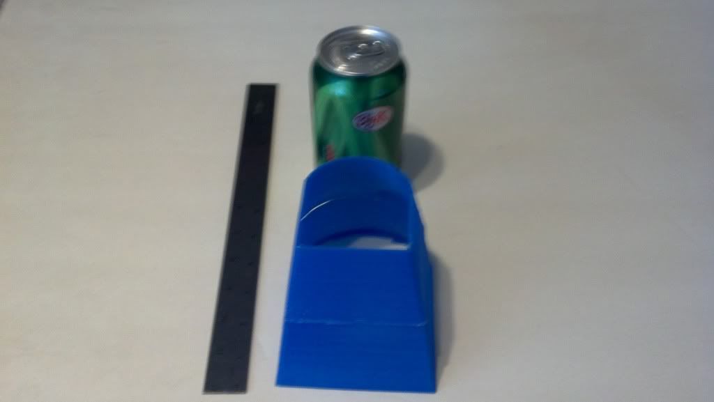

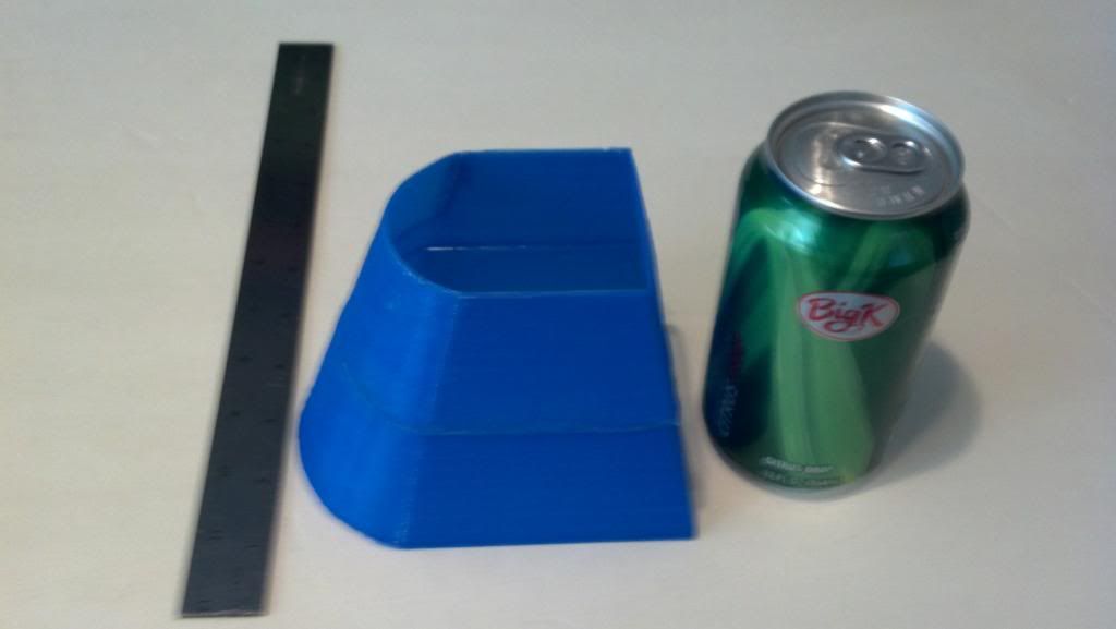

I want to see if I can help make a your cowl. I have actually been having fun doing it. Not to say what you are doing will not work. As I am sure that it will. And you won't want to wait for me to make it. Still if you could send me the dimentions I would be interested in an opinion of what you think of 3D printing. Keep in mind this is an experiment and may not work. But if it does I could put the files on thingiverse or upload them to shapeways or something then the next person to need a cowl and cant find one might have a few more options. If you decide to do it this is what would I would need. Some type of outline of your firewall. What I would do is take a peice of paper and a crayon and make a rubbing. This would show me where all the holes for the motor mount need to be and the edges would help me match the fusaloge. I would also need the distance from the firewall to where the engine thrust washer would need to be, or how tall you want the cowl. I would then have you scan the firewall rubbing and send it to me. I have not tried the PLA plastic with nitro fuel yet. If you choose not to do this I understand, and will not be offended in anyway. If you are curious I think the forum would like to hear what you think when you get it. I can draw up a cowl and print it the same day. Its just not that hard. Even if it doesn't work I wont be offended. Below are some pictures of the last cowling I made just for fun it doesnt even go to anything. I was just playing around.
The cowling was made in two pieces and just stacked for the picture not glued or anything.
