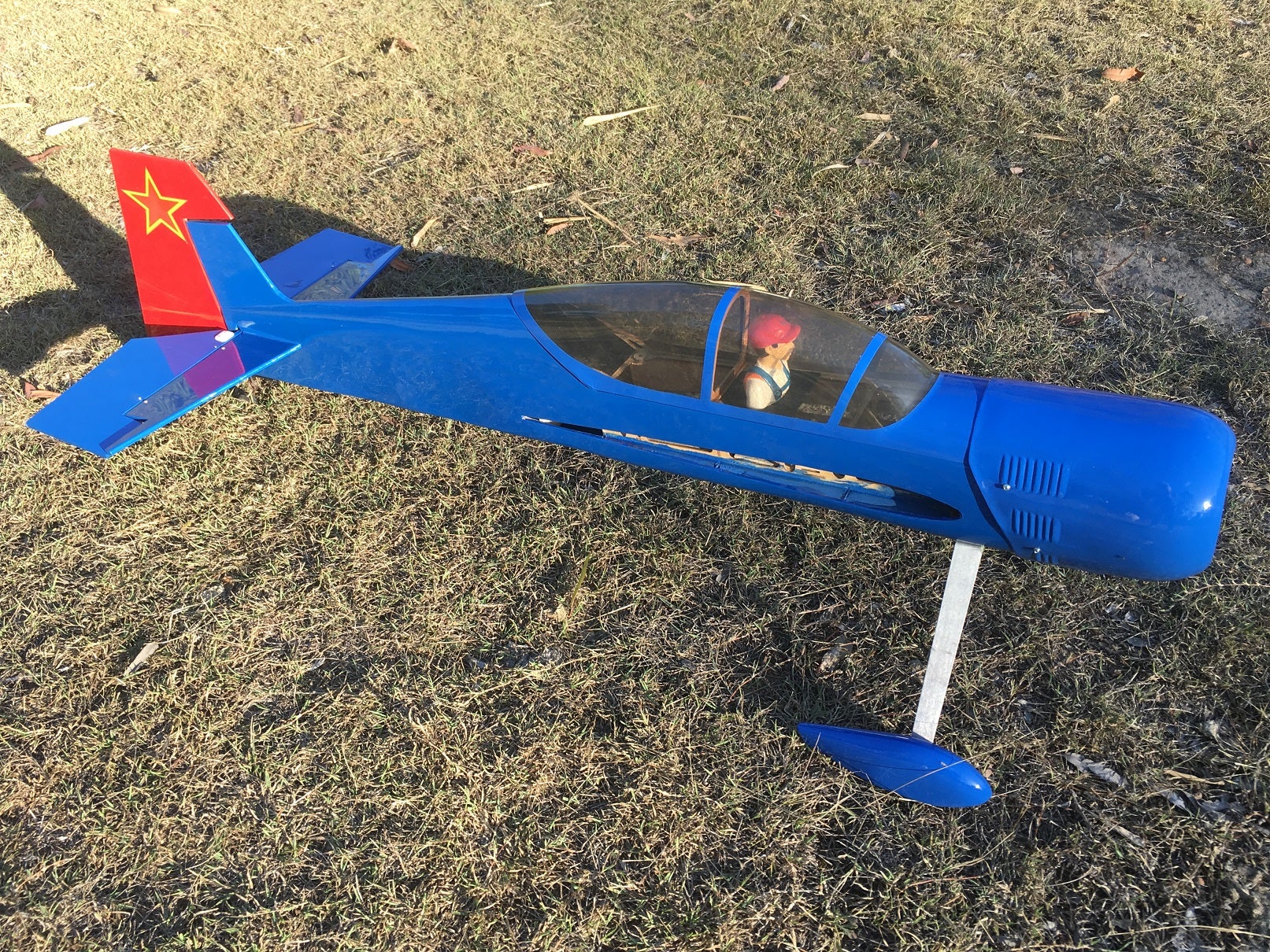

Covering film will be here early next week. I have painted the spats and cowl and some of the Canopy and fitted my pilot.
Starting to suspect that the film may be a slightly darker blue than this.
I couldn't work out why the canopy used to fly off on regular occasions. Very annoying. I took to taping it in the finish.
Now I have rebuilt it I found the reason. 2 of the six canopy retaining magnets were mounted in reverse so they were repelling each other. All fixed now and got a grip like Tarzan.
