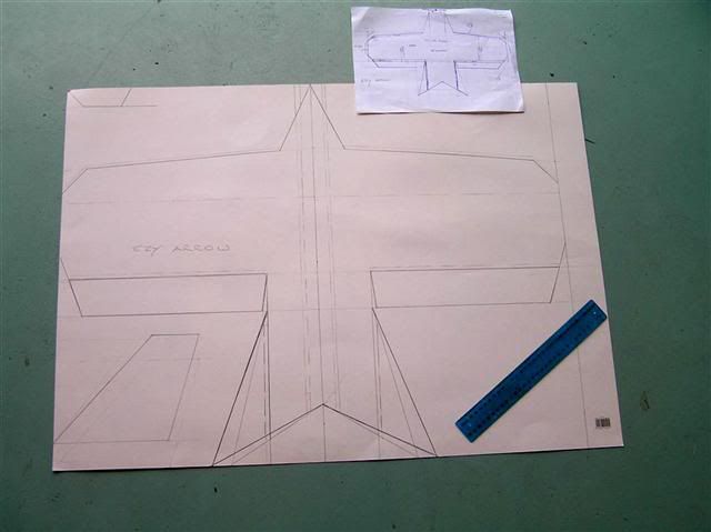

Posts: 56
Yes I will, Design stage in my head and starting a few sketches
Enkay is offline

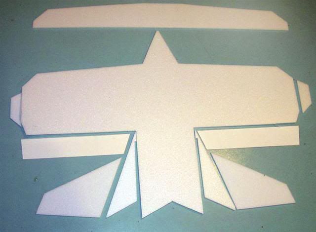

Default EZY Arrow
Hi Babylon 5,
I have sketched out my new Depron Plane and have cut it out ready to put together. Will keep you informed. Have seen some of your videos on you tube. I have a Funjet too but I don't go in for too much speed.
Enkay

Old 05-15-2011, 12:20 AM
Enkay
Enkay's Avatar
Location: Havelock North, NZ
Posts: 56
Default Arrow
Building Started
Enkay is offline
