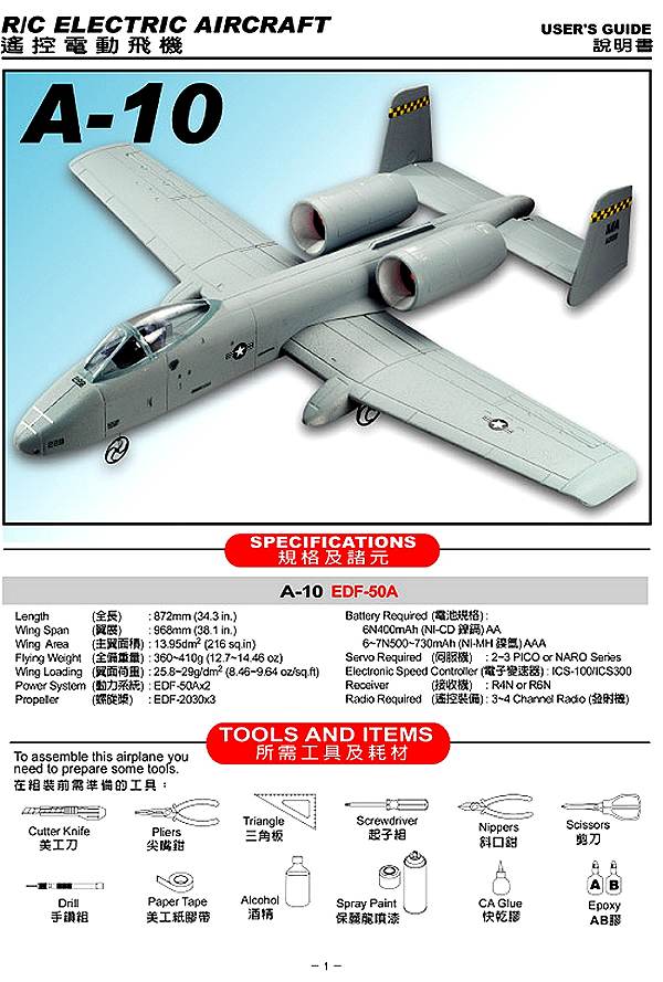

Default am I ask'in to much of this plane? A-10 GWS
GWS A-10,,,Theres HUGELY differant opinions on the Brushed-Verses-brushless, I want one but can't afford another brushless twin set-up but have all the stuff for brushed (And a brushed-lipo/nicad ESC-25)and plan to use a 1600 3 cell on her, as those that know me know how Light I build (24Oz formossa11) am I ask'in to much of this plane? I'd like to order her but I don't want to sink a bundle-o-$ on her to get-her-go'in, thanks ,, ya'll's bub,steve

I had a very nice flying GWS A-10 it was when they first came out. EDF50 brushed setup with a 7 cell 700 mah NiMh pack. No landing gear. I also flew it on a 2S lipo as well. You needed WOT all the time but it was doable.

It is very doable. It is what I will do whenever I get around to building it. There are lots of guys on rcgroups.com using the EDF55 setup with the stock brushed motors running off a 20-25A ESC and a TP 2100 3S.

Thanks guys::I've noticed that most the threads I've read said they were fly'in um at 24-29 Oz But the fly'in weight on the manual says 12.7-14.46oz, have'in said that,,are these guys build'in lead-sleds or is GWS weight est, WAY OFF?bub, steve

I think some are building lead sleds because they are putting high power dual ESC setups in there with 3s LiPos. Because of that extra power, they are putting CF all throughout the wings AND fuselage and some have even glassed and painted it. I think if you are going to do it with stock brushed motors and a 3s Lipo you would only need a little CF in the engine nacelle mounts, wings, and fusealge around where the wings mount and thats it. Build her light!
