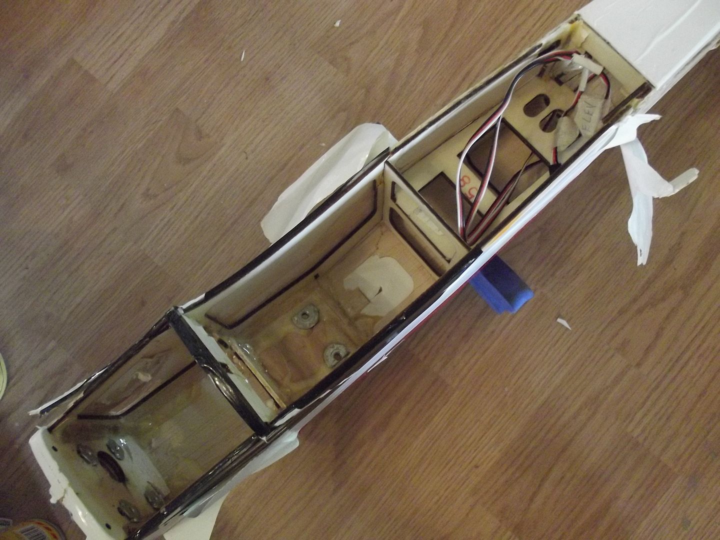

The fuselage though - it was a mess. The original WOT4 was slab balsa sides with full sheet ply doublers back to just behind TE of wing. Todays is the same full sheet balsa sides but with skeletal ply doubling similar to many of todays lighter models. This of course meant that even though throttle was closed, and she went into long grass ... the fuz shattered all way back through to behind TE wing bulkhead ...
I'm a stickler about collecting as much of the debris as possible. So a Jigsaw puzzle ensues ... when I get bored arguing with Oil Operators / Ship Owners - I work on my models ...
Piecing back together can be successful, little bit of shaving off with knife ... prying / pushing / clamping / tacking with CA ... and we start to see results.
With this repair - I could have run up the Laser machine - but decided that I would go with the bits ... jig back ... strengthen where necessary with PU glue. Only one area did I have to add a jigging piece of ply to align one side of rear wing seat.
Next photos show the missing balsa sheet areas that will have the pieces tacked back in and then PU glue used to strengthen / fill the gaps. PU glue when expanded / set is lighter than the balsa and actually stronger.
PU glue dribbled into internal structure and left to work itself into gaps etc. Tape on outside to stop 'leaks' and to form.
This was the worst part - getting that tray in and keeping the wing seat as close to original as possible ... you can if look closely - see the short piece of bridging ply joining rear wing seat ..
Here are the last bits to go back ... with careful knife work ... CA and PU ... I should get a reasonable solution. I don't expect her to look perfect ... but at least be back in the air performing as any WOT4 should !
Last comment ... I am still amazed that the prop never broke ... cowl, spinner, firewall, motor, stand-offs, all still in good order ... all indicates she went in 'soft' ... but the carnage to fuselage ?

Never throw away those scrap balsa bits ...
They can provide slivers and pieces to CA gaps and holes with ...
It may not be as pretty as she was - but she's strong and all together ... just needs gear back in ..
Wing seat lines up perfect ...
Later I will be removing the Film cover on her to fully sand everything back and do my own colour scheme ... but for now I need to get her back in the air to prove more work is worth it !
