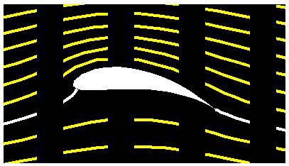

During flight, air naturally flows over and beneath the wing. Any given 'parcel' of air gets split in two as it hits the leading edge of the wing, and both halves of that parcel actually meet up again at the same moment, as they come off the trailing edge of the wing. So because the air moving over the top of the wing has more distance to cover (because of the curvature it is forced to follow) in the same amount of time as the air passing below the wing, it has to move faster.
If you're having trouble following that, look at the picture below showing a parcel of air hitting a wing. Arrows A and B is air getting split at the same moment, and meeting up again at the same moment.
Faster moving air is lense dense than slower moving air, so this results in a lower air pressure on top of the wing, and a higher air pressure below the wing.
In addition to this pressure gradient, some of the air that passes beneath the wing is deflected downwards. This causes an opposite upward force (Newton's 3rd Law of Action & Reaction) that acts upon the underside of the wing, effectively pushing it upwards.
This combination of reaction and pressure gradient generates the lift needed to hold the airplane up as it flies. And the faster a wing moves through the air, so the actions are exaggerated and more lift is generated.

Unfortunately the section on 'how wings generate lift' is incorrect (both parts).
The first theory presented is sometimes called the equal time of transit theory and is based on the unfounded assumption that air separated at the leading edge must for some inexplicable reason meet up again at the trailing edge; this is totally incorrect. The theory also neglects the obvious fact that symmetrical airfoils and flat plates fly just fine and that planes with 'normal' airfoils can fly upside down.
Also the bit about deflection of air downwards (which is closer to the truth but still not the whole story) neglects the effect of the upper surface of the wing. This theory can be called the skipping stone theory' and is at best a partial truth. If this theory was true then a stall (which is the separation of air flow from the upper surface of the wing only) would not effect lift at all.
The correct explanation of how a wing works can be found here: http://regenpress.com/. Unfortunately the truth about lift is quite complex and difficult to grasp hence the invention of simple but wrong explanations such as those presented.
Steve

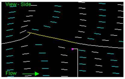

Newton’s third law of motion states that for every action there must be an equal and opposite reaction. Image a cannon firing a cannonball as force is applied to the cannonball accelerating it in one direction, the cannon recoils in the opposite direction with equal and opposite force.
A wing in level flight turns the air in downward direction which required downward force, the equal and opposite reaction creates a force pushing the wing upward, this is the force known as lift.
It’s quite easy to imagine how a wing moving through the air at an angle to the airflow will push downward on the air with its lower surface, turning the air downward and increasing its pressure, but this is only half the story. The upper surface of the wing also does at least half of the lift production. Air flowing over a surface has a tendency to follow the surface even when the surface curves or is inclined away from the direction of flow. This is called ‘surface attachment’ or sometimes after the man who discovered it the ‘Coander effect’. This means that the air flowing over the top of the wing tends to follow the wings surface deflecting it downward and lowering its pressure.
The flow turning theory also works perfectly well for flat plate wings
If the angle of the wing to the airflow is too great surface attachment of the upper surface breaks down and this greatly reduces lift produced by the wing (and increases drag).. this is known as a stall.

Circulation and vortexes are not two aspects of lift, they are both results of turning air downward.
Taking on your first question:...
Circulation
When air is turned down it creates a low pressure on the upper wing surface and a high pressure below, this is purely down to the forces involved in accelerating the air.
Now comes Bernoulli.. If the pressure on the upper surface is lower than the pressure on the bottom surface then according to Bernoulli the air on top of the wing must also travel faster that the air on the bottom.. (Note carefully that it is the pressure difference that leads to the velocity difference, not the other way around)
So we have the air on top going faster than the air on the bottom. If we now subtract the overall ‘freestream’ air velocity (i.e. the planes flying speed) from both top and bottom local airspeeds this gives us an effective circulation around the wing with the air flowing backward on the upper surface and forward on the lower surface. Because the speed of the circulation is caused by and is therefore in direct proportion to the pressure difference (Bernoulli), then the speed of circulation is also directly proportional to lift..
Now question 2...
Vortexes
Vortexes at the wingtips do not produce lift, in fact they decrease lift. Wings in a wind tunnel that have their tips joined to the tunnel wall have no tips and therefore no tip vortexes but they produce lift more efficiently than any real wing that has tips.
Tip vortexes are a bad thing and if they could be eliminated they would be.. High aspect ratio wings and wing tip fences/winglets etc are two methods of reducing tip vortexes but in the real world where wings must end ‘somewhere’ tip vortexes are unavoidable. Tip vortexes are a ‘by-product’ of lift not the cause of lift.

Here is a diagram showing the forces on a glider in 'steady state' flight.. note that forces are generated due to the glide ange.. CG of the glider does not get mentioned because it's not relevant. The diagram comes from 'Model Aircraft Aerodynamics' by Martin Simons (a good read)
Air travelling over a convex surface does indeed produce a low pressure on the surface but the reason has nothing to do with Bernoulli.. It's simply down to centripetal acceleration.
