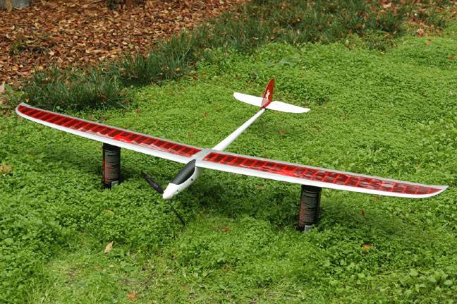

Default Maiden soon
I've got my Fly Q together now.
Pretty easy build with only a couple of hick-ups along the way.
While not a fully molded plane it is very slippery looking. I'm extremely pleased with the over all finish, and quailty of the parts.
specs
Fly Q
AUW = 628g <-- pretty much blew my orginal estimate away
eflite 400 outrunner
eflite 20amp esc
1250-1320 lipos
HS 5S micro rx
4 x HS55's
11 x 6 folder (altitude adjustment)

Wow, it really is a beautiful plane regardless of the good price! I've actually decided to try a scale glider this time, so I will be working on the ASW-28 2.5M over the winter. It will also be electrified. I will use a Scorpion 3008-32 motor. 400watt. Your setup should really pull nicely.
Your plane makes me want to order the Fly-Q also....oh man my wife would have my head on a platter for Thanksgiving.
Please post more photos a video and a report of the flying. Awesome!
