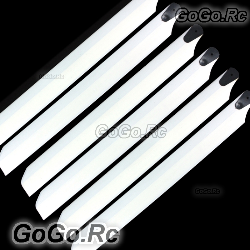

Not sure what cheap means.....but here's a site that has inexpensive blades.....and may ship outside of the U.S. cheap......:
http://www.rcplanet.com/RC_Helicopte...des_s/5276.htm
Otherwise, stick with Align or Align after-market clone OEM parts (to include rotor blades).....with blades, balancing is critical...if you don't have a balancing gauge (tool), you'll soon wish you had one....!

When I was first getting a feel for things.....many moons ago, I stuck with Align wooden. Just made sure they were balanced properly......much less cost and during that "learning" level, the performance is not a factor.
The glass/fiber blades are fine, but still less forgiving than wood and more balance sensitive after being shaved down from prop stikes.
Remember, glass and or CF do not crack (bevel) or "polish" on strike........CF just explodes, fiberglass chips and ravels.....making both difficult to re-balance or use a 2nd time safely....!
I only used carbon fiber blades after my pilot skills reached "0" prop strikes and I had "total" command of the bird......"total" command being able to invert hold hover at 10' above ground......no fancy tic-tocs, piro's, hurricanes, switch-backs.....just "basic" invert and hold with authority!........I've never claimed to be or intended to become a 3D master.......my physical/mental reponses were way past developing skills needed for "true" 3D flight.......I started with 450's at the age of 55....but that's not what I drive.......

I was reading some mixed feelings on wood and glass fiber. The wood is said to be only okay at lower headspeeds, perhaps becoming dangerous. Lower headspeed also seems to be more difficult, giving you less control. With the glass fiber, some were saying that the fact they are stronger causes more parts to break at strikes, thus costing more than a set of CF blades in the end.

For blades Hobbyking have a lot of choice many available from the US warehouse: http://www.hobbyking.com/hobbyking/s...300_399mm.html

Use the wood blades, the wood blades from HK are Ok to use, when first starting out, they will splinter and absorb most of the impact, your not going to use high rotor head speeds when first learning, the fiberglass blades are strong, but when you crash, they will take out the tail boom and a bunch of parts with them, helis are a money pit untill you get good with them
http://www.ebay.com/itm/325mm-Wood-B...item4174efa887

That they are. So it seems it wood to learn and CF for the rest. As for headspeed, I do run at about 80% throttle. With my crash, it was only 50% actually, in idle up mode. Not sure, but maybe it didn't help matters being a low headspeed.
