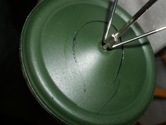

Okay guys, what's the secret to making one of these things fly half way decent? Mine was very hard to turn and my opinion does not have enough dihedral. Took the entire rudder throw I could get and still did not want to turn. Any ideas?
larry63 is offline
Old 02-18-2008, 03:53 AM
  #138
mustangpilot
mustangpilot's Avatar
Location: Illinois
Posts: 64
Yep add ailerons Not sure, almost every E flight bipe I've flown would turn pretty easy? Are you sure your push rod isn't bending or your rudder is not hard to move? I know this sound obvious but just checking. Jim
