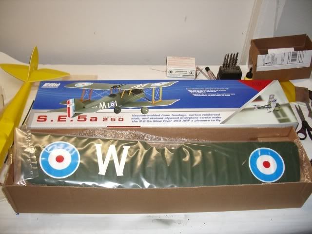

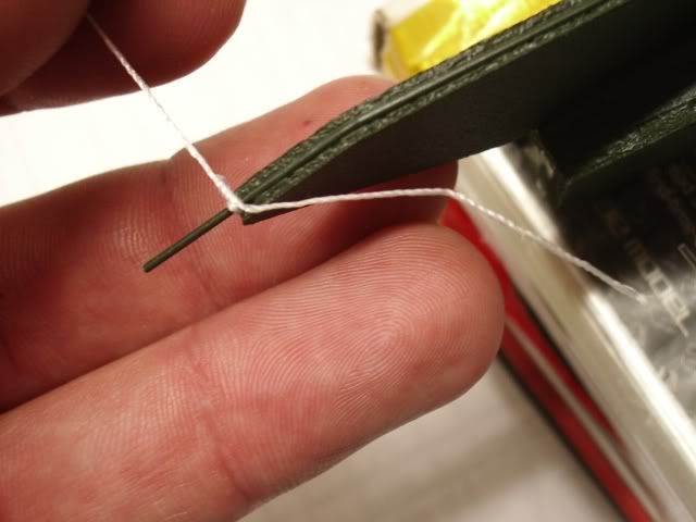

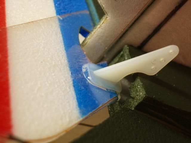

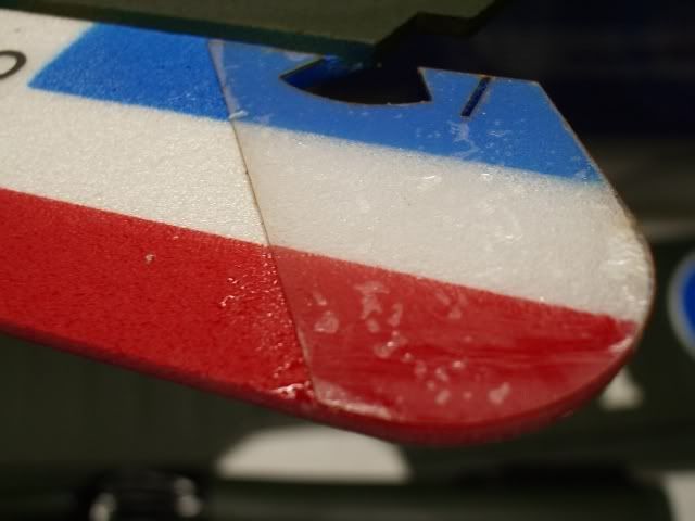

The kit showed up yesterday, but I didnt have any time to check it out
So I started looking thru it today and noticed they seemed to have fixed a couple weak spots that were present.

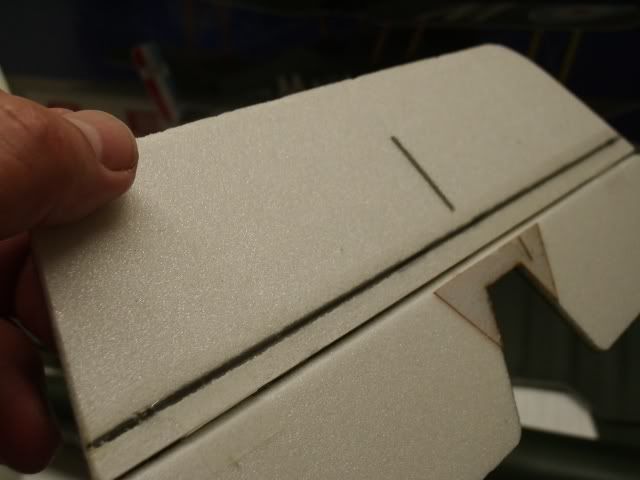

Here is a good fix on the rudder, they epoxied a clear plastic piece to support the horn :
and also a carbon re-inforced stab:

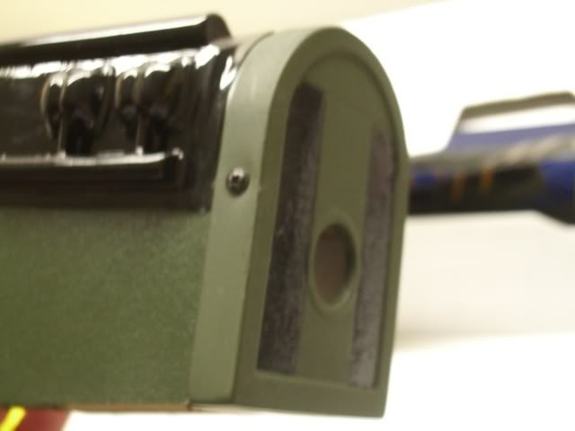

Other cool things I noticed was the cowl. They just have a faceplate screwed on the fuse, less chance of breakage -
and they even added decals under the wing -
Here the motor mount box looks similiar and there is no bottom to the cowl -

Looks like Eflite did some good QA after the Jenny. Good to see.
Now they need to work on some other planes (hint: PT-17, Camel, Fokker......)

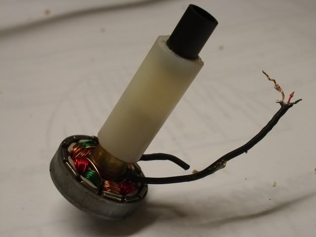

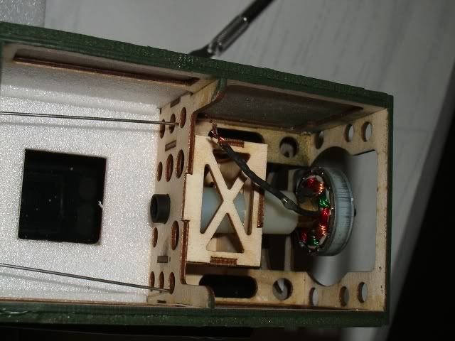

I decided to use this motor in the SE5a. Its a CD-ROM 25 turn motor I got from Randy at www.m-a-e.com. I am pretty sure it has alot more power than the eflite 250 outrunner and its alot cheaper. I'll have to configure the motor to the mount like I did with the Jenny.
Here is a close up of the motor, It was used on my 3D 6oz foamie I also got from Randy (Slick from www.m-a-e.com)

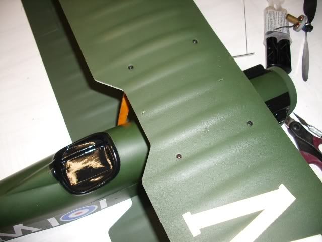

Since I cant install the motor at this time I can move onto the wings. All the gear goes up by the motor so installing the wings is no biggie.

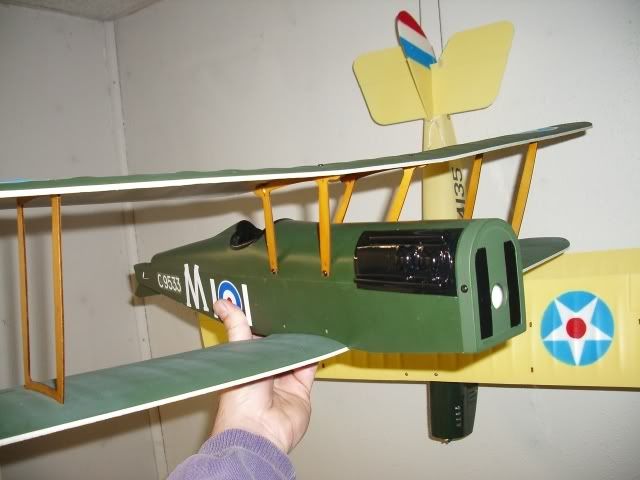

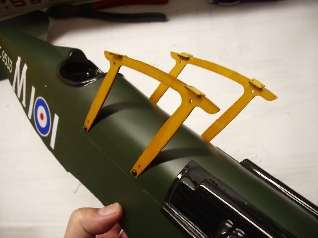

First you have to attach the main cabanes
And this is what it looks like with both sides attached -
aviatordave is offline
Old 12-27-2007, 07:27 AM
Grasshopper
Some Assembly Required
Grasshopper's Avatar
Location: Nashville, TN
Posts: 12,070
Good looking plane Dave.
Grasshopper is offline
Old 12-27-2007, 07:30 AM
aviatordave
aviatordave's Avatar
Location: Iowa
Posts: 6,233

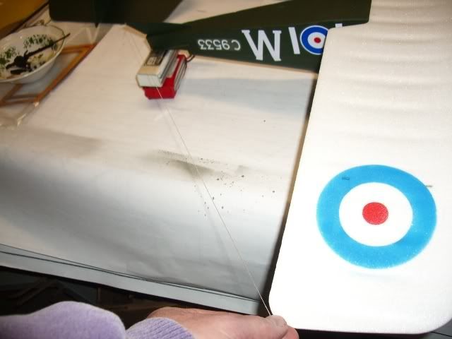

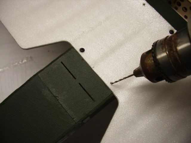

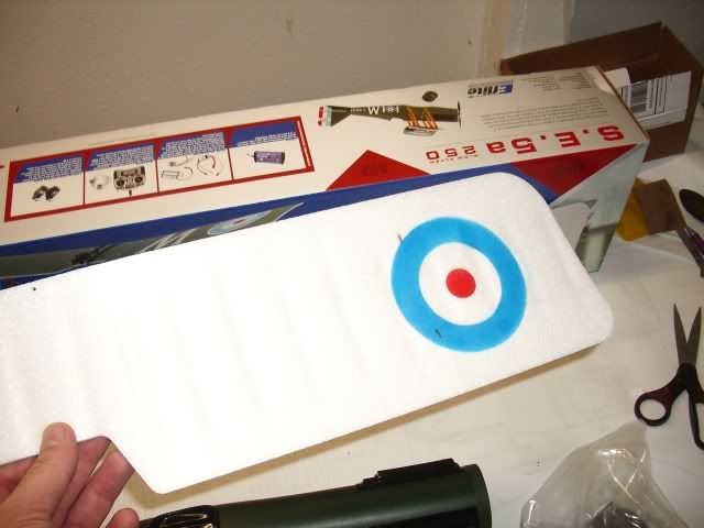

Then install the bottom wing. An easy way to make sure it is lined up properly is to attach a string at the tail end of the fuse. Make it long enough to reach the outer wing panels
Then stretch the string out at the same point on both wing halves until the length is the same
Drill 1/64" thru the holes of the wing for the mounting screws and attach the wing to the fuse
Do the same for the top wing -
Here is what it looks like with the wings attached -
Thats all until tomorrow -

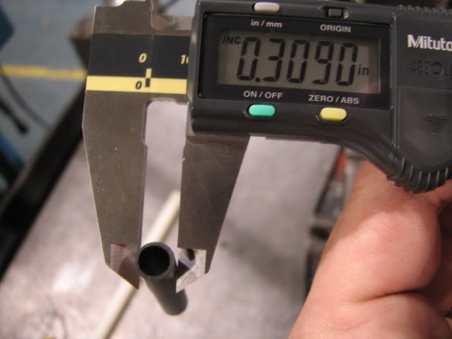

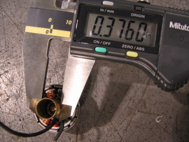

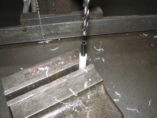

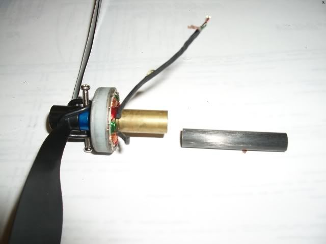

The motor is next and this is what I am dealing with. The EFLITE carbon tube is 0.309" as shown -
The shaft of the outrunner (CDROM) is 0.376". So I need to make some adapter to accomodate...see pic -

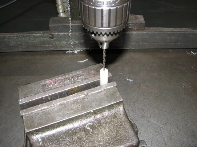

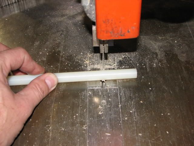

First I cut off a piece of nylon stock we have in the shop. (Anything will work, even balsa block).

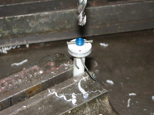

After I find center, drill a small pilot hole for the larger drill to follow.
After drilling the larger hole, I test fit the carbon EFLITE tube.
Then I turn the piece around and drill for the CDROM Shaft and test fit.
Cool...thats done

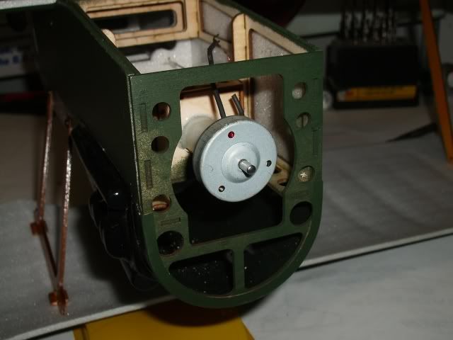

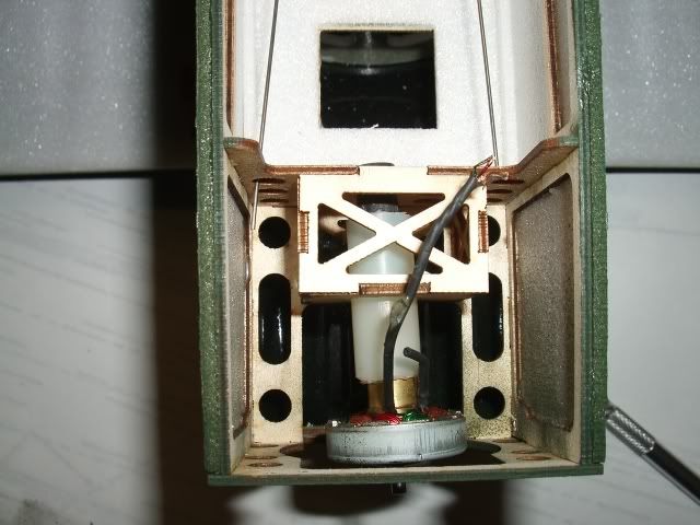

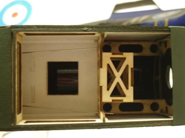

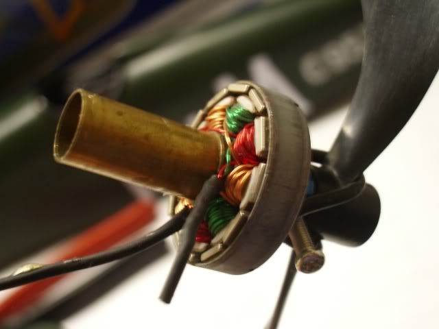

Next I need to install the motor. This is what it looks like before installation, I trimmed the EFLITE carbon tube and nylon tube for fit.
Here are a couple views showing the new tube and motor in place -
And.....
And...
This is the glue I used to hold the motor tube together -

To get the CDROM motor to fit decent you will need to trim some fat from the cowl. No biggie as it doesnt need to be there anyway.

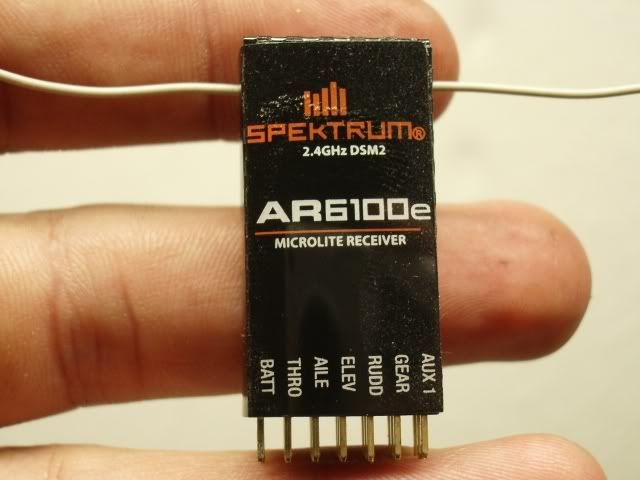

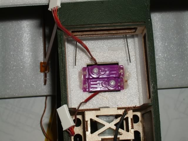

Here are the servos I will be using, also fro www.m-a-e.com , they are 6 gram servos with 12 oz/in torque.
and of course for control I will be using the new AR6100E (www.toddsmodels.com) with my DX7
Here is a pic of the servos installed, for something this light you can just use a hot glue gun. (Wilburs favorite )

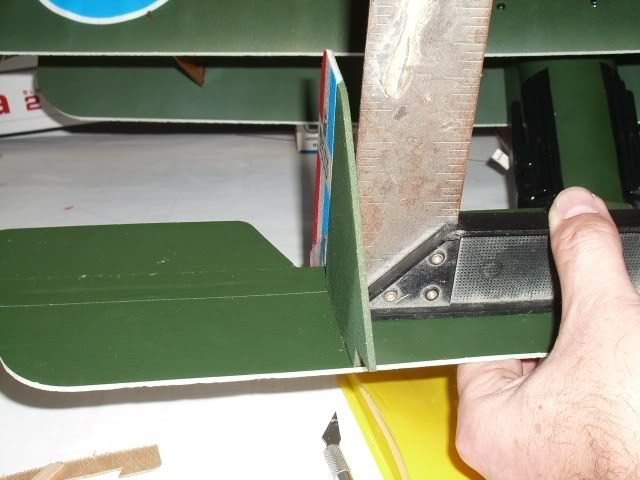

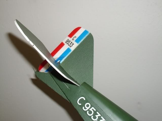

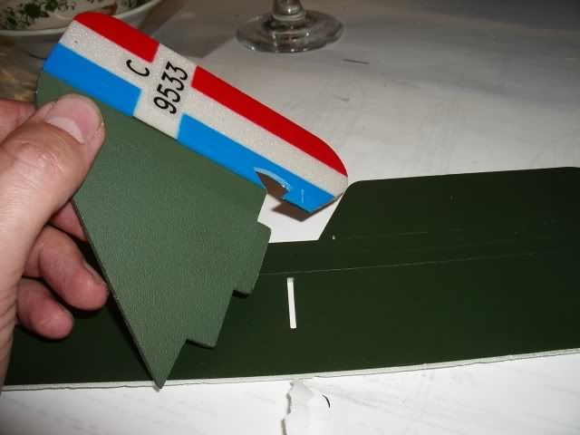

Tail assembly is next, everything is slotted, just make sure to make it all square.
And here is the finished tail assembly -
After that install the control horns on the rudder and elevator -

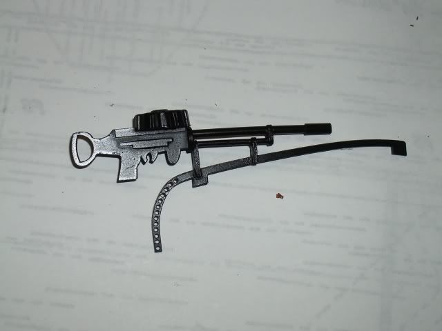

of course...what is a WWI fighter withought a machine gun?
