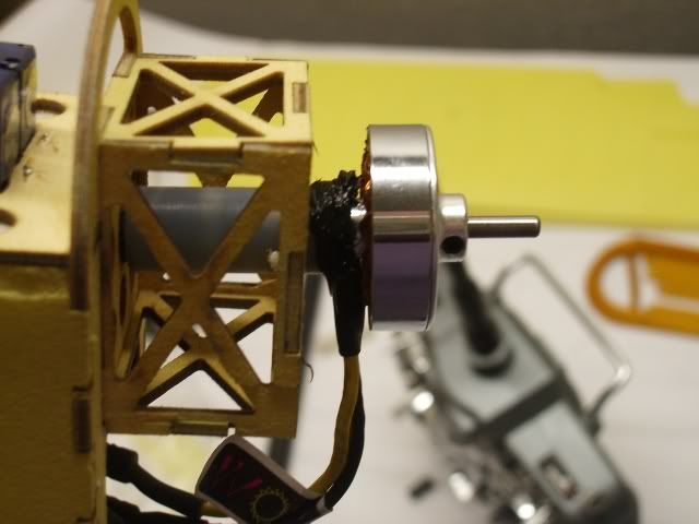

Here is the new AR6100 rx with the end pins, much nicer to work with IMHO.
Installing the motor..dab some generic grease on the bearing since it will be RTV'd to the tube and we dont want any sticky stuff in the bearing...
Here is the tube I used and the black RTV. This particular RTV is used in the manufacturing of circuit breakers and bonds plastic to metal well. I 'borrowed' some from work
