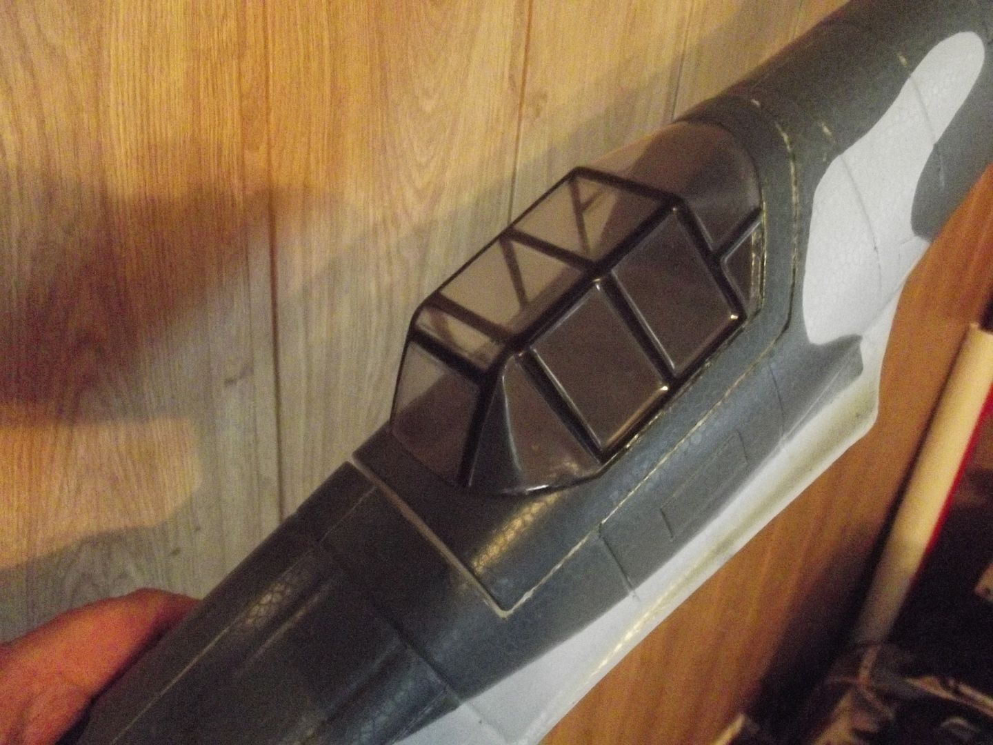

canopy to fit ..

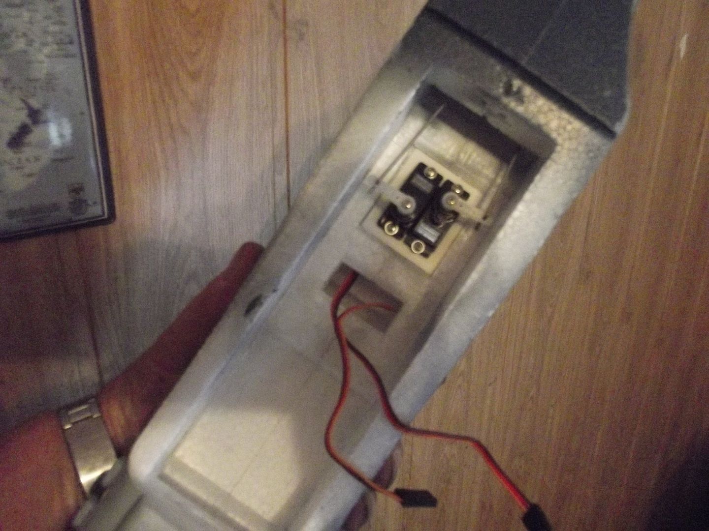

Underside in wing bay for servos :

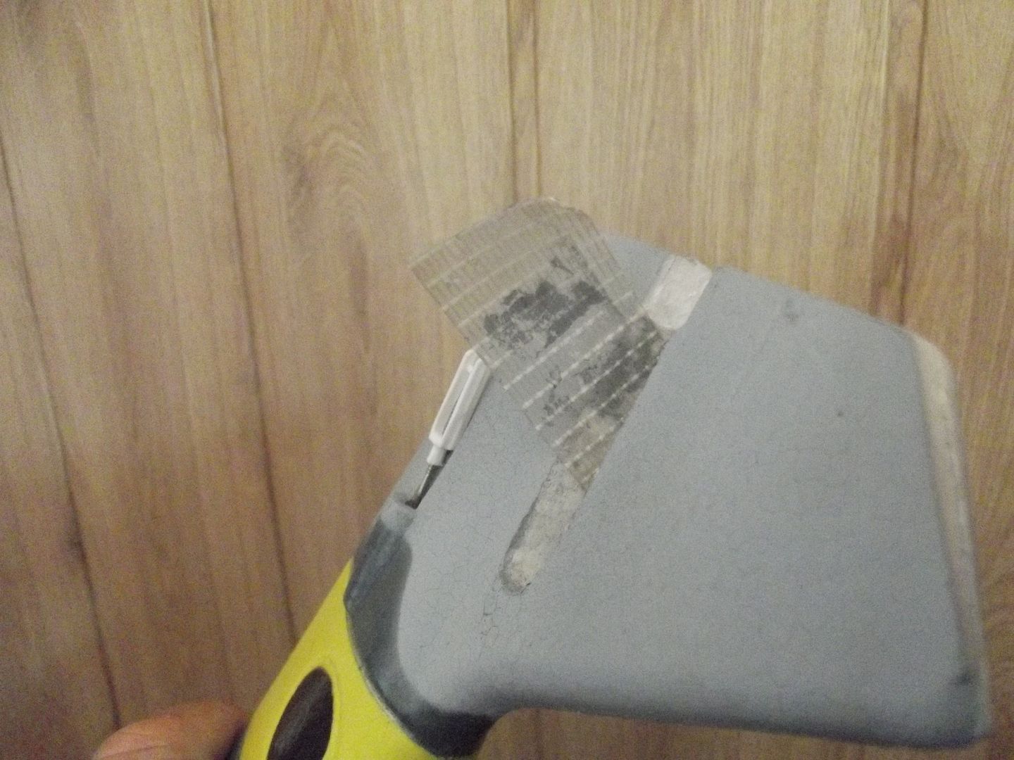

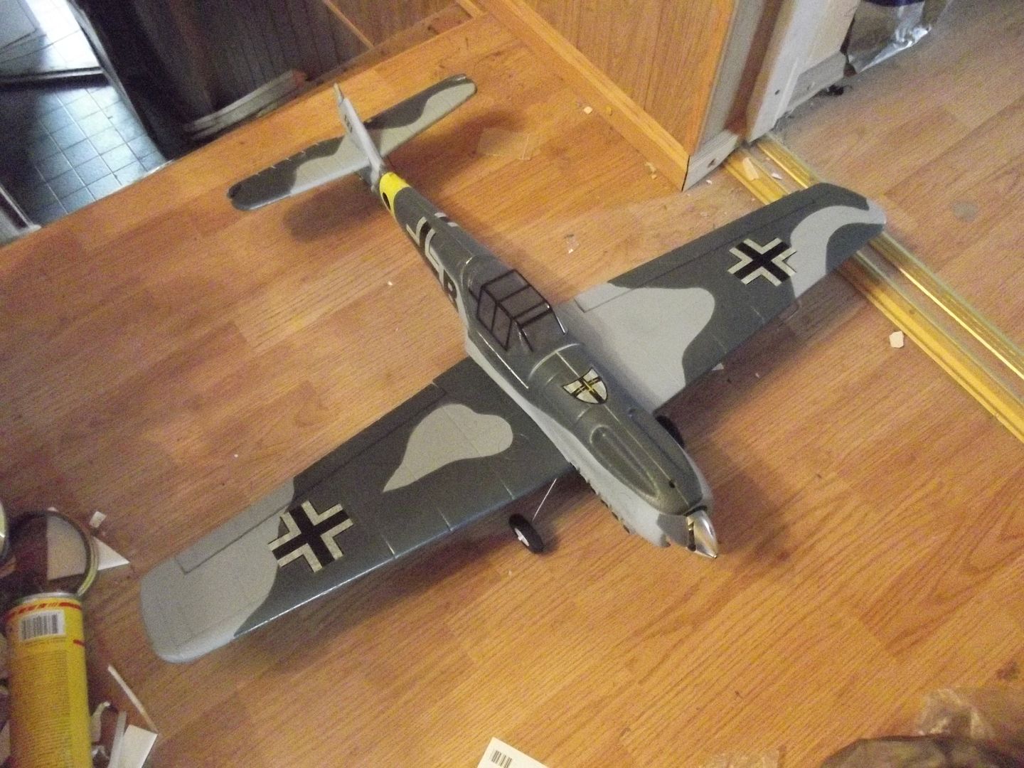

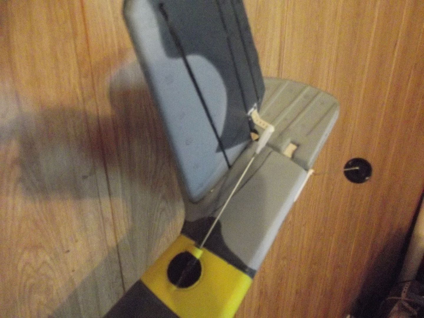

First that tail area ... cut out the small filler piece ... then scrape away the paint to get a good glue joint. As we all know ... the paint used is not the best and judicious use of tape can remove it ...
Tail stab / elevator comes as one piece ready to fit ... clean up paint area again .. epoxy and slide in place ...
Note the use of cocktail sticks and band to pull the joint together ...
Couple of MG 9gr servos with the Z bend rods supplied ..
Horns are glued and clipped by a friction plate on other side ... rods have nylon clevis supplied. (I remember mine didn't last long before - so later will swap out for quick links etc.
Silly me ... forgot to put a pilot in ... will carefully remove glazing later once I have 3D printed my 'boy' to put in there.

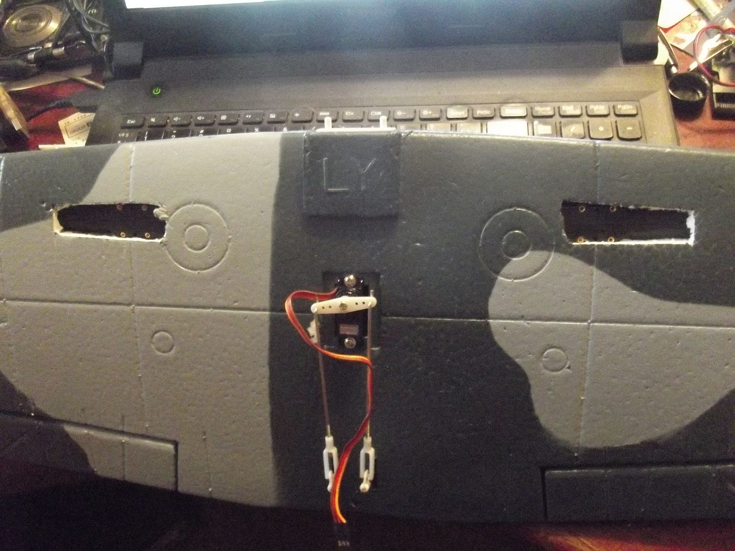

Traditional torque rod ailerons ... single servo. My older one - I eventually fitted split servos ... but this will suffice for now ... again a MG 9gr servo ..
All fitted in ... I changed to a 2826 1400KV Turnigy motor fitted to the post mount supplied. I had to use my own post glued in though as I cut the supplied one to fit a different longer motor .. so was too short.

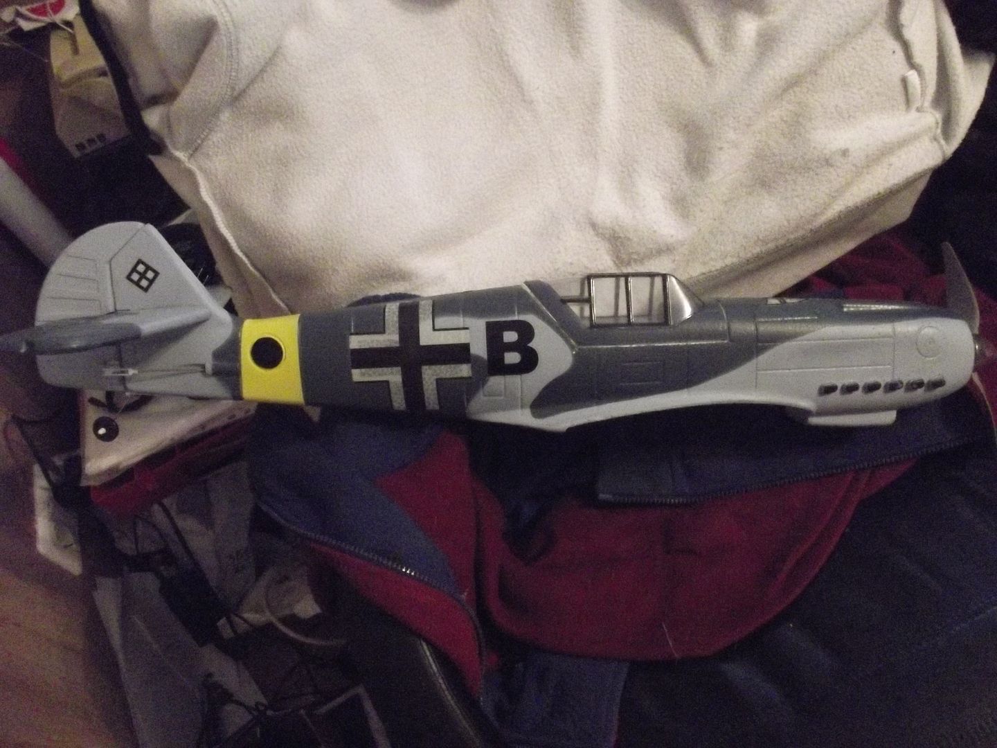

Spot the mistake ? I put wrong decals on fuselage / wings ... the smaller ones should be on fuselage and larger on the wings !! Too late now ...
With 1300 3S ... 2826KV 1400 Turnigy, 8x6E prop, 40A Aerostar ESC, 7ch FrSky installed .... total is 490gr ... well below what I expected ........... AND she balances on the spot !! I have fitted the silly cartoon fixed U/C till I receive my retracts ...
I may prop back as I know she was well powered before ... and was actually designed as a 9.6V Brushed geared setup. She flew as well !!
Well pleased ............

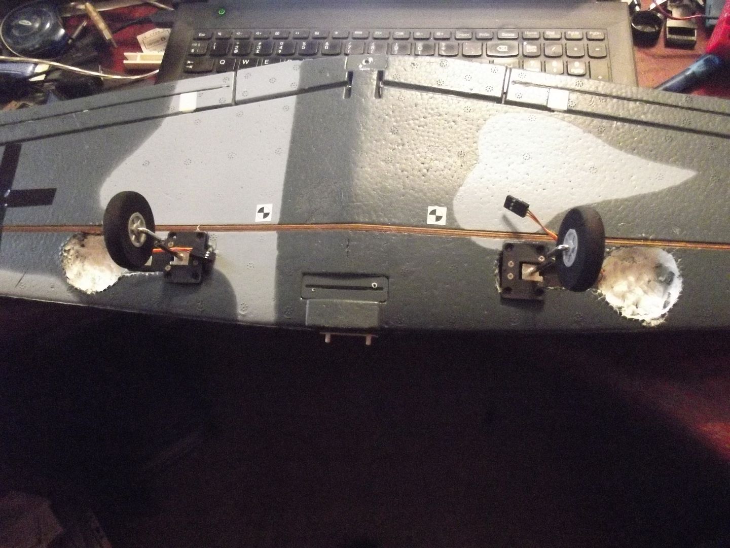

Retracts .... got the smallest I could but still a little on the deep side for the wing.

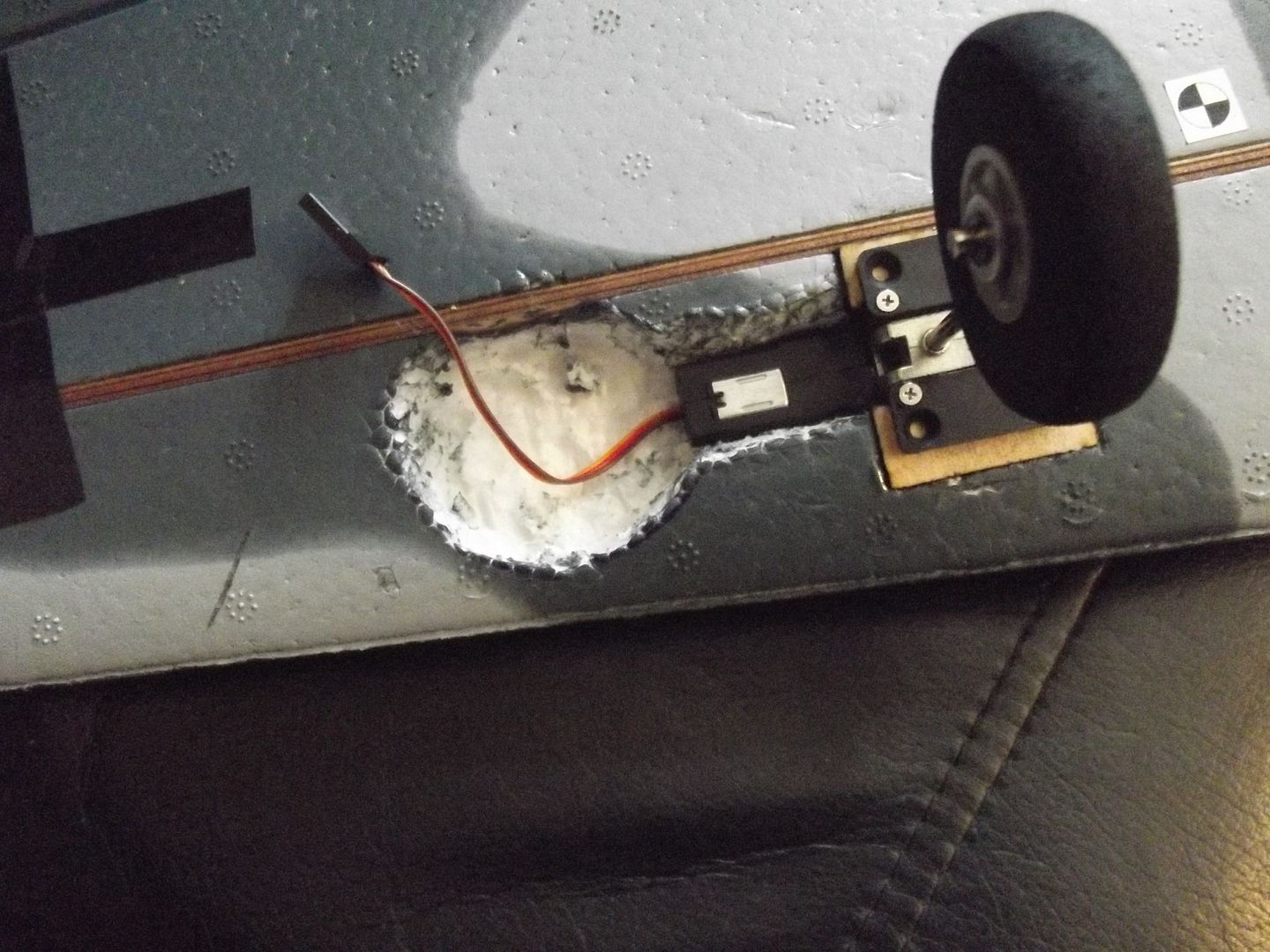

Solder iron and hot-cut the mount / wheel area ....
By time I had the servo body in - I was already partially through top skin ... so decided to cut out sections and will fill in later once retracts mounted fully.
Yes I went for ME109 fold outwards ... avoiding the smart alek on the field pointing that out if I make the fold inward !!
Can't decide whether to try create ply mounts ... I hate these as the mount screws are so near the edge and you have to make indents for the servo body screws ! .... or to just glue them in permanent. Trouble is the legs have the set screw flats 90deg out ... so i'll need to get at the set screws at times to straighten the wheels.

OK ... I ran up the Laser machine ... quick scan of servo unit to JPG ... vector the shape to cut out ... in 5 minutes had both servo ply plates and epoxied in ... 30 mins later all screwed up ... leads led on surface as the retracts are reversed means leads exit outboard and need to be fed back.
Anyway ... all in :

Here you can see the crap fixed jobs :
But this one - because we have Cirava with paved runway ... I thought it would be nice to have them. They don't go true flush when up as the wing is not deep enough ... but should be ok wheels up onto grass.
I haven't fitted fairings or anything ... its just bare legs and wheels.
