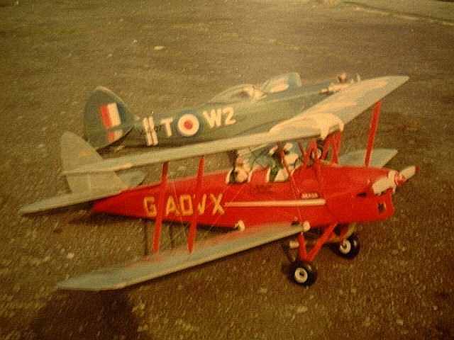

Old 04-03-2016, 08:39 PM
Ron
Location: Chilliwack BC Canada
Posts: 692
The Tiger Moth had it's maiden flights yesterday in somewhat less than ideal conditions, but I got tired of waiting. 15 mph cross wind, and gusting. ( but the sun was shining ) :-)
Takeoff was easy, the tail came up almost instantly, and she was away into the wild blue. Surprisingly the wind didn't really bother it ...no trim required, and balance point felt good. Landing was a matter of lining up with the runway, and letting it settle into a three point....Naturally a lot of wind correction was required, but I am happy with the model to this point, and would recommend Gary Allen's design to anyone who wants a really good Tiger Moth...I feel it is the best flyer of the five I have owned over the years.
Soon as the gale subsides, we'll get some footage to post.
