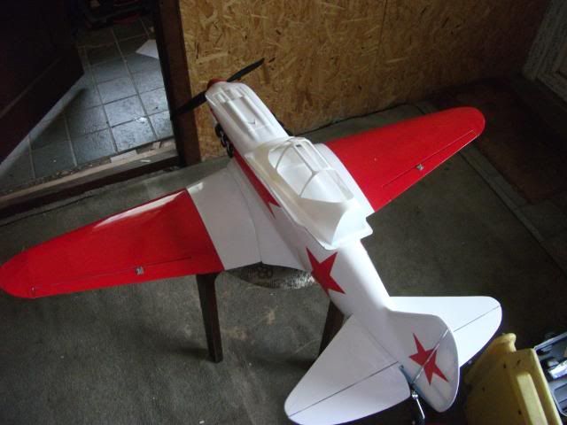

I should stay away from Model Shops ........ had to drive to Riga yesterday and thought I'd drop into the only real model shop we have in Latvia.

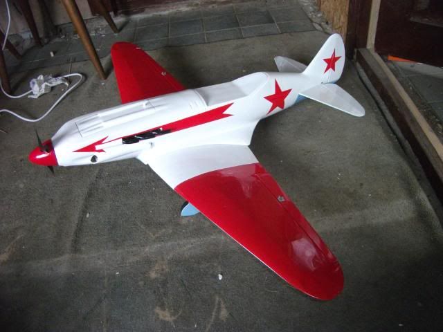

Came out with this kit : (built her last night - just need to fit canopy and radio gear) ....
Just over 1m span, touch over 1kg AUW, 3836 1000Kv motor I fitted and 10x6 prop with 11x5.5 back-up. Spec'd for 3S 2100 LiPo
Choice was military version or the Soviet Sport version I went for ....
GRP fuselage, wood / film wings, wood tailplane. Not a bit of foam anywhere ....

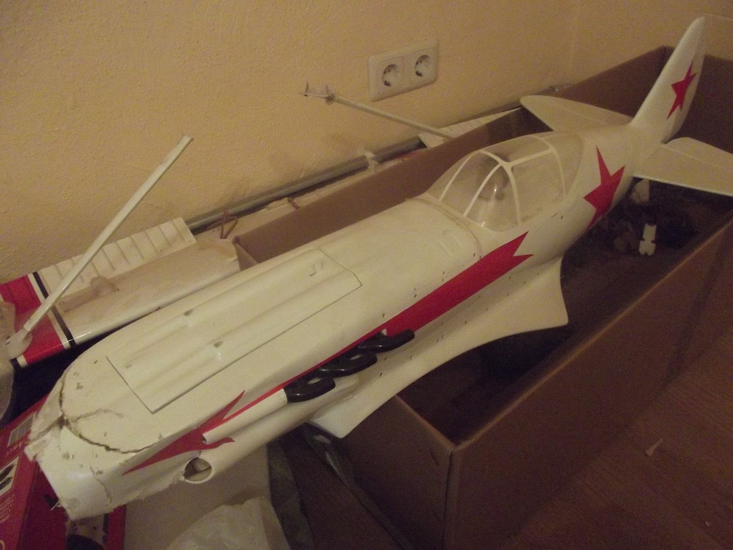

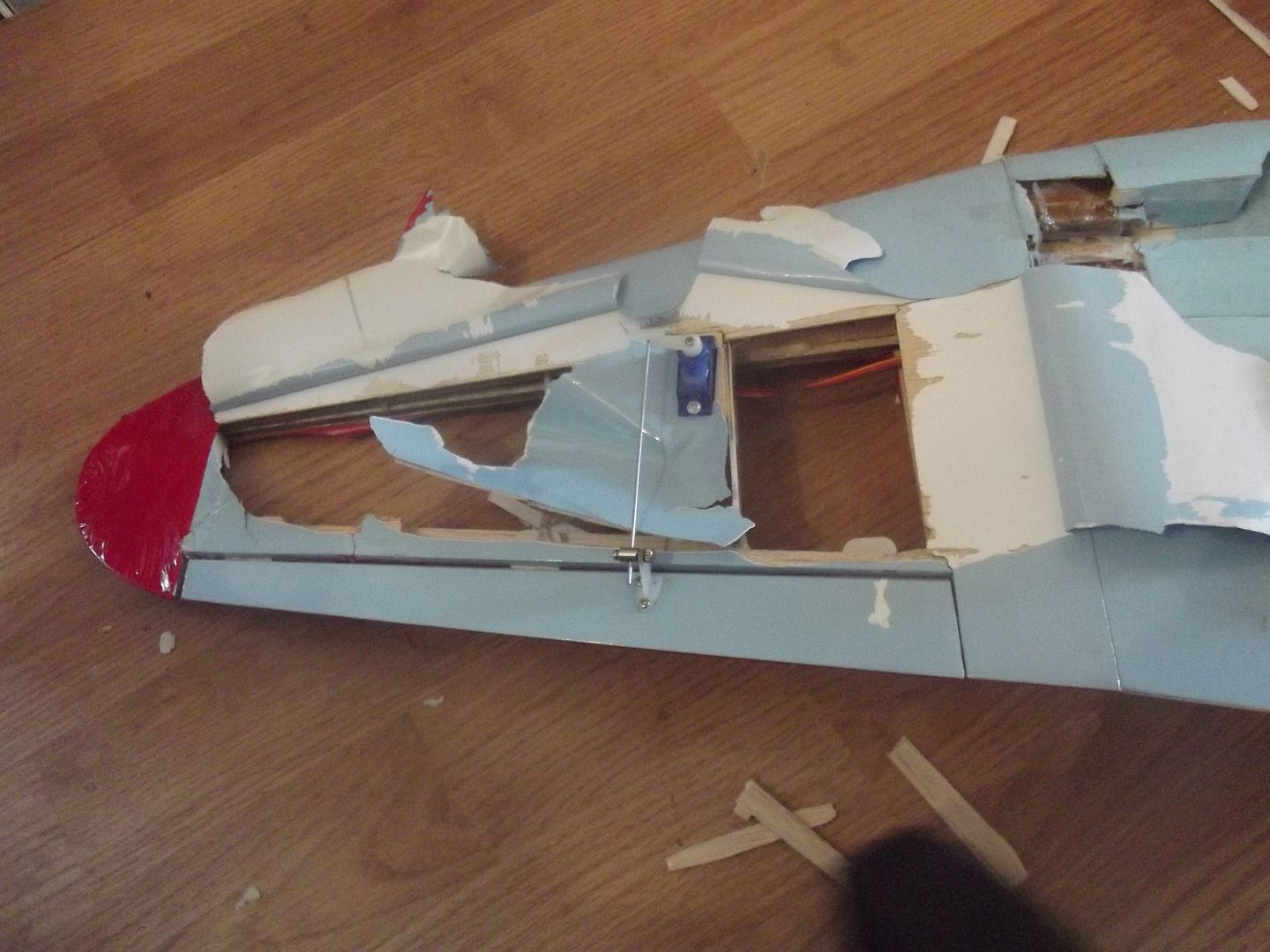

Long time since I bought this model ... nearly 8 years !!
For last few years - its sat looking sad having had another of its crashes.
It really is an unforgiving model ... she will snap as quick as anything and no way to get her back.
Guy on RCG has just 3D printed a Mig 3 and its re-kindled my interest ... the wing looked so bad - even I had my doubts .. I'd removed the retracts to fit to my Mossie (that's crashed due to my flying longer than batterys could !) so I may put them back.

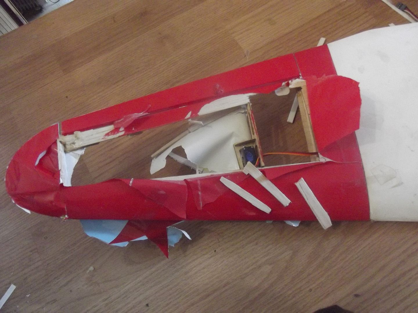

The wing actually is going back together without too much trouble ...
As you saw in end of video - that wing was smashed ! The magic of CA and then backing up with PU glue to create fill-in has restored that rear edge ready to have some strip sheeting applied from my scrap box ...

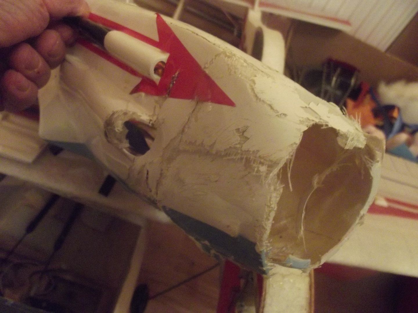

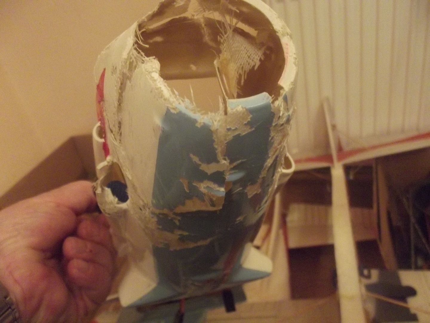

The fuselage is mostly in good condition - only the nose section took the major impact with that right wing. CA and again PU glue to get it back into shape ... then resin filler to fill and strengthen the ruts and holes ...
Then once all done ... she'll be ready for her next crash !!

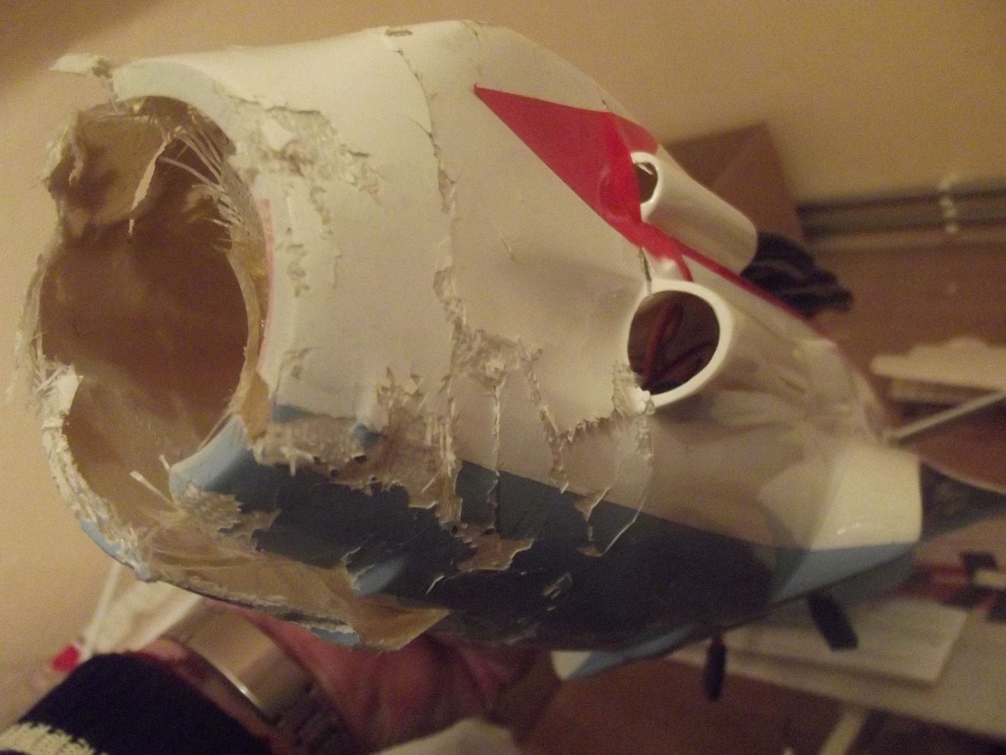

That nose is pretty banged up and out of shape ... wing is near finished structurally ... just needs laminate another set of thin ribs to the ones I spliced in. Originals were lite ply - but because of need to shape etc - I used balsa ... now I will give another balsa rib alongside with Epoxy - that will create a strong rib ...
The nose is tacked with CA at moment and held with tape ...glass fibre work on inside to reform and hold ... then remove tape ... car filler on outside to try and get some cosmetic improvement / fill the cracks etc.
Still haven't decided on refitting retracts or not ...
