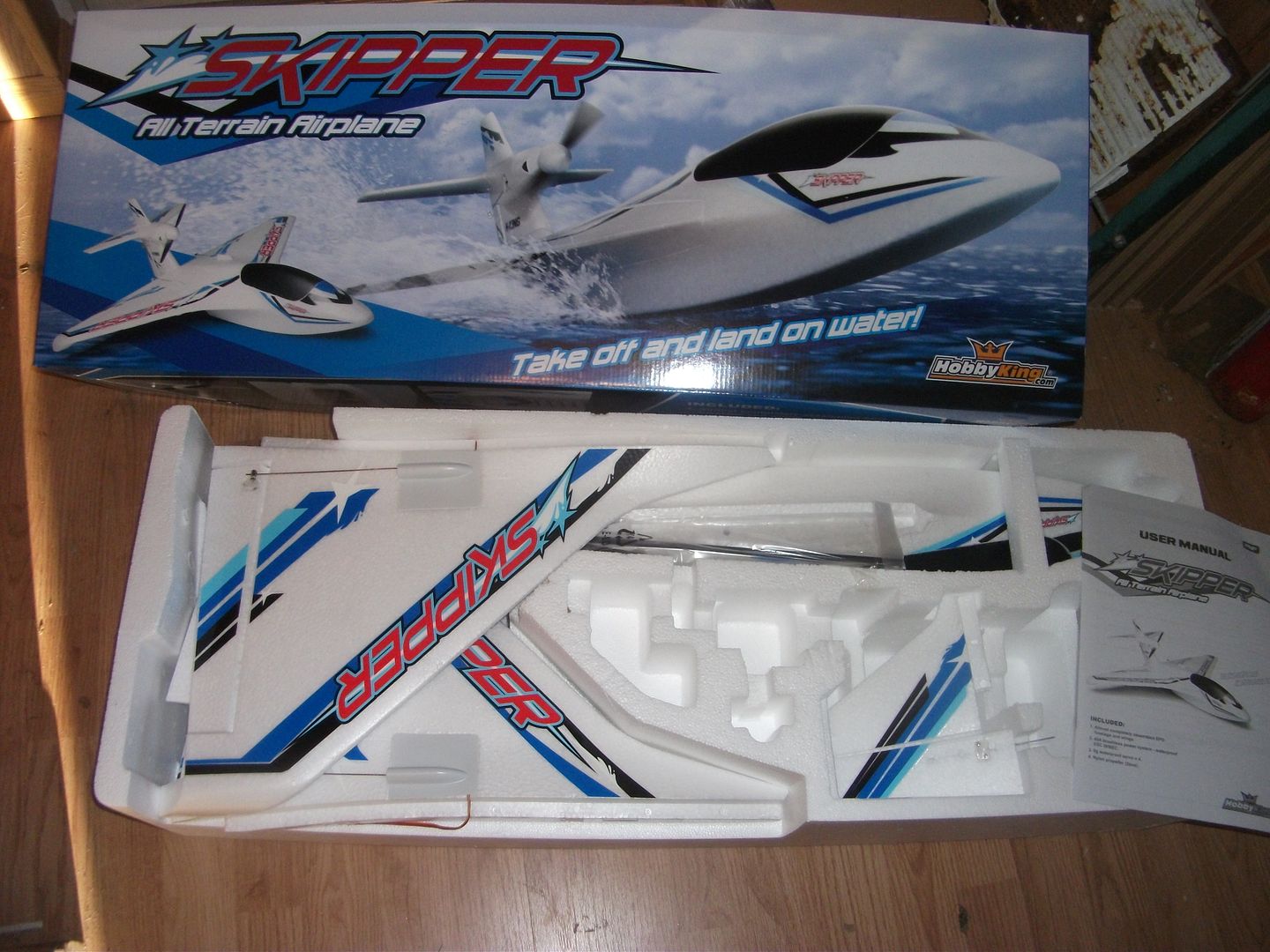

Double box arrives ...
Inside is original box with ends protected ..
Lift out and open ... becomes obvious that this is actually a PNF version of an RTF .. the Tx spaces are in the packaging foam ..

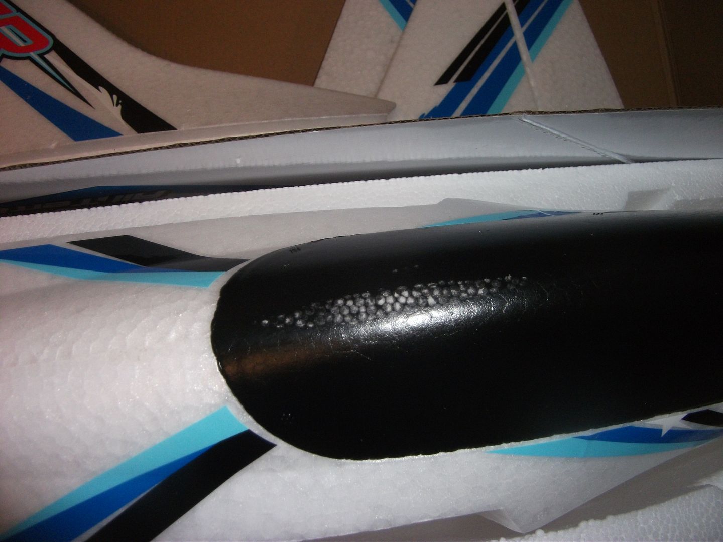

All pieces checked over ... only remark is the scuffed bit of black on canopy .. most likely from lack of lacquer applied as foam is unmarked.

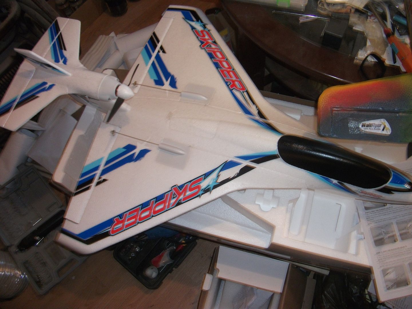

Putting it together took me about 30mins ... and most of that was figuring out the tailplane bit. There's no instruction how to fix the two parts ... so I dug out my glue and glued them in.
Wings are held by Double sided tape ... works a treat - I cannot pull any wing out now !! I used UHU Por on the tail plane parts and the supplied tape to join the elevator halves.

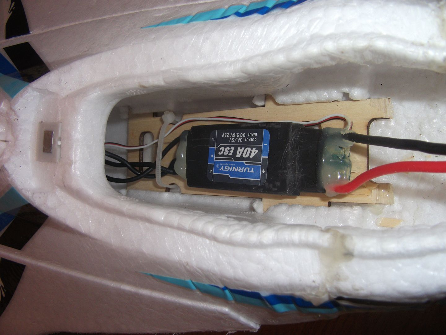

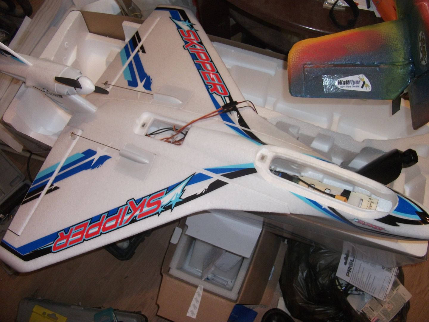

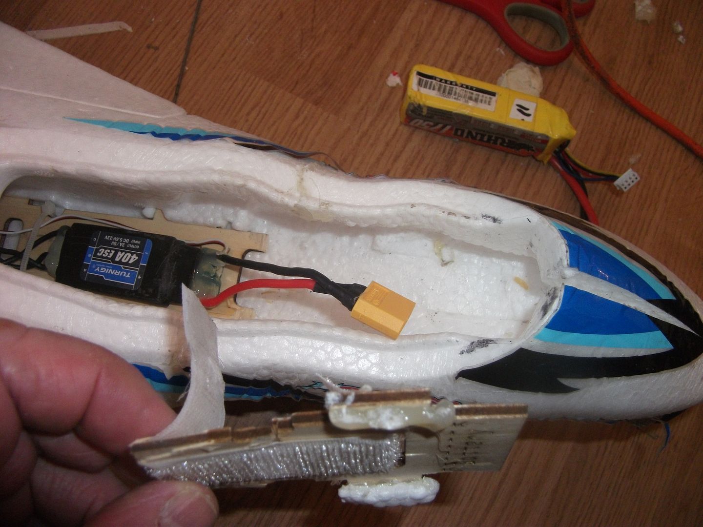

FrSky Rx and 1750 in the bays ... a tape tab added to the Rx bay hatch as that one is VERY difficult to open against the strong magnet.
With the 1750 3S ... balances on the step ... which is not a bad place ... manual says CoG 10mm behind step ... so a smaller LiPo will balance fine.
Only servo that needed reversing was the elevator. And calibrate the ESC. I didn't use the balloon ... as I usually just wrap in clear Clingfilm ...

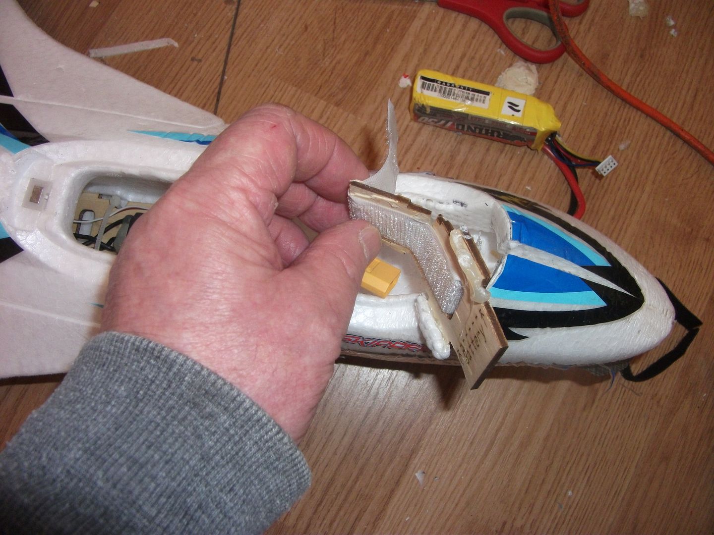

BIG mistake !! She took off like scalded cat and while trimming - I just could not see her as she flew away ... I got odd glimpses of black stripes ... tried to bring her back but lost orientation on her ... in she went. Snapped of nose ... broke battery tray.
20 mins work with hot air and glue ... she's ready again.

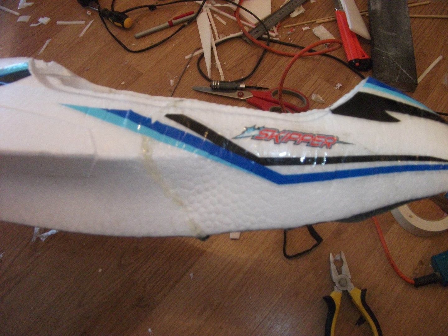

Ok here you can see the joint made when nose broke off first time :
The scrunched up nose is the second crash !!
Anyway ... the second crash concertina'd the nose ...
Shattered the battery tray again..
So liberal heat and stretching ... bit of remodelling of battery tray ...

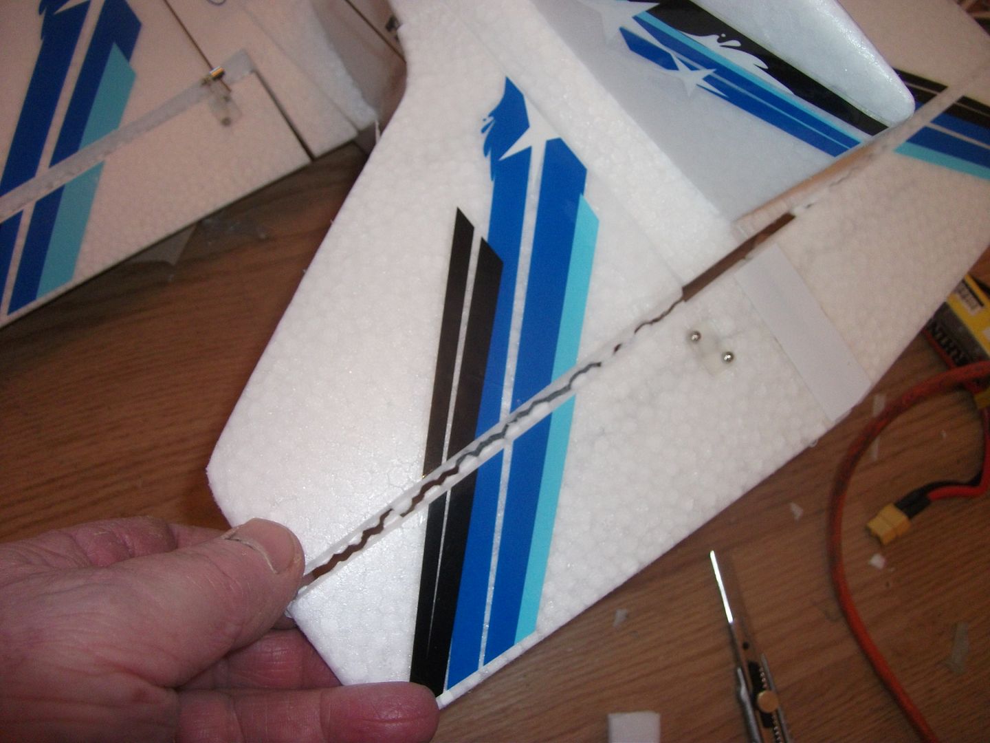

But now I know why she failed to pull out ... the cold must have made the elevator foam hinge brittle ... once repairs made - I was testing and checking her over and noticed the light through the hinge line !!
So knife through rest of it ... insert decent mylar strip hinges ...

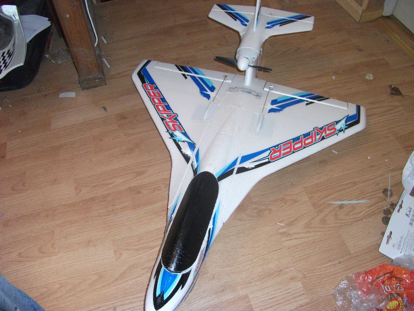

I'm still considering altering colour scheme to get her more visible in the pale winter sky ...
The Factory scheme Top :
I have added some more black underside to try and help ..

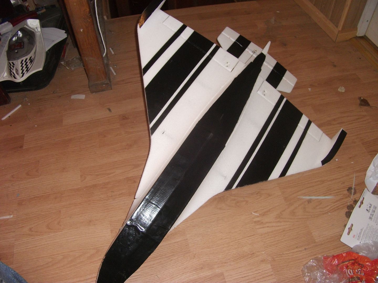

Old 01-05-2016, 01:19 PM
Posts: 12,370
So a quick addition of some vinyl tape to see what happens in the air ...
If the scheme works ... then I will remove the tape and do it properly with paint. So charging batts now ..

Well the scheme works a treat ...
Sadly I put a 'spent' battery in and only got a short flight. It was -10C as well ... so good excuse to pack up and go home to warm fire and hot toddy !!
