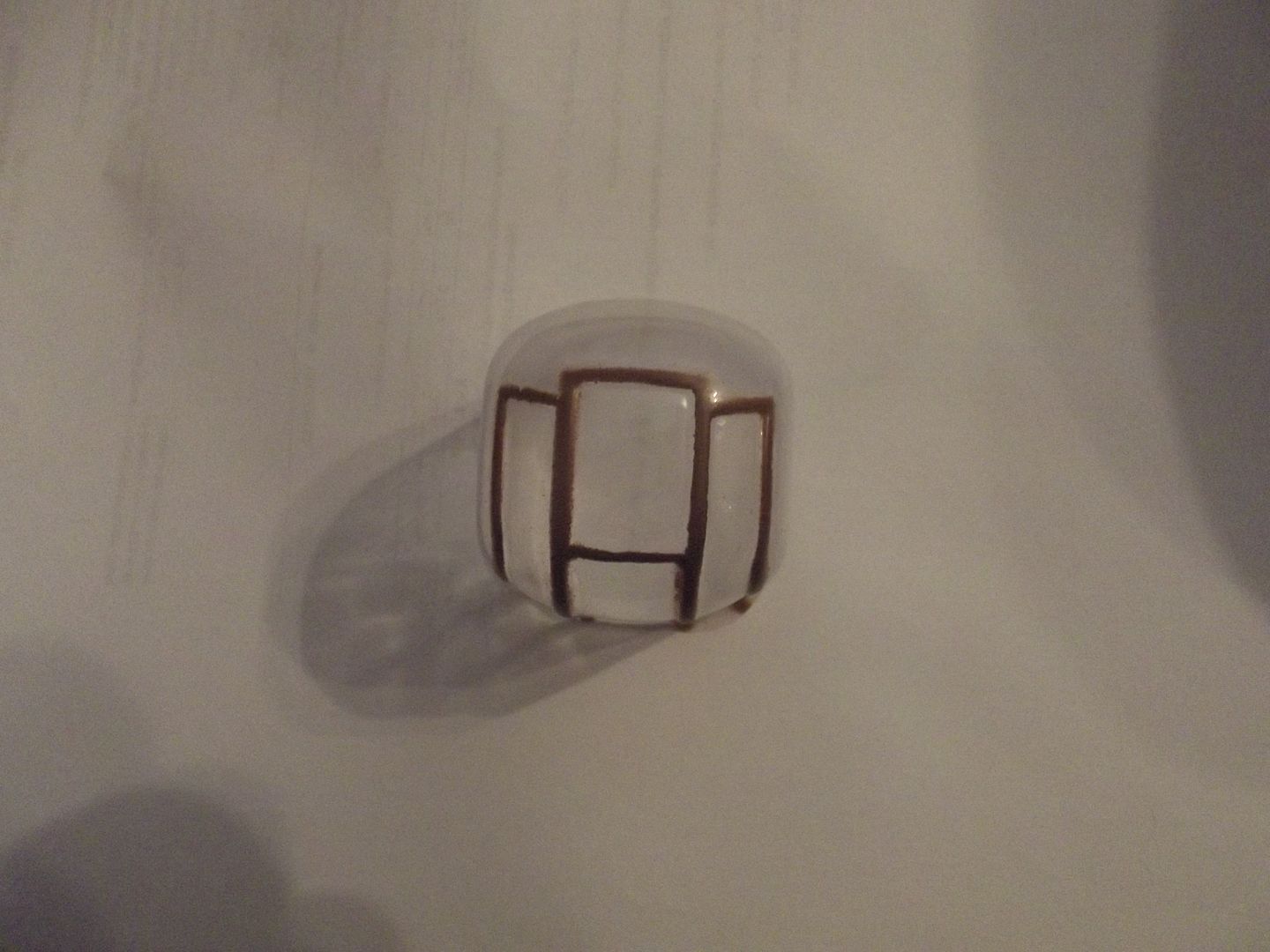

OK.... I have a complete spare set of HK Lanc plastics ..... so I am now experimenting to see if I can cast Plaster in them to create plugs.
First is the Tail gunners turret ...sprayed with Silicon spray as a release agent and then plaster poured in.
A ply stick as a handle of course.
The 'radiator' is not on ... its purely its close to the sink /water supply. The bottle of course keeps the turret upright while the plaster cures.
Fingers crossed I haven't ruined my spare turret !

Not easy getting plug out even with the pliable plastic .... air cannot get in behind ...
But it worked.

I tried the 'external' casting but it was really only good for very small item.
So I went back to pouring into the item to create plugs. The Baby Oil really made a difference instead of the silicon spray.
Here are :
Cockpit canopy Hk Lanc :
Front gunner :
Upper turret and bomb aimer :
Tail gunner :
All with plywood holding sticks in .....
Now to learn how to hot form the plastic bottle over them !
