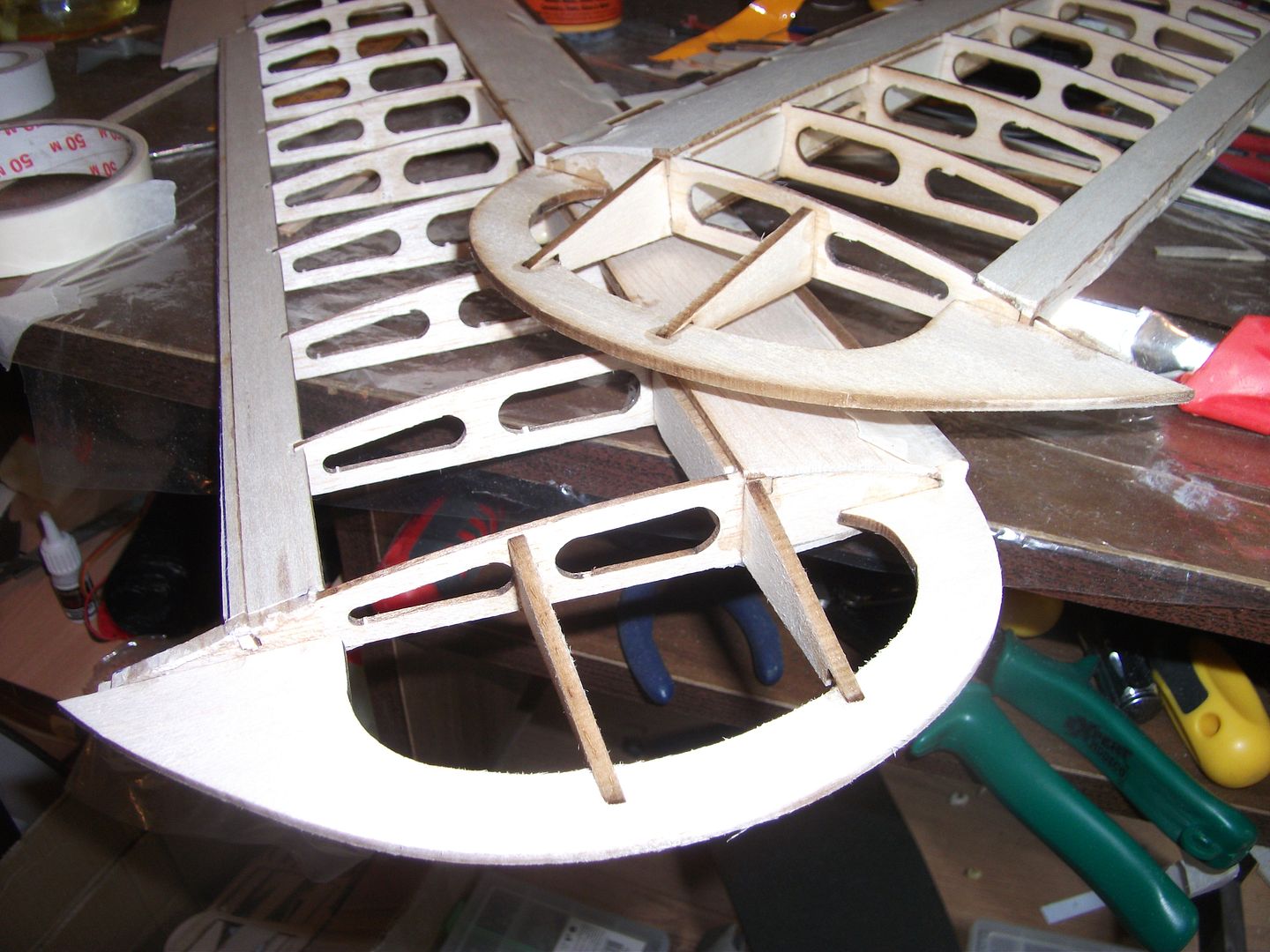

The HK J3 in fact is a nice looking model - its just the build of it needs thought to sort the areas that kit factory forgot about !
OK ...

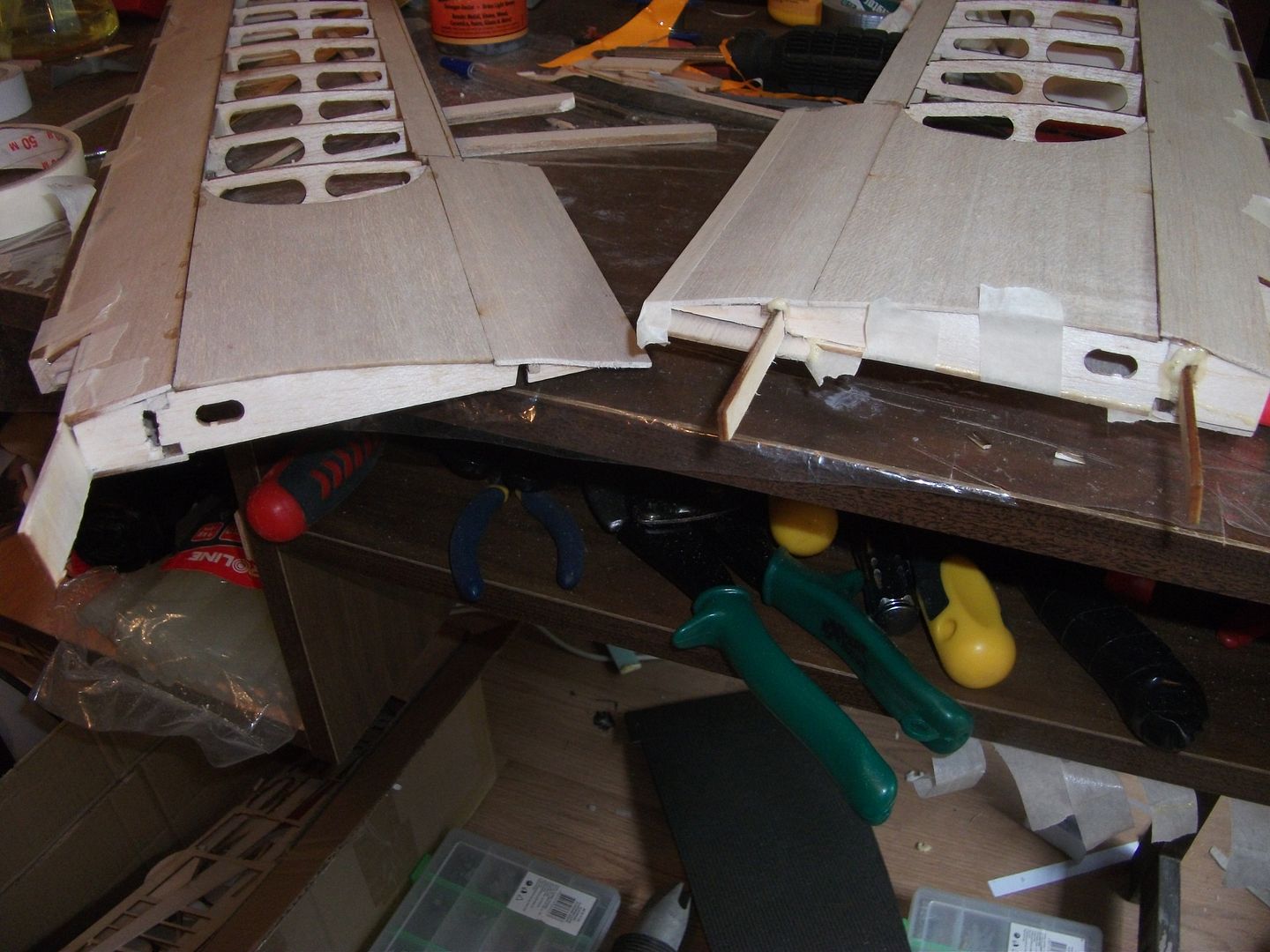

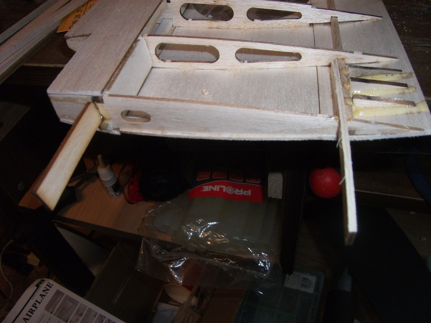

Ailerons cut out ... again another area that needs sorting. They give you excellent hard stock to face them with - but that adds 6mm to the width ... so I cut of that amount from the TE of them .... then glued the facing on.
Here's where I sorted my interpretation of braces ...

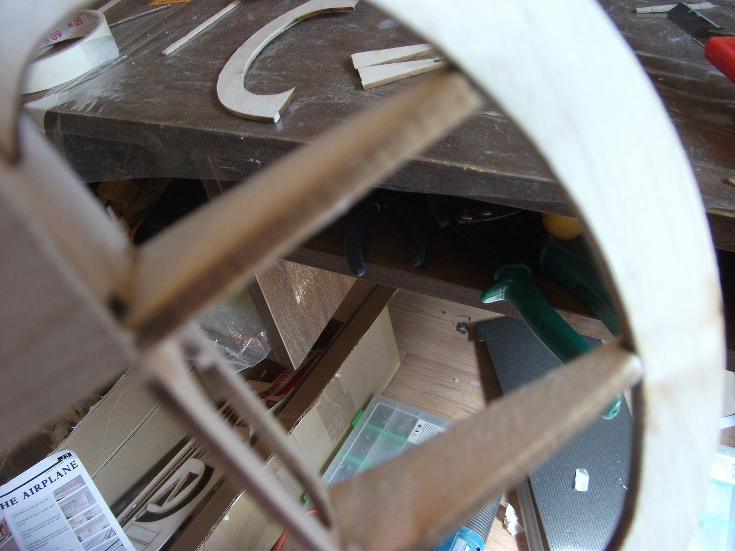

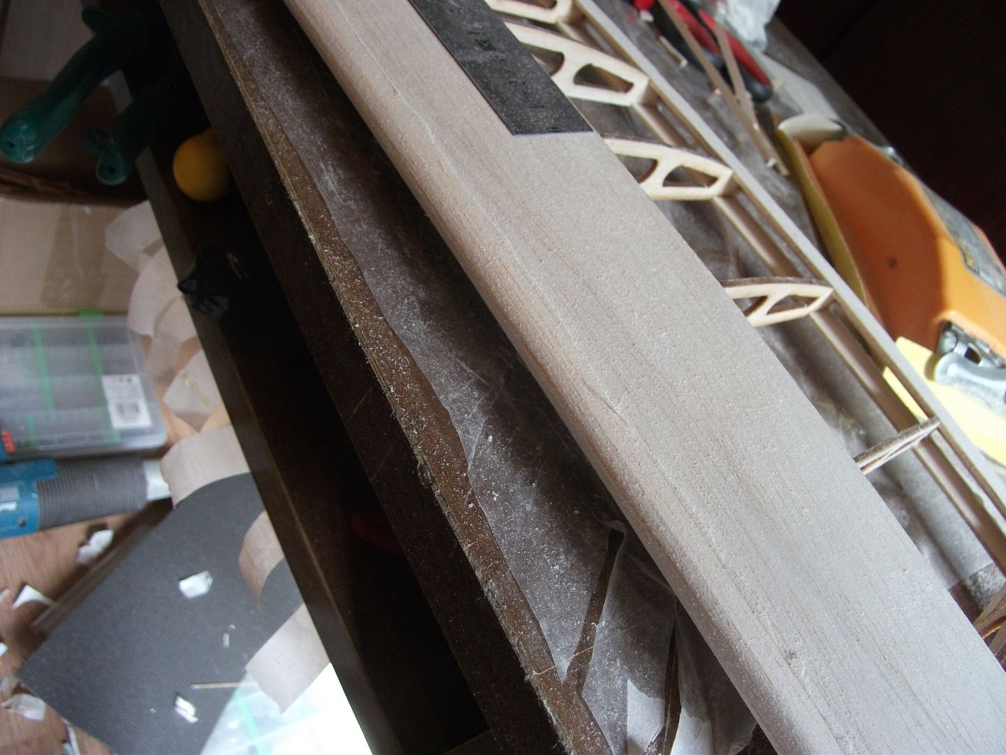

Wing tips ... they do not line up if you use the gussets as supplied ... so I tacked the curved tip sections in place ... then trimmed the outer of the gussets ... glued in place ...
So other ends with braces about to be joined ...
Wings joined and glue setting ... gap in centre due to slightly out of line ribs ... typical of me !! Will be infilled ...

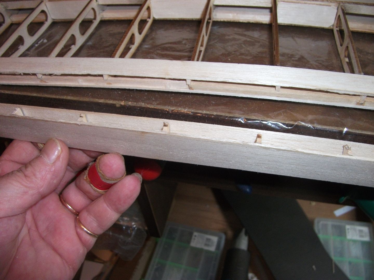

Leading Edge sanded ...

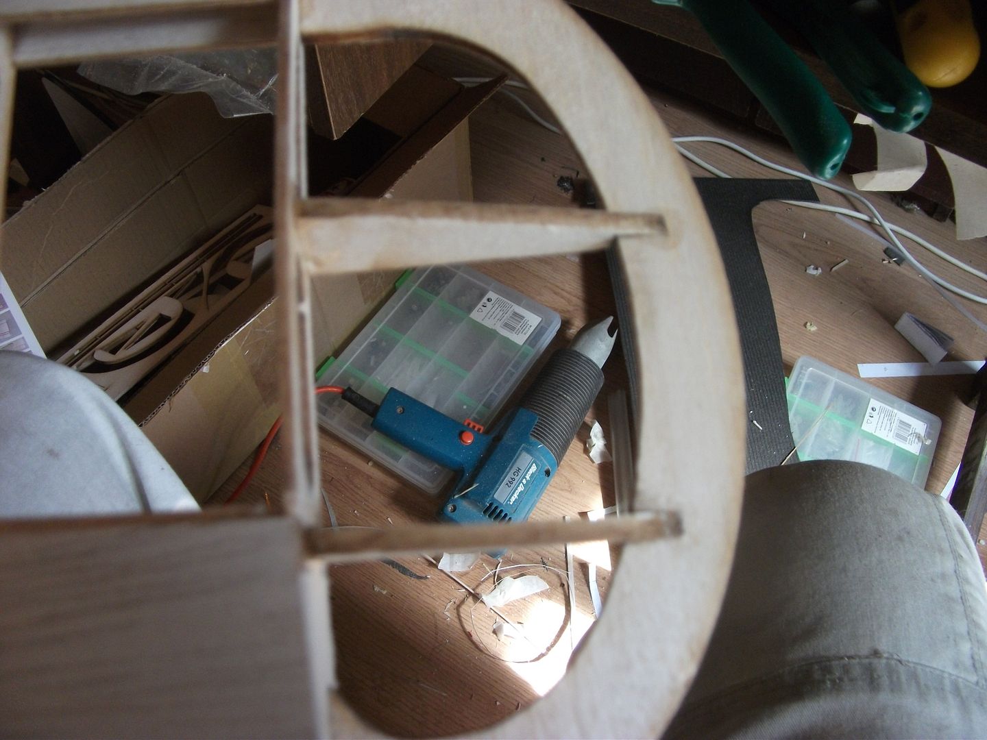

The problem is how to fix the glazing in place as the sides and formers are not all same level etc. They will have to be surface mounted on outside ... not my favourite way.

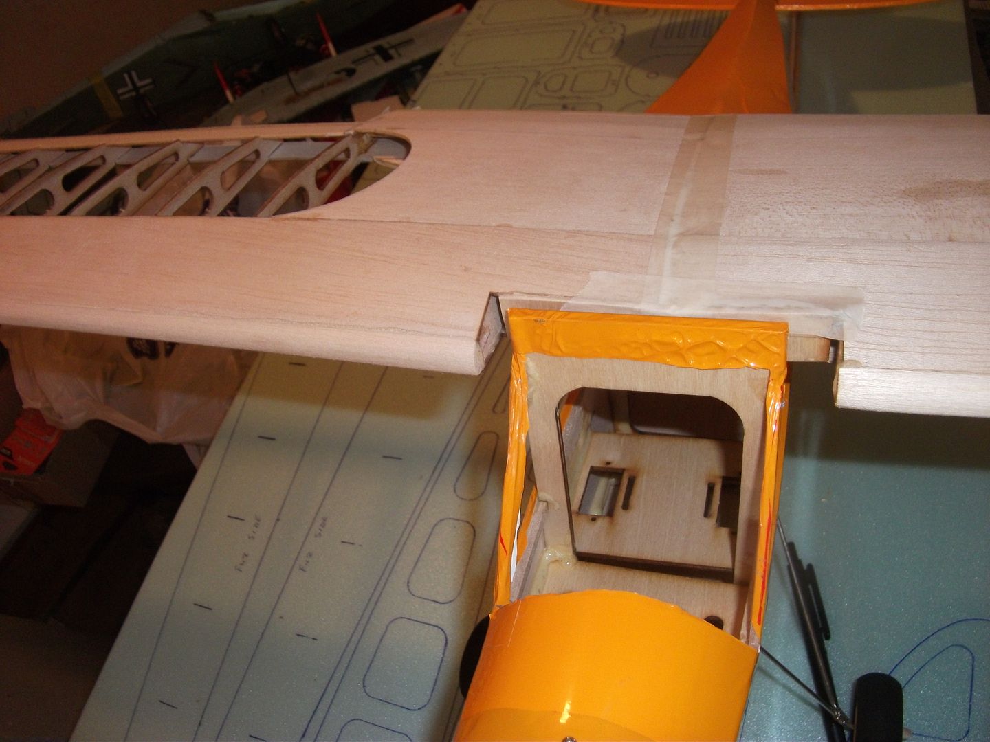

Moving on .... here we see the too large a gap in front of wing ..
So scrap infill ..
Sand it back ..

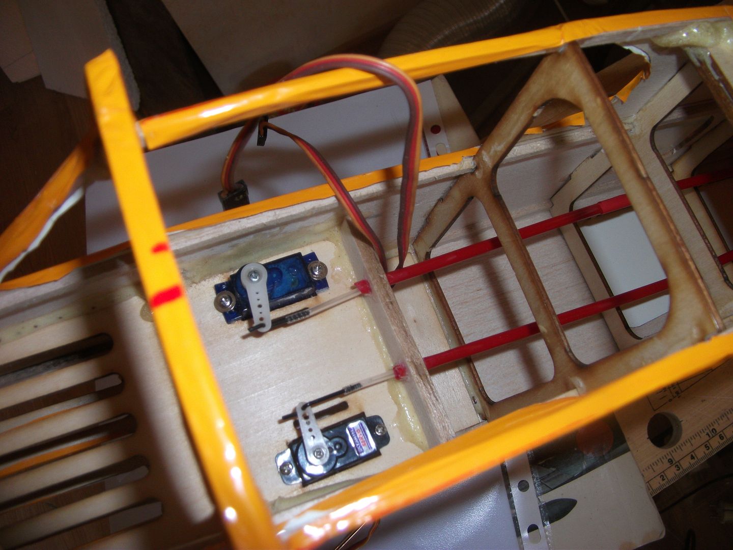

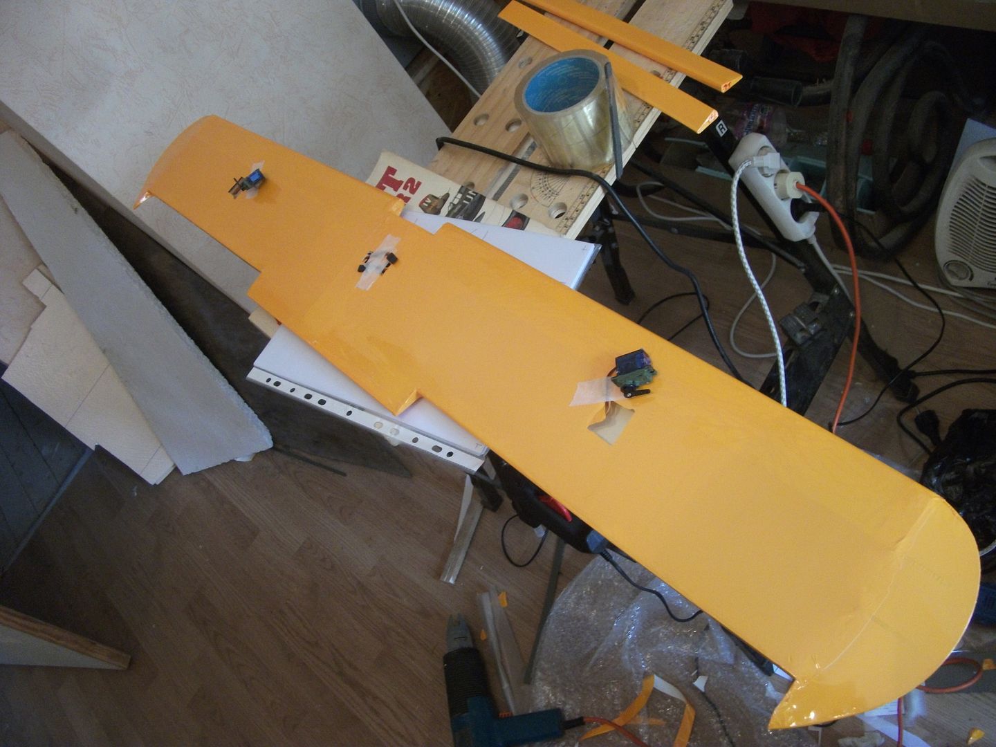

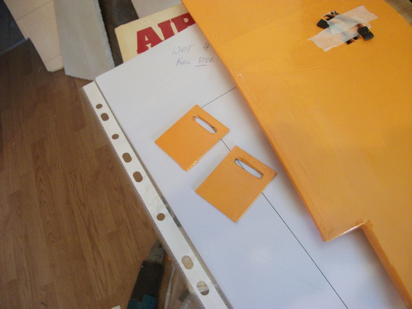

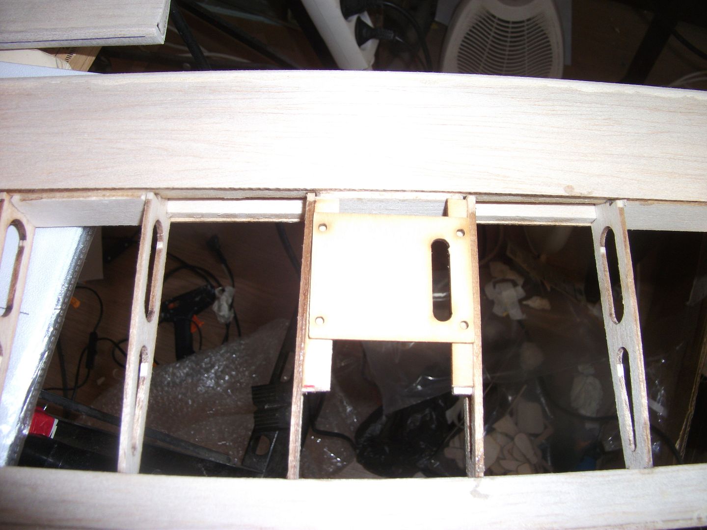

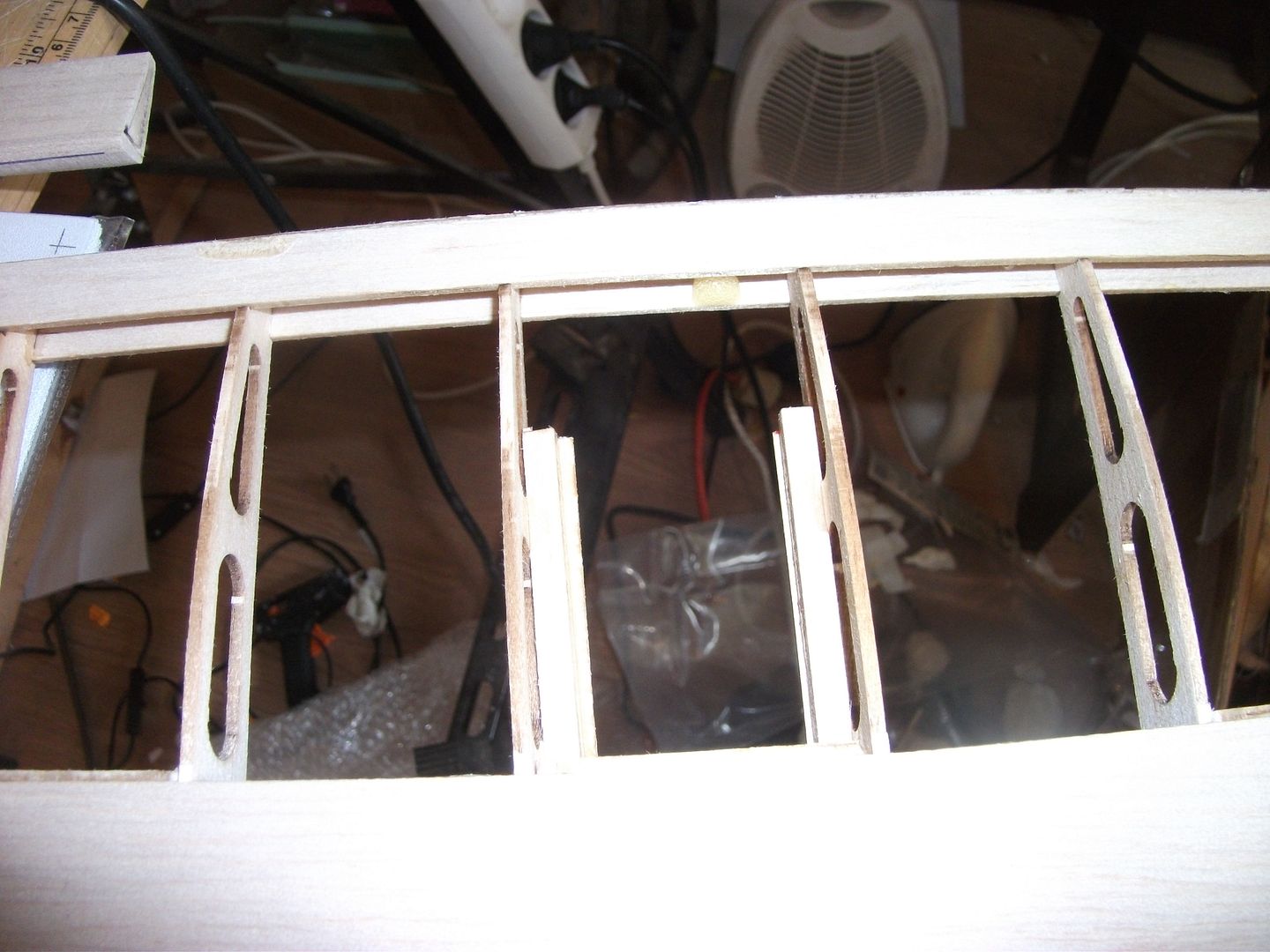

Rails fitted to carry servo plates .. scrap ply with scrap balsa under.
Check fit

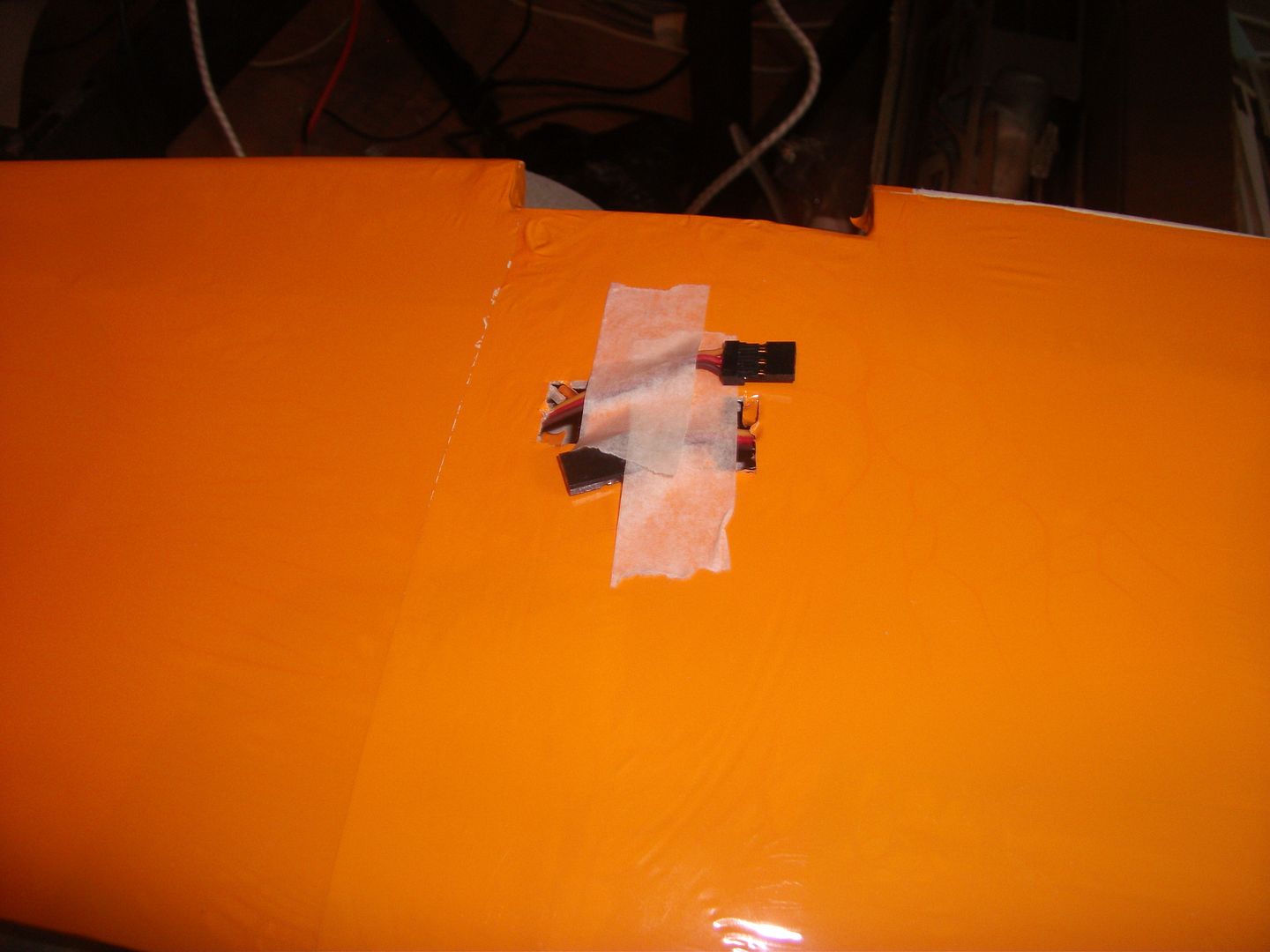

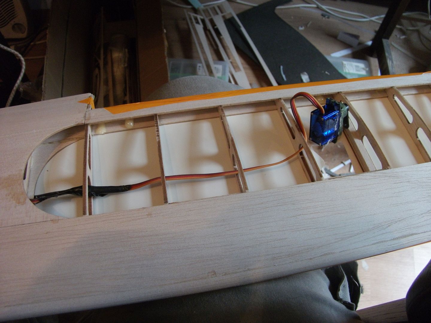

Now we are covering wing and we must remember to sort servo leads through ribs before final !

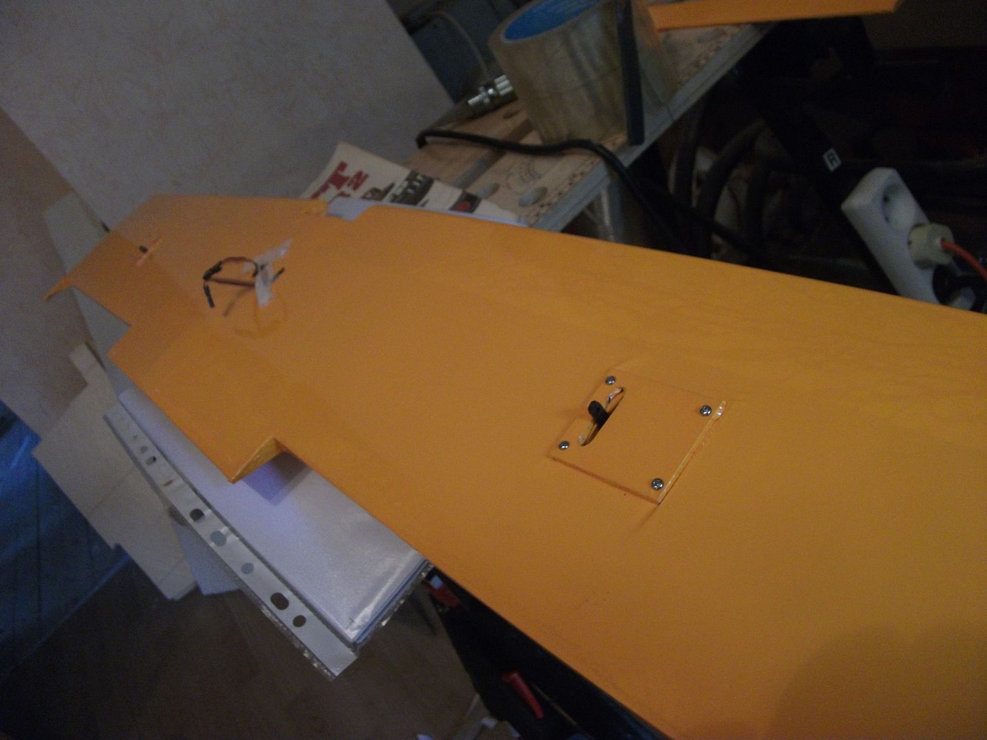

Standard 9gr jobs
View from top ... I chose to lengthen the leads instead of plugging ext's..

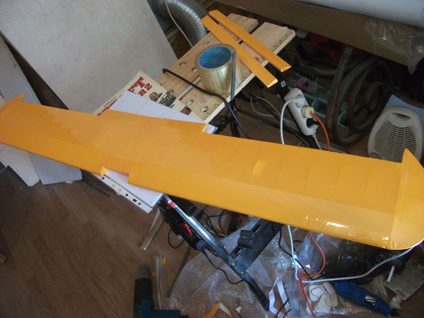

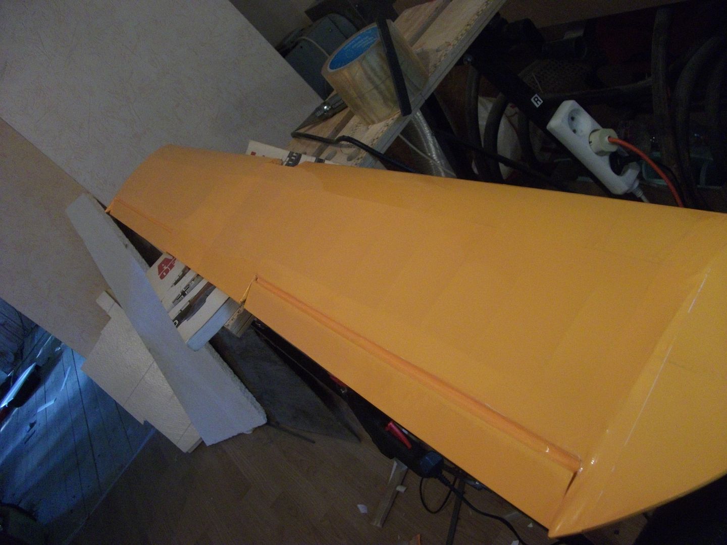

Top now covered as well ..
Servos ready for plate fitting
Servos fitted (servo taped to plates) ..
Ailerons hinged with my preferred mylar strip and then covering film closes the gap top and bottom ..
Check fit and time to see model coming alive ... (still to sort control rods and internal servos etc. and those ******** windows !!
She has a little more dihedral than I would have designed in ... but at least this will make her a sweet flyer I hope. The real J3 is no aerobat - so this one will not be out of form.
Tomorrow I collect the vinyls to apply to her for cosmetics ...
Feeling quite pleased with results so far ...

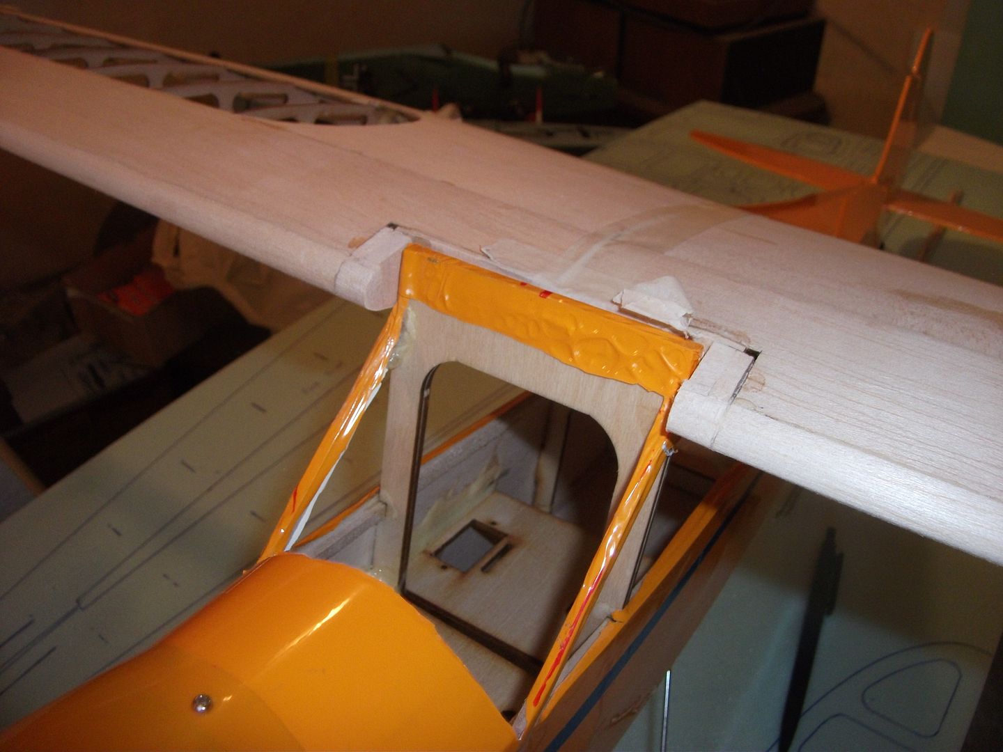

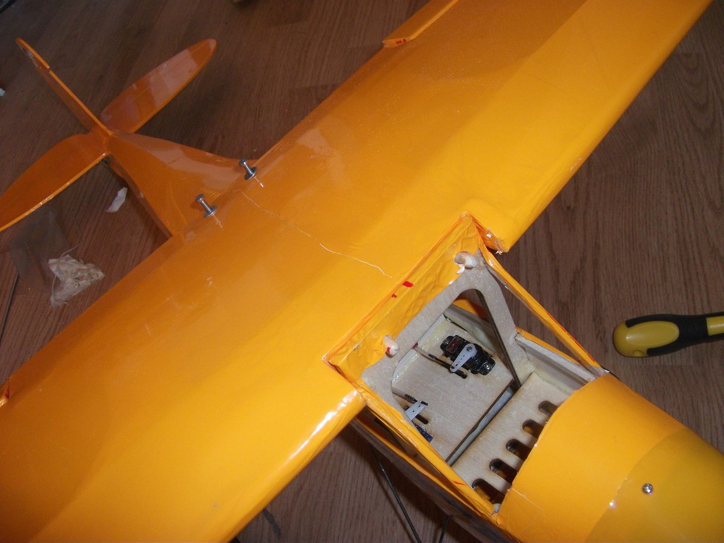

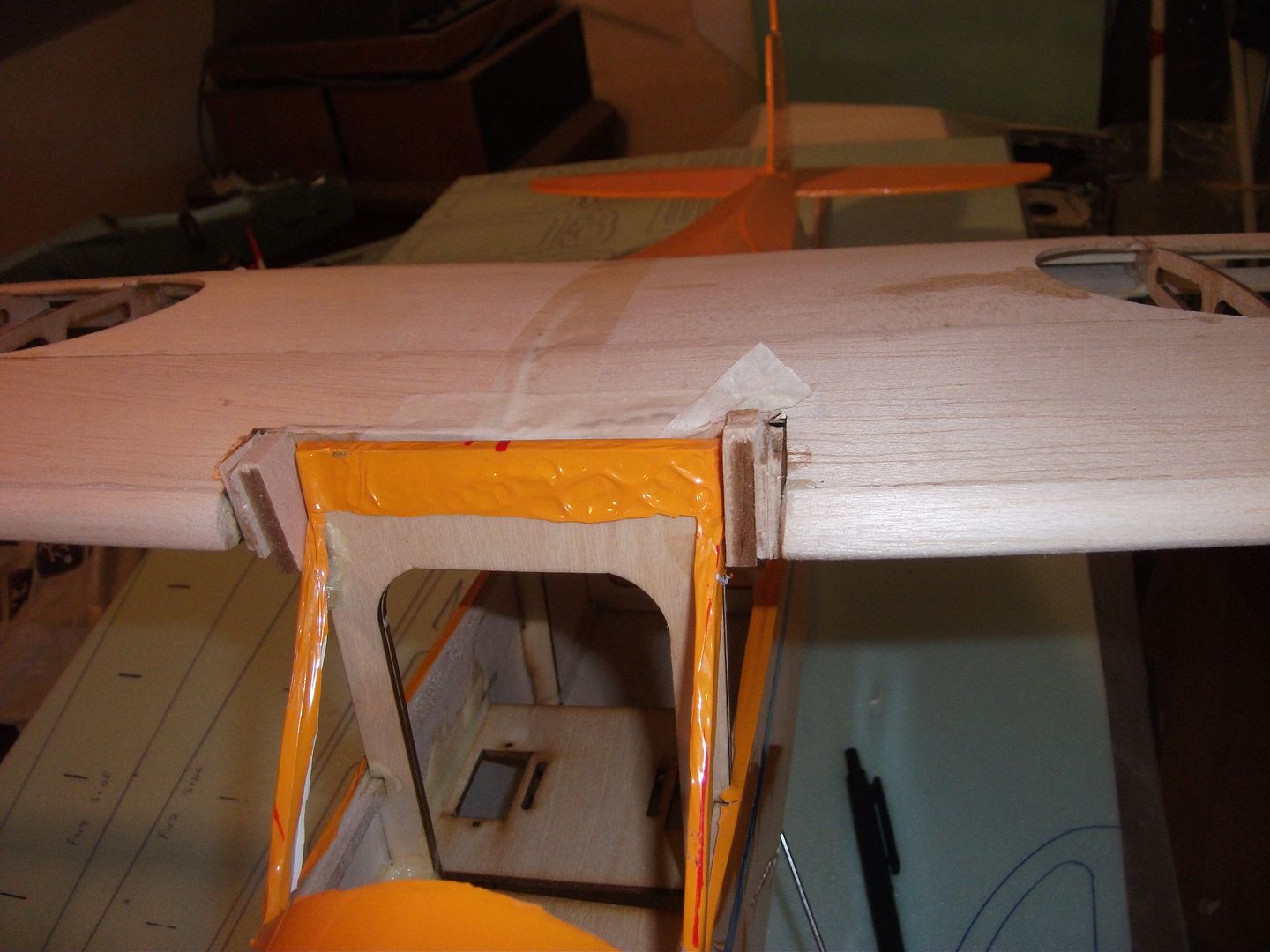

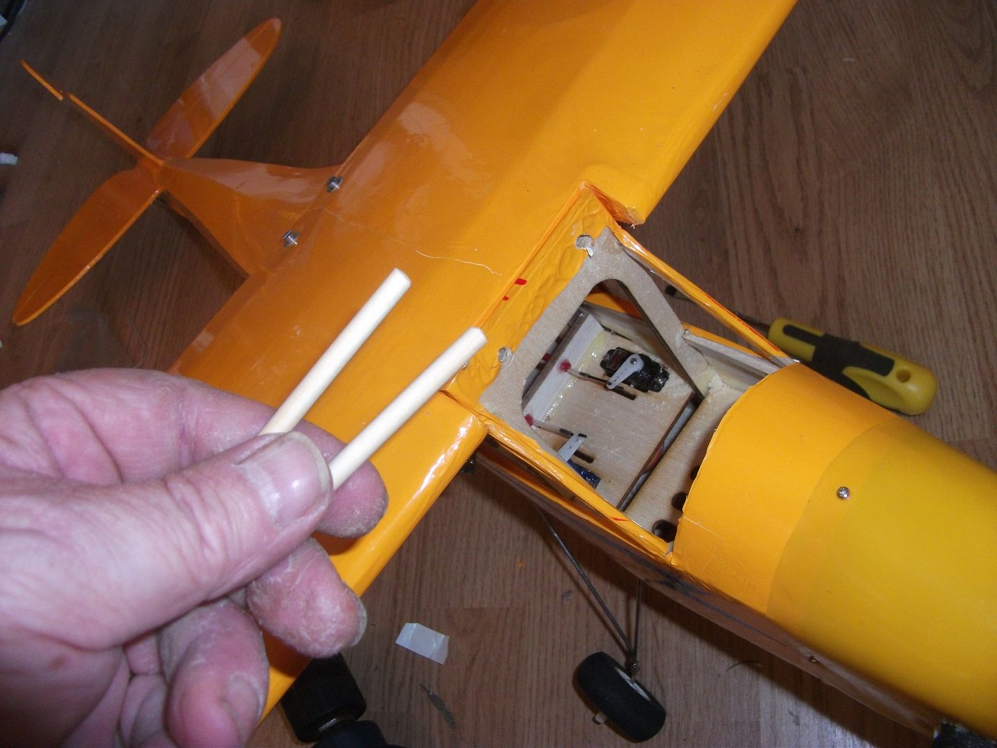

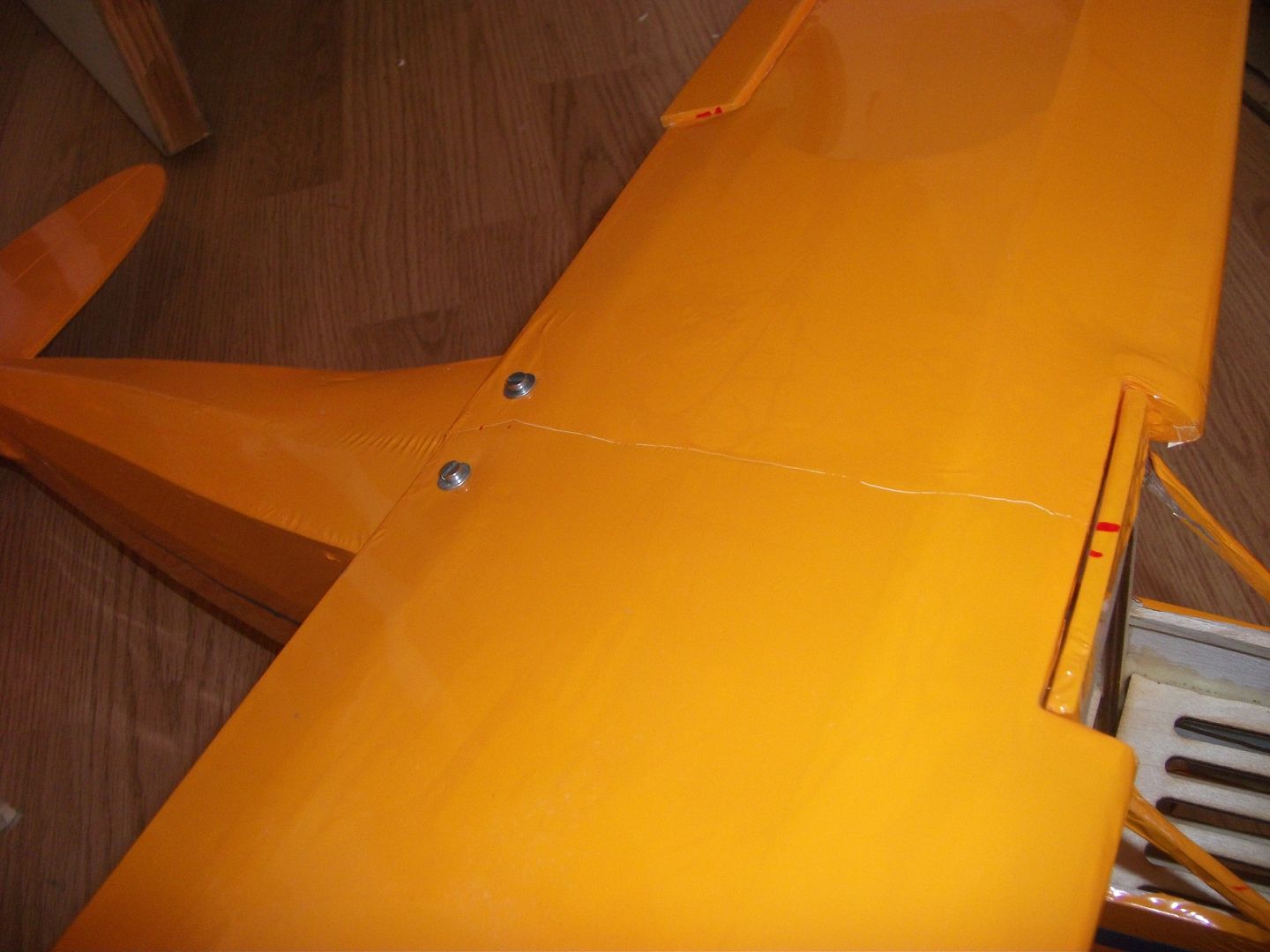

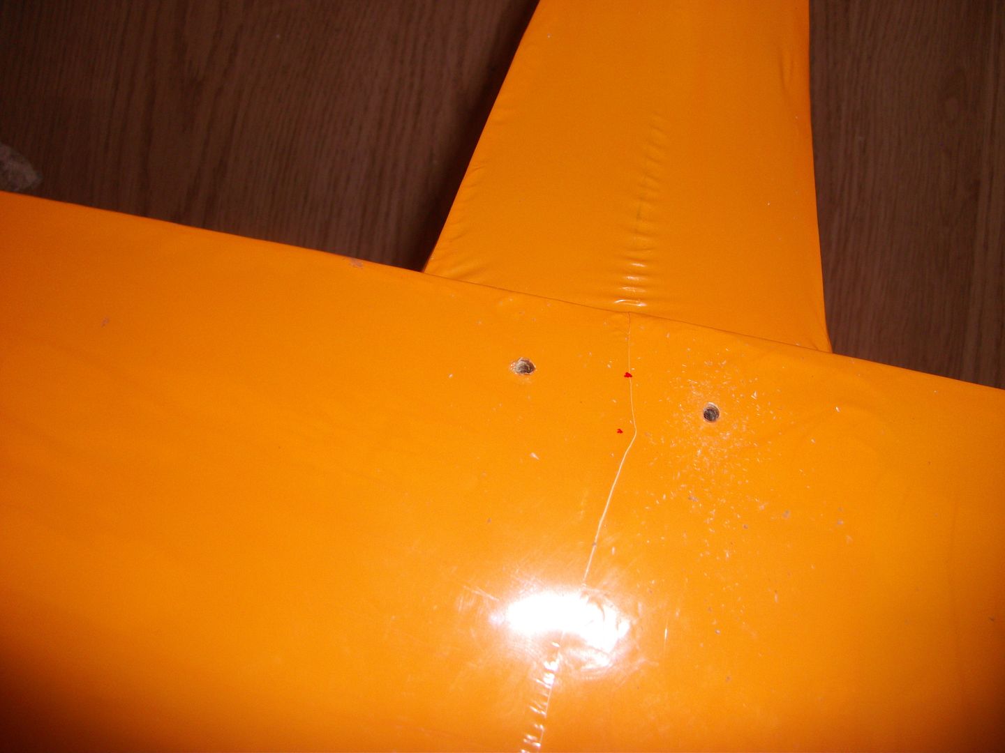

Wing fixing .... I have elected to have two bolts at rear and two pegs at front ...
I use metal captive nuts ... the metal bolts are purely used to pull the captive nuts into place ... in actual use - I use nylon bolts so they shear of before wing destroys !
Wings a snug secure fit ...

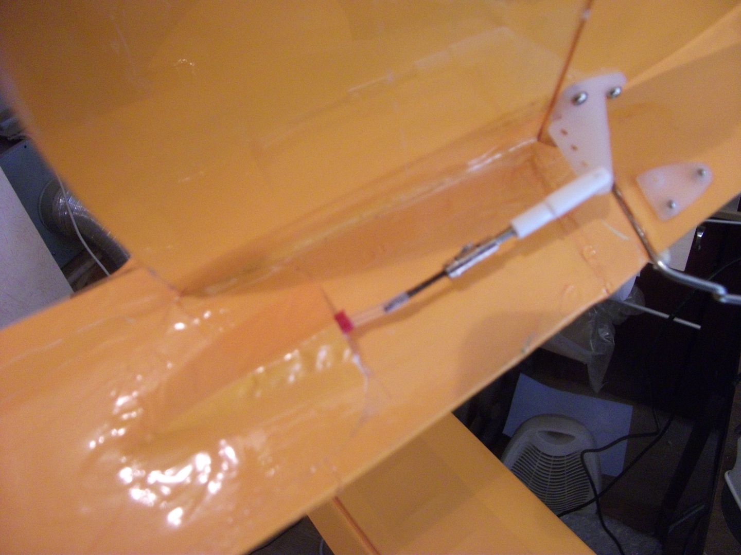

Onto radio gear .. servos.
I broke a push rod trying to negotiate the fuselage, so in the end changed to nyrod snakes ...
With covering fairing in the tail exits ... (bit rougher than I like - but will do for temp till I sort out later ...)
Wings with conventional rods ..

I left the window problem till last - it also allows me to get my hands in to install the gear ...
Still haven't figured out how I will fix the glazing yet.

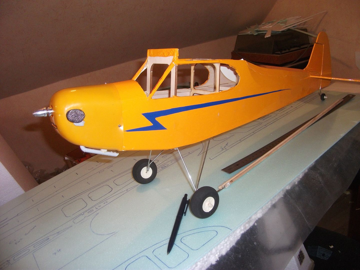

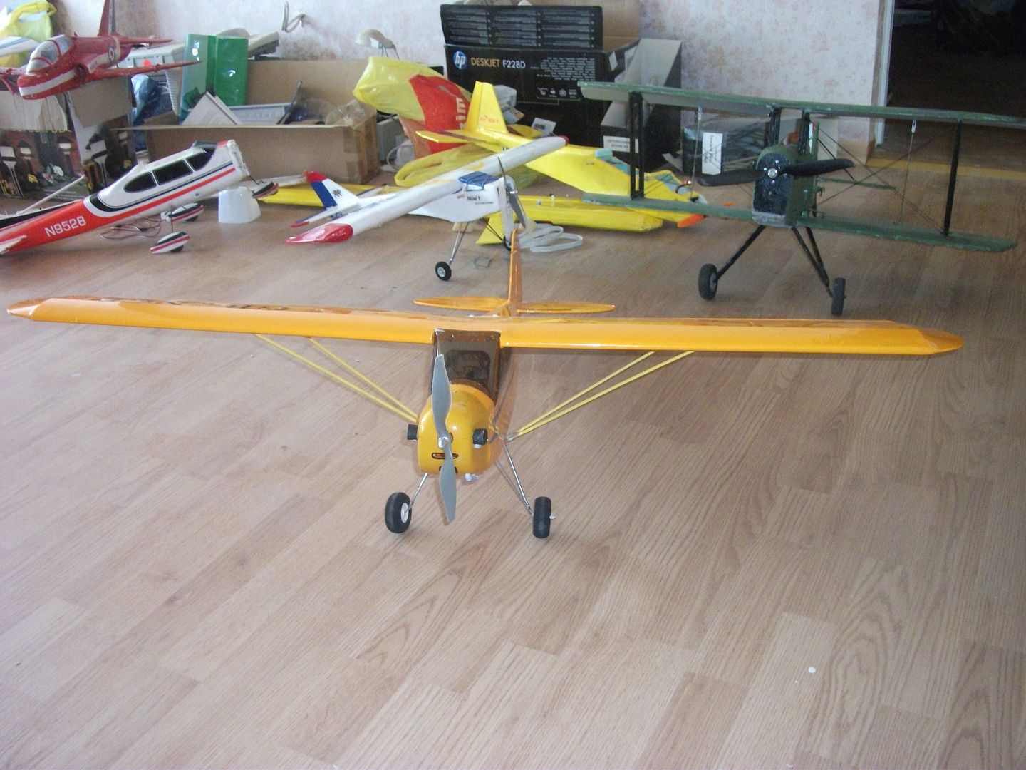

Here she is in temp RTG form while I wait for my wing struts and landing gear cross wire material .....
I used a temp fix for the windows at present while I figure it out !! Combination of contact glue and clear tape ...
Now have to find that perfect day to give her a maiden !

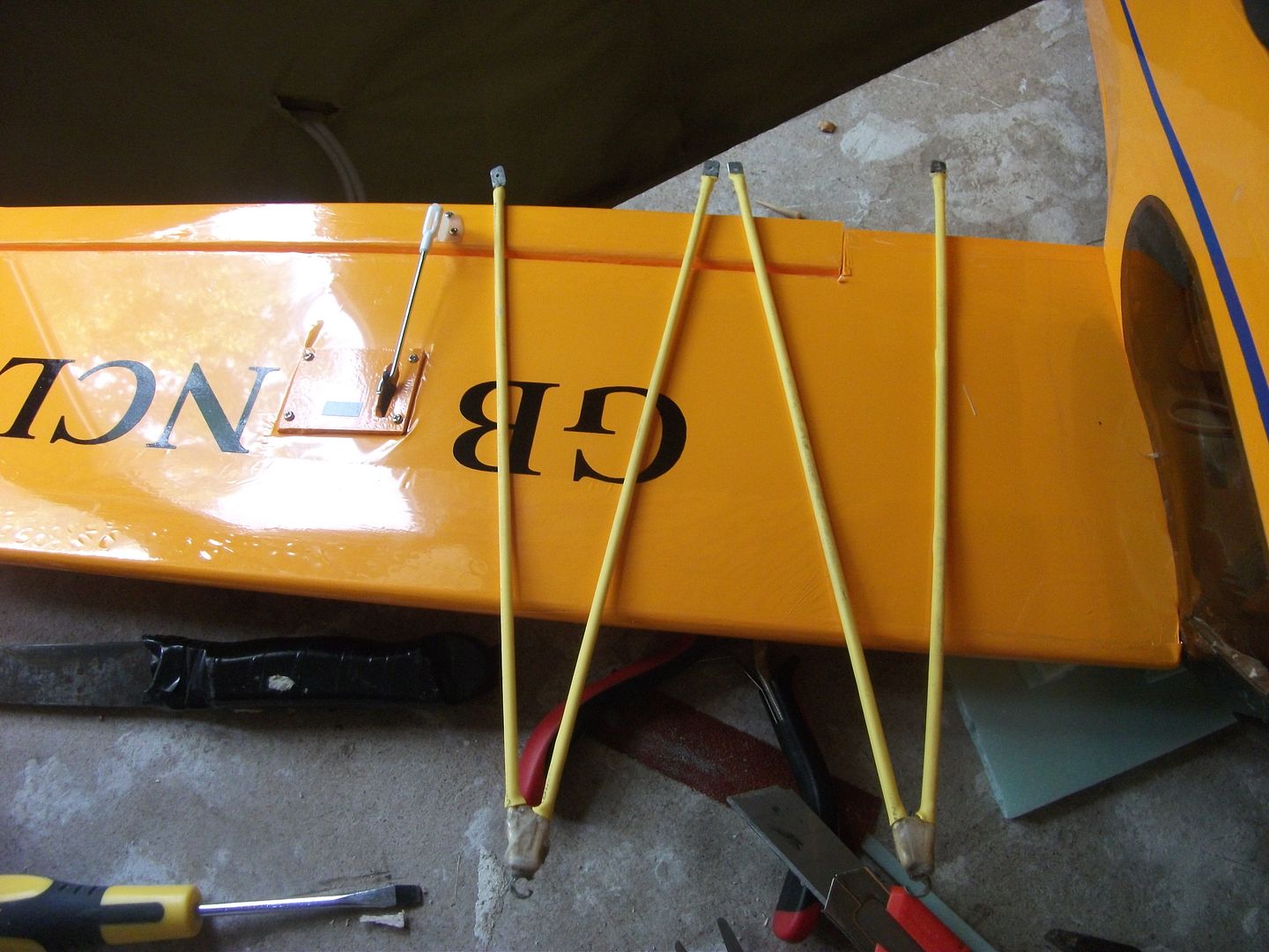

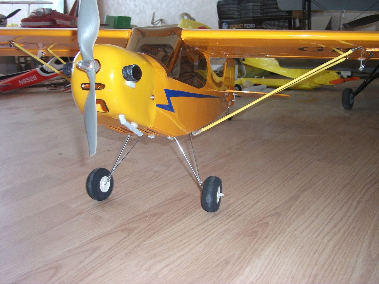

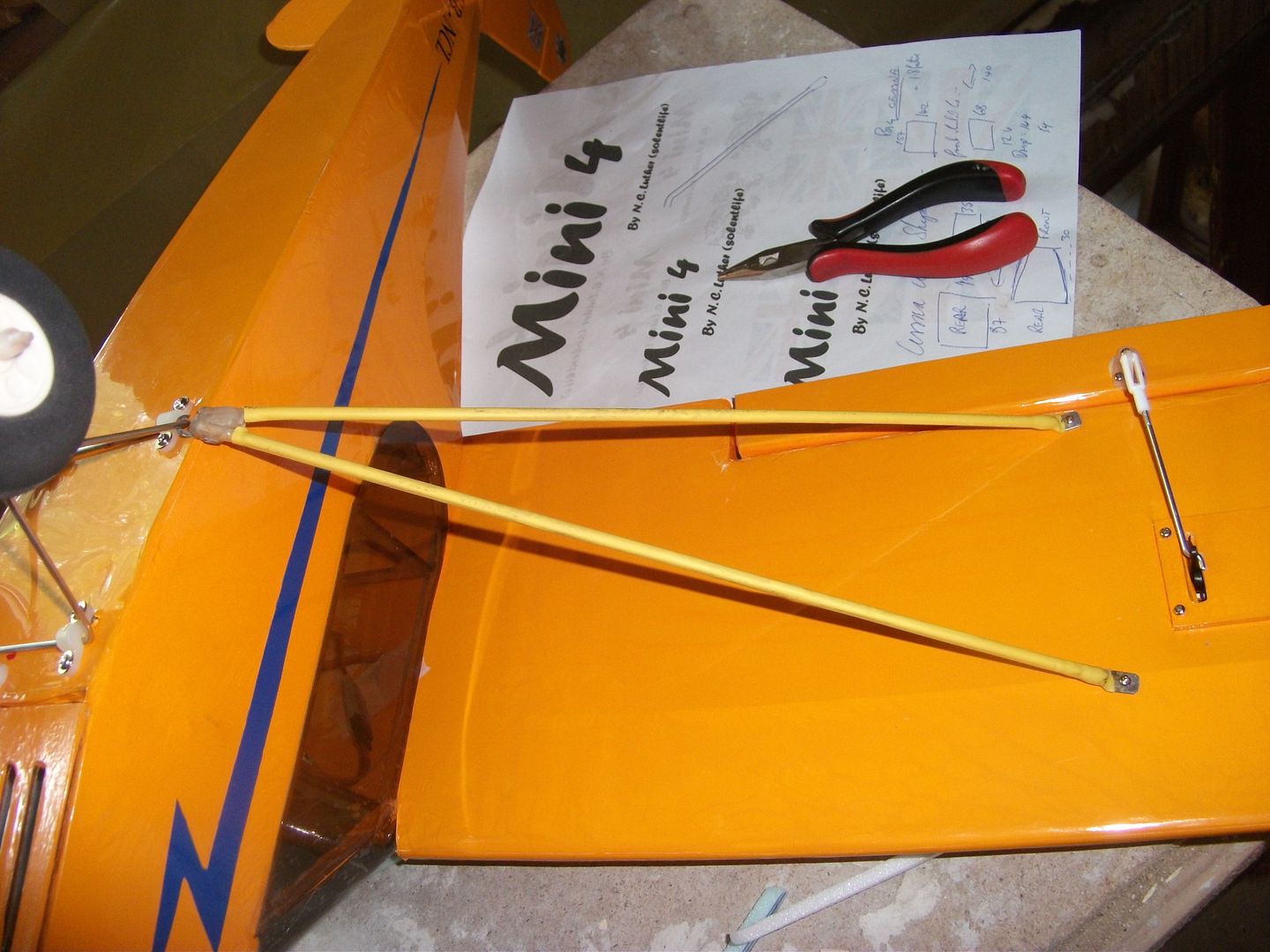

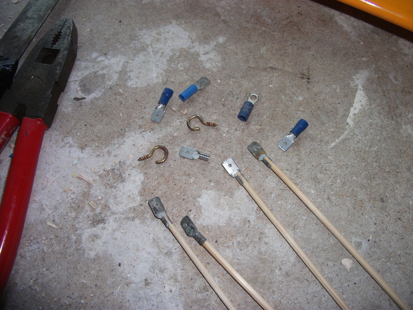

So fed up looking at the wing as is ... I decided to make my struts out of alternative material ...
BBQ skewers
Electrical connection crimps
Heat shrink
Crimp on terminals for screws to secure to wing spars.
Cut and CA small triangles at fuselage end... attach terminal hook, buind with thread, smear epoxy over all ends to harden up.
Heat shrink tube over skewers ..
Test fit ... then remove once screw holes made ... drop in CA to harden threads cut into spars ....

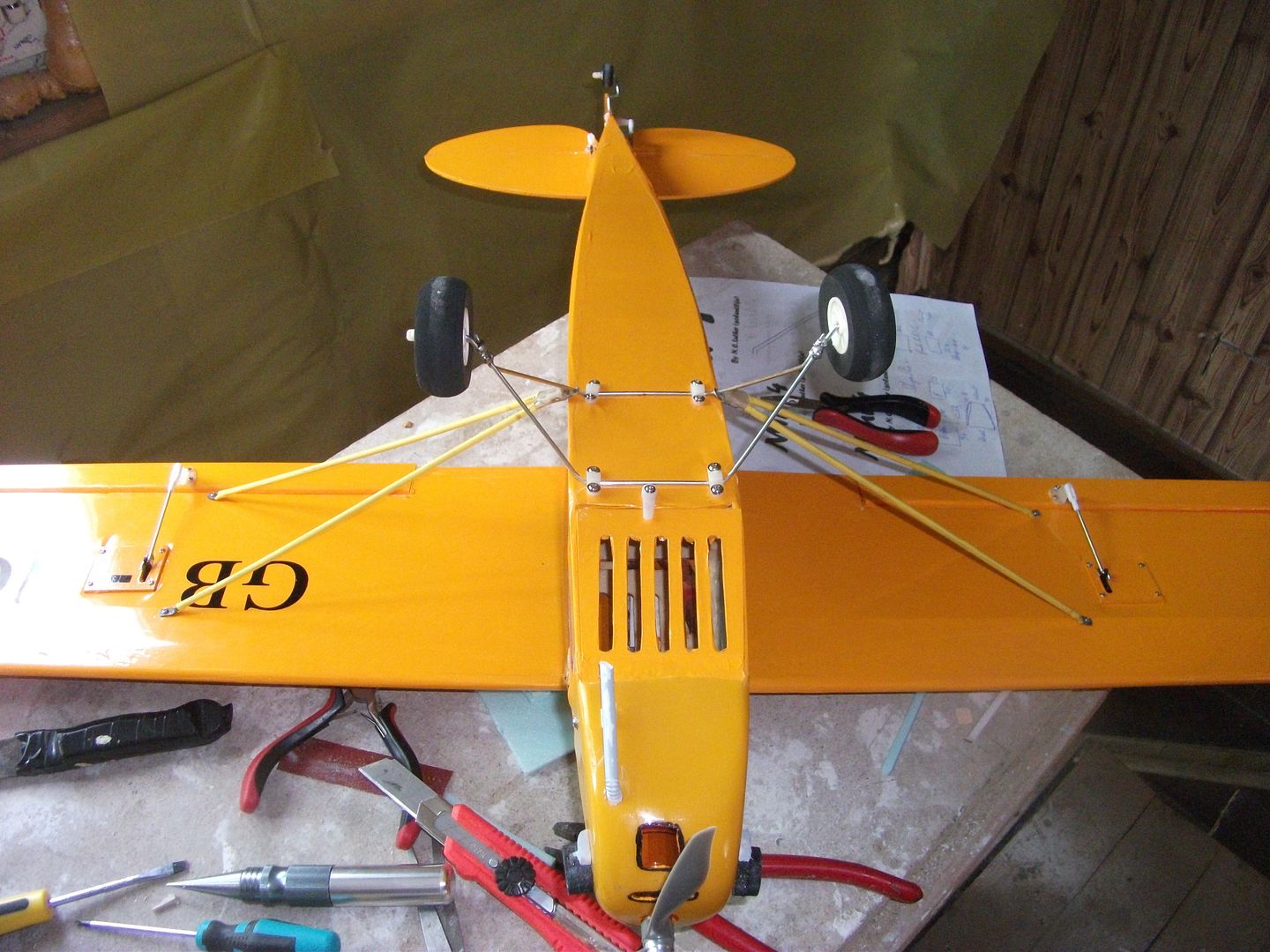

I am waiting for the trace wire to arrive so I can do the U/C cross wires. The 'bulges' on the wires ... needs thought.
Any suggestions ?
Local fishing shops do not have trace wire reels and crimps as I want ... and I also cannot get music wire ...

Geeze...that's harder than it looks. Was hoping you would tell me. Obviously you want to keep some flex in the gear legs. I think you would have to go for illusion, not function. I might wrap and glue a CF rod to each of the gear legs at the axle end. The top of each rod would ride in a slot or hole on the opposite fuselage underside, allowing it to move in and out of the fuselage as the legs flexed. Obviously, you can't actually tie them together where they cross. They would just rub against each other. The black bags covering the two bungees could simply be a couple of pieces of foam...or a couple of unused cigarette filters, slid over the rods, glued in place, and painted black. The real things are only roughly symmetrical - almost just black masses really. Then again, maybe the whole thing would turn out to be too delicate, and you will be right back where you are now!

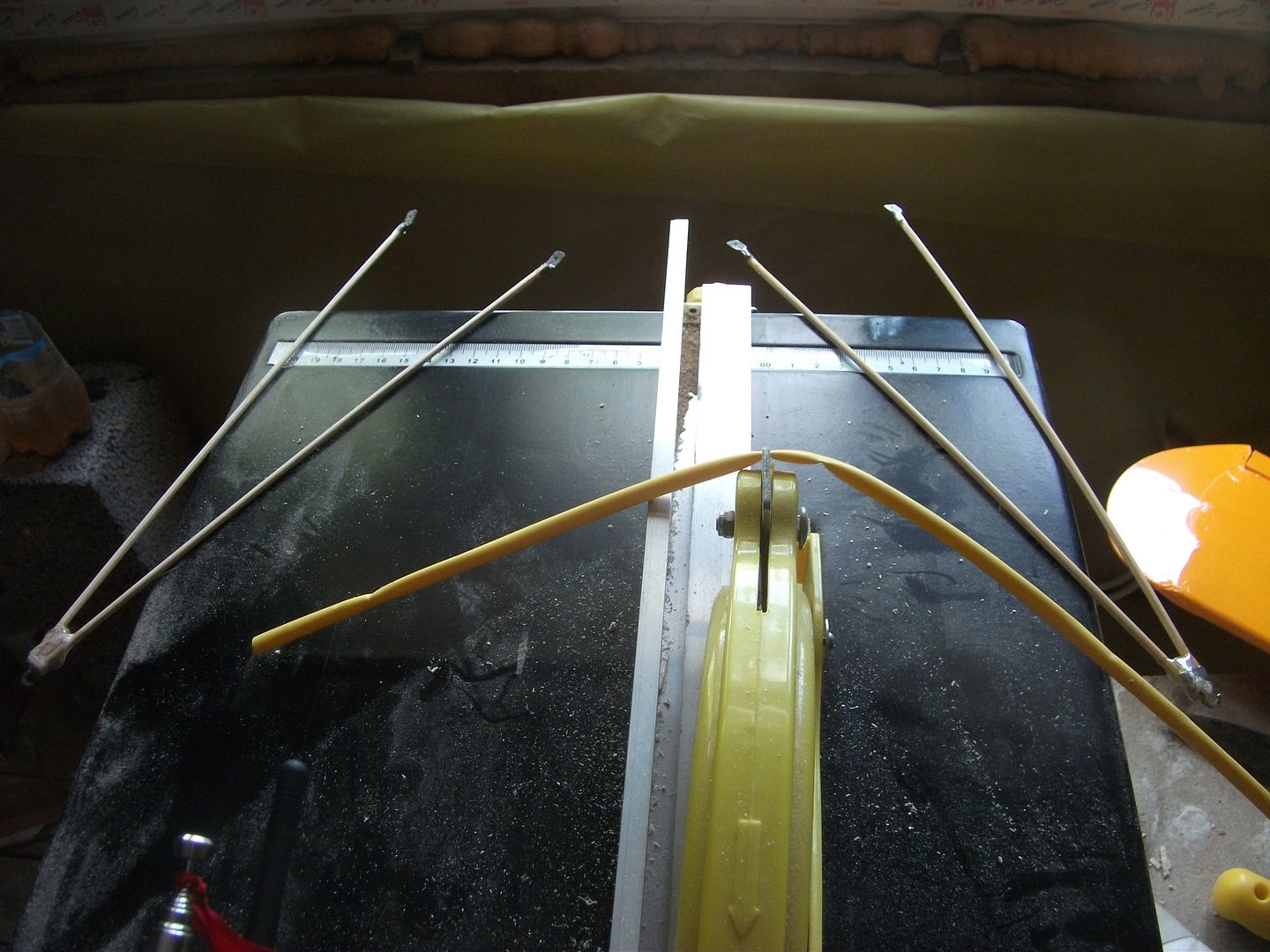

For the U/C cross pieces - I will use wire trace going from each rod joint near the wheels... across and up to post front leg. the bungee part is the one I haven't decided yet. I don't want it too bulky as drag is a killer. I thought about foam then black heat shrink over.... the heat shrink tightening the foam onto the wire trace. Another way would be thick short pieces of drinking straw fixed and then painted.
I am not a CF rod person and for this job really cannot see its needed. Wire trace is far more forgiving and easier to fit. The cross can be a 'squeeze' of tape across the two.
