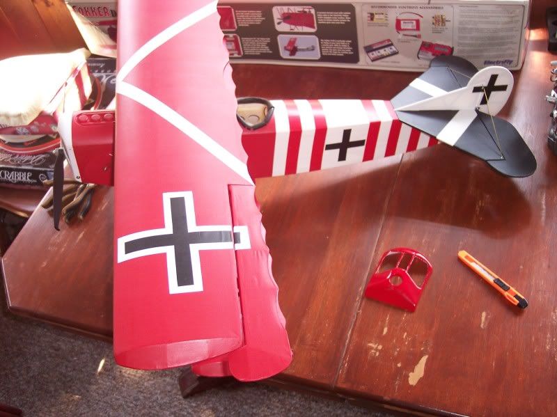

I'm home and I've surveyed the damage. The bottom wing isn't really bad at all, clean break in the center. The top wing on the other hand... The one side is just destroyed. I'm not sure how I'll get it back together. Looked at Tower Hobbies for a replacement, $35, kind of steep. I'll figure it out. Motor shaft is bent, glad I ordered some extras so they're already on hand.
The way the front is so destroyed really has me thinking about making it a D.VI.

Nothing pleasent about a post mortem. It looks like a total to me CJ. Hopefully you can glean something from her. Marty

This is just the chance you need to change the paint scheme. Take the covering off the crashed wing. Piece the broken ribs together to make a pattern. Get out the balsa, knife and start cutting new ribs. Make new leading and trailing edges to fit what you can salvage of the wings. Where the new leading edge meets the old cut a groove length wise in both ends. Glue a piece in the groove to hold both pieces together. I try to make the joint between ribs and cut the back of the leading edges off between the ribs to make the groove. Then the piece I add runs unbroken from rib to rib.

I've started removing covering, lots of broken stuff in the wings. The problem with making a rib pattern is that in the top wing each rib is different. I'll figure something out though.

I scratch built a DVII about 1970 and made the ribs by making a plywood root rib and tip rib. Stacked balsa sheet wood for each rib between the plywood ribs with the slot for the spar lined up. Sanded all the balsa to match the angle between the plywood ribs. Maybe you can do the samething. Easy way to make ribs for tapered wing.

Well, I've got the wings back together. Almost all the ribs were broken in some way, but the monokote held it together so I still had most of the pieces which was nice.
Next to be repaired is the fuse. I'm not terribly worried about it, except for the thrust angle for the motor mount. Any ideas on how to get that right? Not nearly enought left of the front end to reconstruct the angle from the factory.
I'm running a Hobby King Turnigy 28-30 motor and the prop shaft that bolts on the frint of it is bent, anyone know if you can just buy this to replace it? I bought spare motor shafts, but that isn't what is bent unfortunately.
