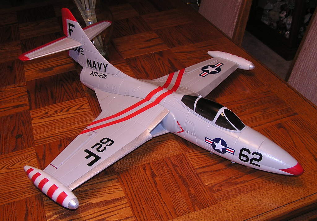

A search on this forum for the Hobby Lobby F9F did not show any recent posts. This airplane was available in about 2009 and many people who bought them at that time were burning up the motors. I decided to buy one now and see if that problem still exists.
I only had to supply a receiver and transmitter. Everything else is included in the box. Assembly involved epoxying on the wings, nose and tail, attaching the control horns and installing the aileron pushrods. Everything else was done at the factory. I did find a bow in the canopy assembly. It prevented the hold-down magnets from snapping together. Rather than try to straighten the canopy I just sanded the mating surfaces on the fuselage to match the crooked canopy. The magnets snap together nicely now.
Unlike the midwest, it has been quite windy and cool here in the Pacific Northwest and I haven't had a chance to fly it yet. I did fully charge and discharge the battery to see if the motor overheating issue was resolved. I couldn't get a finger in to feel the motor temperature but a smell test revealed nothing that overheated.
I'll give an update after I get a chance to fly it.

Finally had a nice day yesterday and was able to do the maiden flight. Plane was stock including battery. This was my first time flying an EDF. Launch went fine. I grabbed it around the fuselage in front of the wings and gave it a toss with nearly full power. I was quite nervous but it climbed out fine. I gave it a few clicks of down trim to keep it from climbing too much. It probably could use a little down aileron mix with full power. Rolls were not quite axial but weren't too bad. I noticed when I entered a steep climb and let it slow down the elevator became ineffective. Even if I gave full down elevator it would flip over in a loop. Recovery was easy but I wasn't use to that. I set the timer for 4 min and landed at about 4.5 min. Batt voltage was about 11.23 so that seems about right. It landed quite fast, I'll probably increase the elevator throws to see if it will slow down more. Now I'm ready to follow the suggestions and order a larger battery to see if performance improves.
