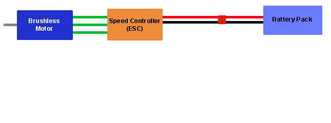

... When you meter a balance lead move BOTH meter leads along the pins not just one ... as the cells are the adjacent pins ...
'Multiple choice' instruction diagram for the measuring leads
(and looots of e-flight info, other tools)
www.scriptasylum.com
→ RC calculations
→ Electrical
→ LiPo pack wiring
And look for this drawing

Ron .... your point is ??
Forgive me for saying but but your post does not answer any question. It might be more helpful if instead of quoting sources - to actually put substance to a post ?
Your image of a 6S battery balance lead shows nothing of value ...
One of the great things about Ron's posts is he usually adds useful links for the O.P. to read and better educate themselves about the situation at hand. Once they are educated they can better understand and diagnose problems on their own. They're free to accept and implement the personal suggestions of other posters but Ron helps supplement those suggestions with published expert information.

Ron .... your point is ?? ...
One cell voltage is too high at 4.26volt.
The Ampeer link I provided is good LiPo reading material.
... Your image of a 6S battery balance lead shows nothing of value ...
I see how that could be confusing, the drawing being that big and all. It refers to the location of the multiple choice 'instruction tool' for measuring individual cells on that Sriptasylum page. Scriptasylum does not provide direct links to those tools, they are just listed.
'Multiple choice' system wiring diagram tool in LiPo-pack wiring page.
