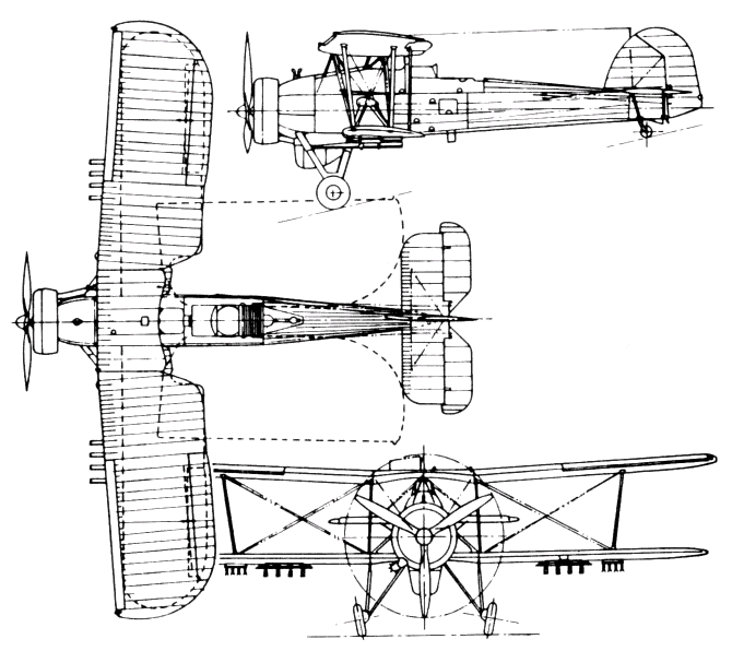

Did you over lap the glue joints or glue the edges together?
I think the TM would bash nice into a Fairey Swordfish. But then that is a WW2 airplane and might not keep the shakes away. LOL
Yep, I overlapped all the joints. Held it together with clothes pins.
I agree, the TM is a great fuse to start with for bashing. I keep thinking I want to do something wild with one. Seal up the forward cockpit, and change the nose a bit, and you've got some cool looking Golden Age planes, or possibly even something more modern. It's harder to really go back in time to WWI with them though, they are sort of on the sleek side. Perhaps you could shorten the fuse to give it a more "thick" look like some of the WWI planes.
http://www.aviastar.org/pictures/eng..._swordfish.gif
