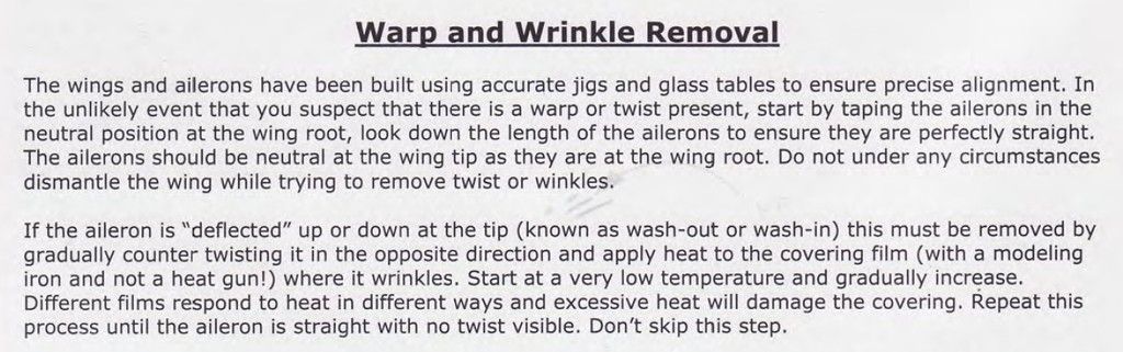

I know this is an old thread but I'm hoping some of the original participants are still monitoring it.
I just finished the build on my Addiction X and noticed the very same "oddity" With the ailerons when trying to trim them. Both are dead flat but when trimmed level to the wing tips, they are both noticeably high at the wing root. Conversely, if I level them at the root, both are low at the tips. PA is on a month long break so no help from support. Searched the topic quite a bit and found this thread.
I read 2 differences of opinions in this thread as to what to do. I believe the OP got advice from PA to level at the tips but I believe someone else noted that it would be better perhaps to have the ailerons lower at the tips.
I just find this strange that this thread is several years old and more than a few people have noted this yet it's not mentioned anywhere in the manual as to the best method to trim these. Any thoughts would be appreciated

I tried levelling mine at the roots and at the tips and she flies well in either case. I now have mine in a mid position and am happy with the way she flies. The Addiction x is a brilliant model. It's a great model to practice all your manoeuvres on as it flies quite slow and is very forgiving if you get it wrong. I taught myself to do slow rolling harriers without too much trouble. If you set yours up with large throws on the controls you will probably suffer with control shake at neutral on the ground but it doesn't happen in flight. Happy Flying.

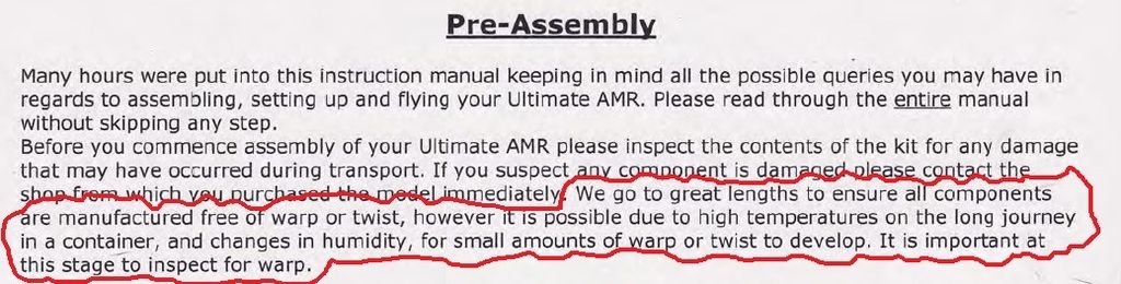

As i probably said earlier in the thread.. This must indicate that either the ailerons or the wings have a warp in them. This is not a deliberate 'design feature'. I dont have the addiction but i do have the PA Ultimate AMR and one of it's wings was similarly warped, plus the fuselage bad a bad twist in it too. The wings are pretty easy to untwist, the fuselage took more work but i got there in the end.
As Squidger said, with it being a slow flying plane it will probably fly 'ok' even with twists in the wings/ailerons, but personally i couldn't accept that sort of imperfection. Even if it has no immediately obvious effect on flight it would annoy the heck out of me!
To be fair to PA they highlight the risk of warps in their lightweight surfaces at various places in the manual. They detail how to check for and correct for warps of the exact type you are seeing, they specifically state that the ailerons should be correctly aligned at both root and at the tip and they detail how to correct it if it's not. Here are the extracts from my Ultimate AMR manual, I assume the Addiction has the same wording:
and
Only thing i'd add to this is it's not so 'unlikely', it's almost a certainty!

I have an Addiction X and had the same problem. Either your wings or fuselage are warped. Real easy to fix with a Heat Gun and a good eye.
Really does not matter much how you align the ailerons. Depends on what you want out of it. Do you want it to Float or Less Float. The Addiction X is made to do Post Stall maneuvers at 0 to very little airspeed. Will not do well with extreme maneuvers like Tumbles.
